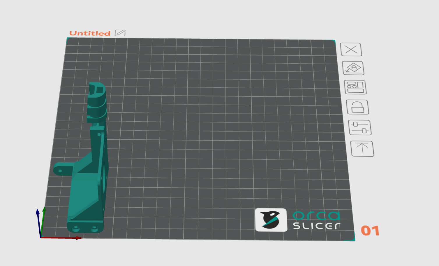

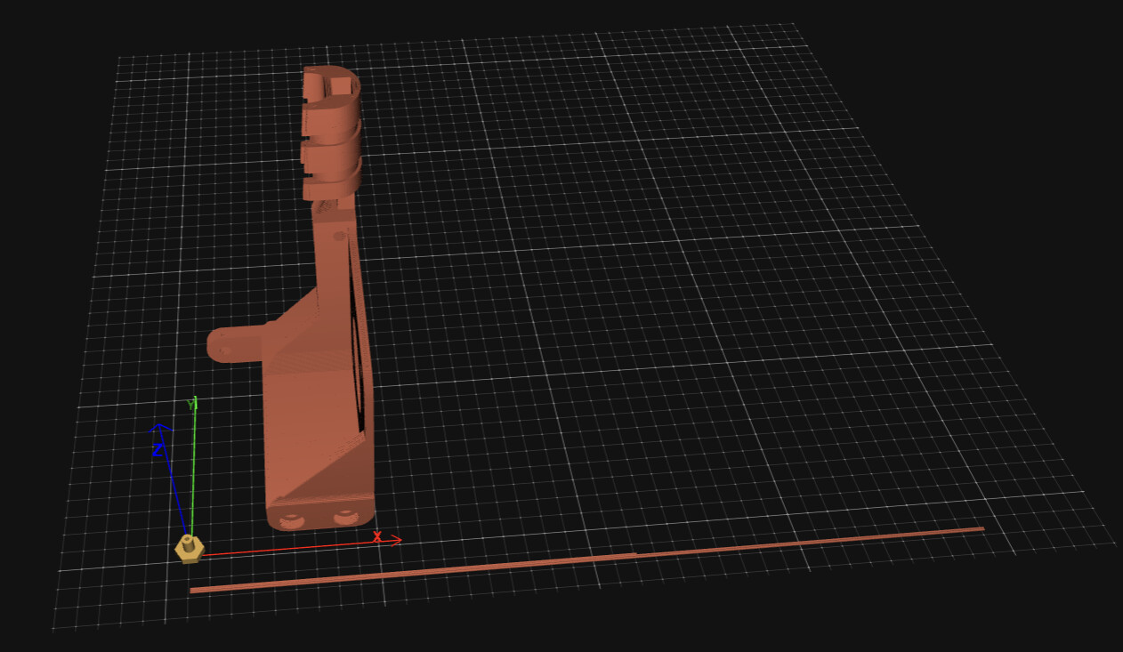

### I’m trying to fix my X&Y offset, just installed Klipper yesterday and got it working on my Anet A6 can print but everything is shifted I suspect because of my X&Y offset which X=-31 and Y=-17. I have my x\_stepper and y\_stepper set like this. Build plate is 220x220 but it’s going to 0,0 to print which is not my “home corner” if you will.

In OrcaSlicer, I changed the printable area to -31,-17 and that shifted the build plate, but still wouldn’t allow me to use the full space in OrcaSlicer. I also adjusted the X offset and Y offset in Extruder settings, but that didn’t seem to change anything either. I’ve searched around, and maybe I don’t know the right terminology, so sorry if this is a repeat question, but I couldn’t find what I needed.

Where have you set the origin on the slicer: Corner or centre?
**Author:** ![DDub](https://avatars.discourse-cdn.com/v4/letter/d/ce73a5/32.png) [@DDub](https://klipper.discourse.group/u/DDub)\
**Post date:** [November 3, 2025, 7:50pm UTC](https://klipper.discourse.group/t/anet-a6-x-y-offset/25146/5 "2025-11-03T19:50:45Z")
Unsure if this helps to share, but this is what I’m seeing, and I can’t seem to move the corner of the print area to the corner of my build plate.
 ![klipper](https://global.discourse-cdn.com/free1/uploads/klipper/original/3X/3/5/35ca3ad5c603274911ab10c156135a79bd274a49.jpeg)
 ![orca](https://global.discourse-cdn.com/free1/uploads/klipper/original/3X/6/7/671553bae4fa12faa9bc69fc4a8a8d40a69fa87a.png)

You may read here: [Understanding X and Y Axes Limits and Homing](https://klipper.discourse.group/t/understanding-x-and-y-axes-limits-and-homing/10779/1)

It seems to me that your issue is a slicer issue not a Klipper issue
