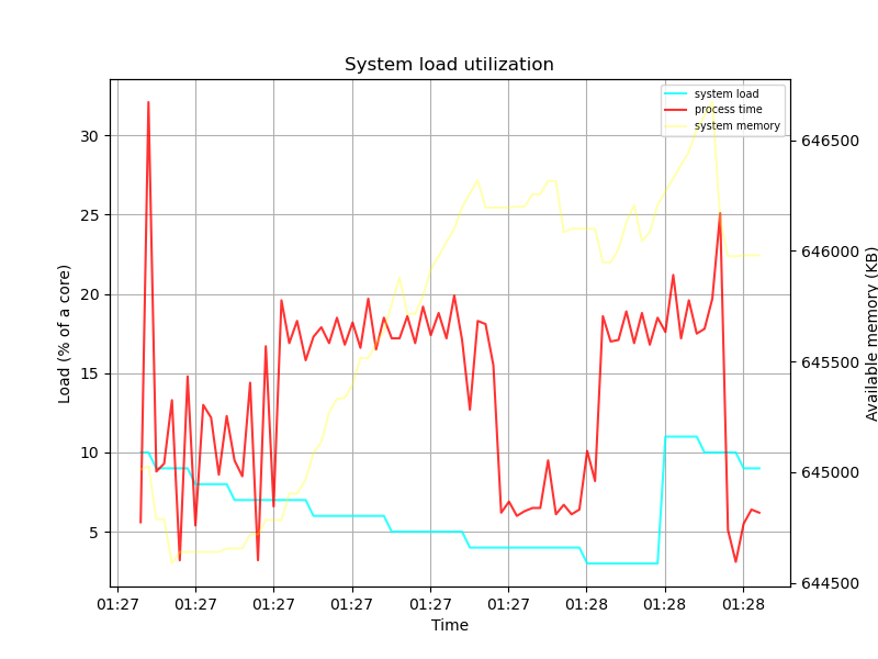

Finally, there is a spike in system load just a few seconds before the timeout is reported (without a spike in klipper processing load - which indicates it is external from klipper):
 ![sysload](https://global.discourse-cdn.com/free1/uploads/klipper/original/2X/6/6a343d94ba90dd8e7d48903ac398fdfd8b39358d.png)
(note the spike of the cyan line near the right side of the graph).
If you’ve got any kind of background processes (webcams, timelapse software, remote monitoring, etc.) then you may want to check if the problem persists with them disabled.

**Author:** ![emjay276](https://avatars.discourse-cdn.com/v4/letter/e/5f8ce5/32.png) [@emjay276](https://klipper.discourse.group/u/emjay276)\
**Post date:** [January 2, 2024, 10:24pm UTC](https://klipper.discourse.group/t/configurable-timeout/12032/12 "2024-01-02T22:24:24Z")
I also removed the webcam config from crowsnest, so the webcam should also no longer be active (I think).
Now the system load is less than 10% when the timeout occures.
I also found the docu for the graphs 😉
 ![loadgraph_s](https://global.discourse-cdn.com/free1/uploads/klipper/original/2X/5/51d9c7f5f6a5a9fb4fee0f995479498a86beebb1.png)
 ![loadgraph](https://global.discourse-cdn.com/free1/uploads/klipper/original/2X/c/ca47922dfec7b134ccefd755942c6de86780f3be.png)
[klippy.zip](https://klipper.discourse.group/uploads/short-url/9BKgBcgUoJAxo3gK4Pa71HaoBaf.zip) (637.0 KB)

The root cause of the error in your log appears to be a communication hiccup of at least 15ms in the USB system (either USB hardware, Linux kernel handling, or Klipper’s CANBUS bridge). Specifically, the main mcu attempted to send a message to the host and the Linux kernel doesn’t report receiving it until 15ms has elapsed. Specifically, this can be seen in the log (after processing with logextract.py):
`Receive: 86 850.286296 850.263383 14: seq: 1f(1102), trsync_state oid=13 can_trigger=1 trigger_reason=0 clock=1580327894(850.271477)`
The mcu sent the message at `850.271477` but it was not received at the host until `850.286296`.
It’s unclear what caused the issue at the (likely) USB level.
However, it’s not ideal that Klipper raised a communication timeout due to 15ms of latency. (The goal is to avoid 25ms of latency.) I think some scheduling improvements within Klipper could, in practice, reduce the chance of a timeout.
Could you try the code at [GitHub - KevinOConnor/klipper-dev at work-trsync-20240102](https://github.com/KevinOConnor/klipper-dev/tree/work-trsync-20240102) ? (Be sure to issue `sudo service klipper restart` after making the change.)

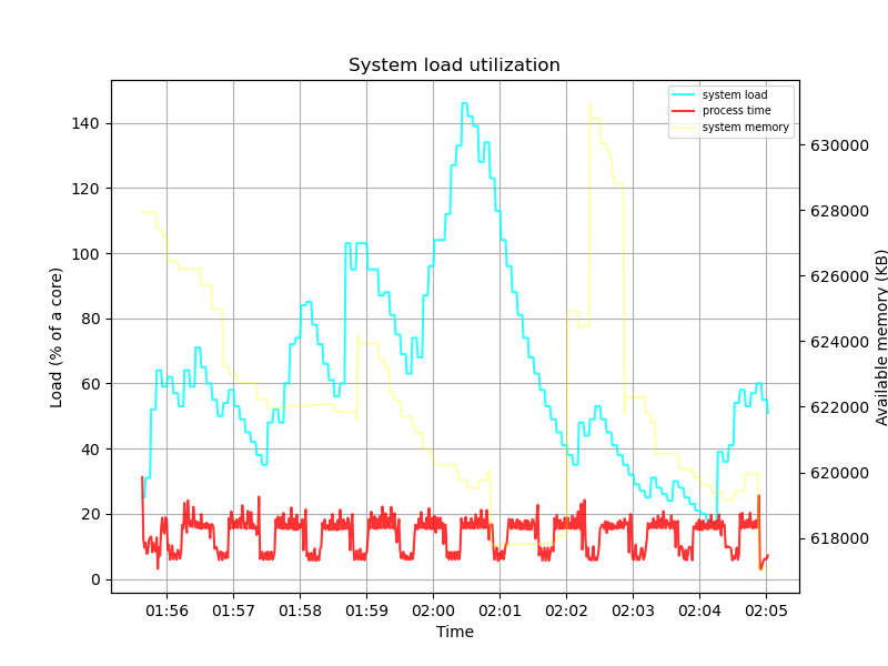

**Post date:** [January 3, 2024, 1:30pm UTC](https://klipper.discourse.group/t/configurable-timeout/12032/14 "2024-01-03T13:30:15Z")
I just tested [work-trsync-20240102](https://github.com/KevinOConnor/klipper-dev/tree/work-trsync-20240102) several times:
- 01: after `sudo service klipper restart`
- 02: after timeout at 01 and firmware restart ← took almost 10 min of homing to get the timeout, but I forgot to activate candump
- 03: after removing the klipper.service pinned to just 1 core of the CPU (full reboot of the system) `CPUAffinity=3` in `/etc/systemd/system/klipper.service`
- 04: after timeout at 03 and firmware restart
01:
 ![loadgraph_s](https://global.discourse-cdn.com/free1/uploads/klipper/original/2X/5/52a9e43c57f5856443977ee596b871d1d747a326.png)
02:
 ![loadgraph_s](https://global.discourse-cdn.com/free1/uploads/klipper/original/2X/e/eb6d0915fde82ae8911923cbe0ecd36cae68eaf2.png)
03:
 ![loadgraph_s](https://global.discourse-cdn.com/free1/uploads/klipper/original/2X/5/52495c31e9f7298e98015b14b7abec0ac435c34f.png)
04:
 ![loadgraph_s](https://global.discourse-cdn.com/free1/uploads/klipper/original/2X/5/5fdcca65aae08c08e695ab39d478fdaab6b80166.png)
[klipper\_dev.zip](https://klipper.discourse.group/uploads/short-url/siQonaXFsMI4WA0TUy4U3RHorLM.zip) (1.1 MB)
**Post date:** [January 3, 2024, 2:10pm UTC](https://klipper.discourse.group/t/configurable-timeout/12032/15 "2024-01-03T14:10:55Z")
- 05: I was just able to home for 25min without candump and without a timeout.
- 06: Enabling the webcam again I got a timeout.
05:
 ![loadgraph_s](https://global.discourse-cdn.com/free1/uploads/klipper/original/2X/5/56f0f9b6a3e107464737949b6f1bd35391593210.png)
06:
 ![loadgraph_s](https://global.discourse-cdn.com/free1/uploads/klipper/original/2X/0/04dec6f89c1854cba72f65af4db95ed3e1fd6e71.png)
[klipper\_logs\_05-06.zip](https://klipper.discourse.group/uploads/short-url/cB3bY9f3Ctp3lzCpZgoFyhr59RY.zip) (465.3 KB)
