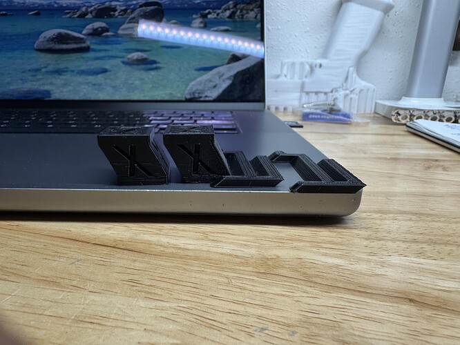

First time on Klipper, and just installed a Klackender setup. It was printing really well on stock Marlin, but decided it was time for an ABL.
Only adjusted the X axis belt tensioner, and the bolt underneath to mount the Klackender dock. Both are now tight, belt has been tensioned several times.
I’ve slowed down speeds as slow as 25mm/s, set velocity limit to 100mm/s and accel down to 1000mm/s to no avail.
20mm calibration cube is shifting to the **left**. I noticed it starts at the bottom of the letters, where the hot end moves (looking top-down) from the bottom right to the top left between layers.
thin-pegboard-hook is shifting to the **right**. It starts shifting as soon as the layers start to stack, on this one, the hot end moves (looking top-down) from the bottom right to the top left.
 ![9kdfcdstwkvf1](https://global.discourse-cdn.com/free1/uploads/klipper/original/3X/1/8/188c1961d9ed1b2a8ec0d043668ebdbe509496ad.jpeg)
All pulleys _feel_ fine, all belts seem tensioned. I’m so lost, what did I do wrong?

Swapped X/Y stepper and endpoint plugs on the motherboard and the shifting has now come towards the _front_. Does this seem like it would be indicative that this is a board issue?

Good thinking.
> [@rawfuls](#):
Not necessarily. Could be a driver defect or a stepper motor fault I would do above with the x/y stepper motors and post the result.
Please post bigger and closer photos of your prints!

Sadly it looks like it was the board. Swapped to a 4.2.7 board and it printed perfectly right off the bat.
