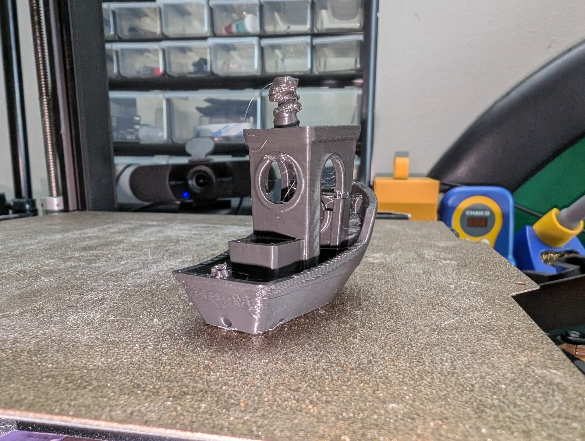

Printer Model: cr6-se
 MCU / Printerboard:stm32f103xe/
 Host / SBC:RPi4
[klippy.log](https://klipper.discourse.group/uploads/short-url/afqNzPEti92cGfpGnQaCBYL7Wvr.log) (7.5 MB)
I have done all the calibration steps for orca slicers and all klipper calibration checks but i am still experiencing issues with my print quality. it seems to be a coin toss and my benchy is worse than before the conversion to klipper so i’m nearly certain it isn’t cooling. I have a Direct Drive mod on and have calibrated my retraction as well.
 ![PXL_20250104_173721611.RAW-01.COVER](https://global.discourse-cdn.com/free1/uploads/klipper/original/3X/a/4/a44bd32e5ba3a3ac937a0a6aefd6669a3ceaeaed.jpeg)
 ![PXL_20250104_173701745.RAW-01.COVER](https://global.discourse-cdn.com/free1/uploads/klipper/original/3X/d/5/d5d27bdae7dc21a1eadae7804632ddac7426cf2e.jpeg)
 ![PXL_20250104_173654193.RAW-01.COVER](https://global.discourse-cdn.com/free1/uploads/klipper/original/3X/c/0/c06c3b6891778754270512081c5d7facd12c72a7.jpeg)
**Author:** ![3dcoded](https://yyz2.discourse-cdn.com/free1/user_avatar/klipper.discourse.group/3dcoded/32/20297_2.png) [@3dcoded](https://klipper.discourse.group/u/3dcoded)\
**Post date:** [January 4, 2025, 7:10pm UTC](https://klipper.discourse.group/t/cr6-se-orcaslicer-post-calibration-print-issue-under-extrustion-benchy-smoke-stack-haul/21132/2 "2025-01-04T19:10:32Z")
> [@3dthesenuts](#):
The benchy looks like it has cooling issues, particularly on the bow and smokestack.
Are you sure you’re not printing faster with Klipper than you were with Marlin?
**Author:** ![3dthesenuts](https://avatars.discourse-cdn.com/v4/letter/3/ed655f/32.png) [@3dthesenuts](https://klipper.discourse.group/u/3dthesenuts)\
**Post date:** [January 4, 2025, 7:36pm UTC](https://klipper.discourse.group/t/cr6-se-orcaslicer-post-calibration-print-issue-under-extrustion-benchy-smoke-stack-haul/21132/3 "2025-01-04T19:36:01Z")
I will do some more extensive cooling/print temps and report back
**Post date:** [January 5, 2025, 11:28am UTC](https://klipper.discourse.group/t/cr6-se-orcaslicer-post-calibration-print-issue-under-extrustion-benchy-smoke-stack-haul/21132/4 "2025-01-05T11:28:44Z")
Cooling issue, layer time too small and potentially too hot and over-extruded.
