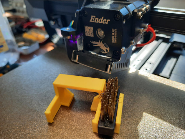

Hi Guys,
I’m trying to do this mod:
Took some time to find a way and place to mount a usable wipe brush, as no existing designs fit this S1 Pro,
Especially with the cable protector mod as this limits your X max travel due to cable length.
Uses common wire brush available from hardware...
But of course it’s only for Marlin and I have problems with the M211 (disable limits) gcode. Klipper doesn’t recognize this code.
Is there a other way for this? I’ve searched but can’t seem to find it unfortunately.

If your print range for Y is for example 0 to 220, but the printhead is mechanical able to move up to 240, you could set
[stepper_y]
position_max: 240
The slicer takes care to keep the print inside the limits of 0 to 220.

Ahhh yeah I didn’t know that.
I actually thought I made my bed bigger with that. But I understand now that your slicer is responsible for the size of the bed! I’m going to try it out later in the day! Thanks!

It worked! I changed the code a little and it’s working great! Thanks!
I’m understanding klipper more and more!
