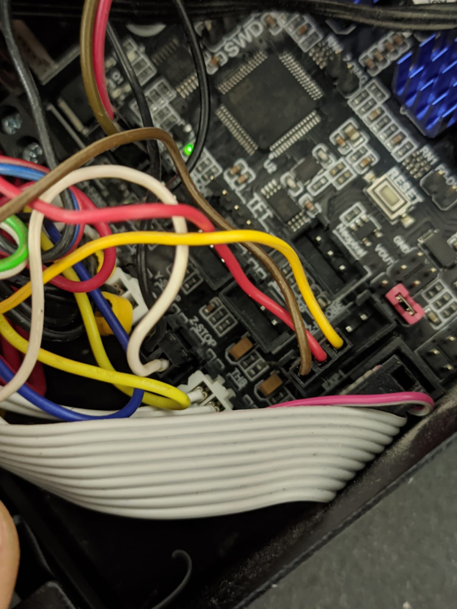

Hello. Im searching few hours with no luck. I try to run my old Ender3 with SKR-Mini E3 V2 + CloneBLTouch. I cant run it. On Marlin BLTouch works fine, here i get triggered/open state all the time. I try connection to PC14 (Probe-Z) to PC2 (Z-STOP) nothing. Here is my config [https://pastebin.com/1Z88bp7J](https://pastebin.com/1Z88bp7J "https://pastebin.com/1Z88bp7J") (i try PC14, ^PC14, ^!PC14, same with PC2) This is my connection: I will be gratefull for any hints.

When i set this 🙂 (Signal from 3Dtouch is connected to Probe-Z , not Z-STOP)
`z_offset: 0.0`
`sensor_pin: PC14 `
`control_pin: PA1 `
`x_offset: -38 `
`y_offset: -9 `
`samples: 2 `
`speed: 1 `
`sample_retract_dist: 2.0 `
`lift_speed: 1 `
`samples_result: average `
`samples_tolerance: 0.100 `
`samples_tolerance_retries: 0 `
`probe_with_touch_mode: True `
`pin_up_reports_not_triggered: False `
`pin_up_touch_mode_reports_triggered: False`
G28 works. So if anyone can only check that this is ok (nothing wrong in this config) i leave it for anyone with such problem

Correct it is a probe not an endstop BUT it creates a virtual\_endstop. See:
> **[Configuration reference - Klipper documentation](https://www.klipper3d.org/Config_Reference.html#duplicate_pin_override)**
You need to set
endstop_pin:probe:z_virtual_endstop
For every Z motor. This then causes the BLtouch be BOTH a probe and an endstop.
