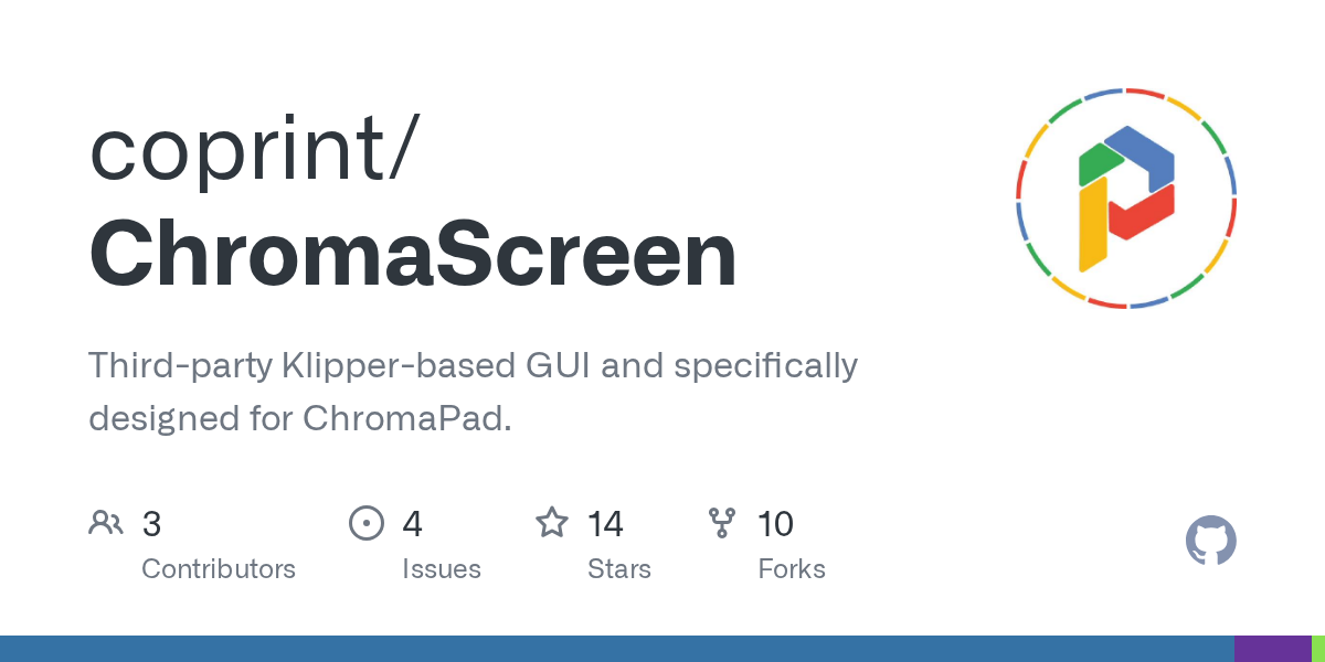

as a note here, the reason there is no klipper fork for the chromapad is because it runs mainline klipper, mainsail, etc. @cardoc tagging for awareness aswell
The only pad specific code is the screen software “chromascreen” which is a fork of octoscreen
