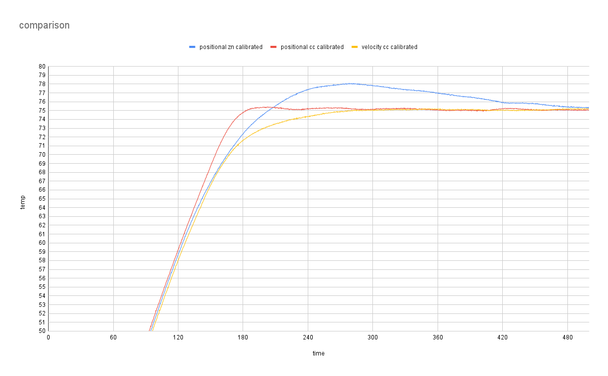

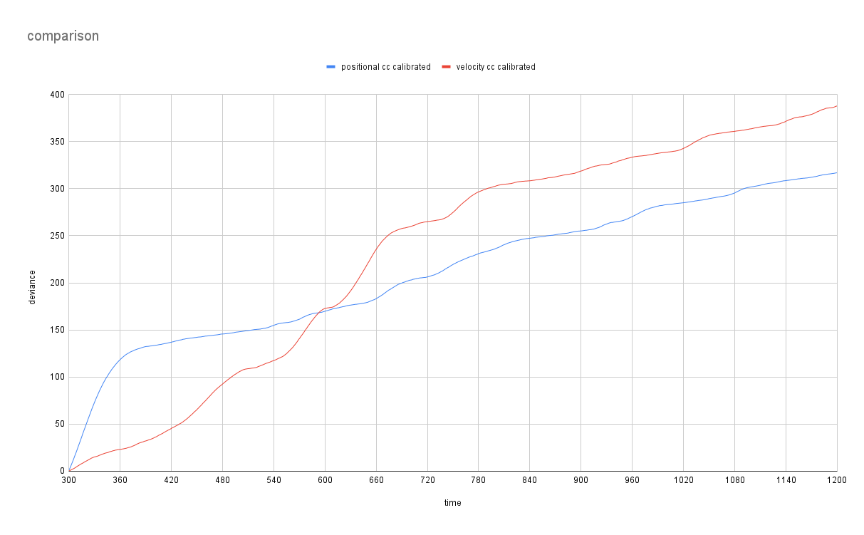

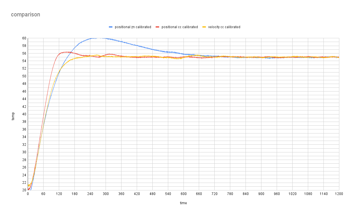

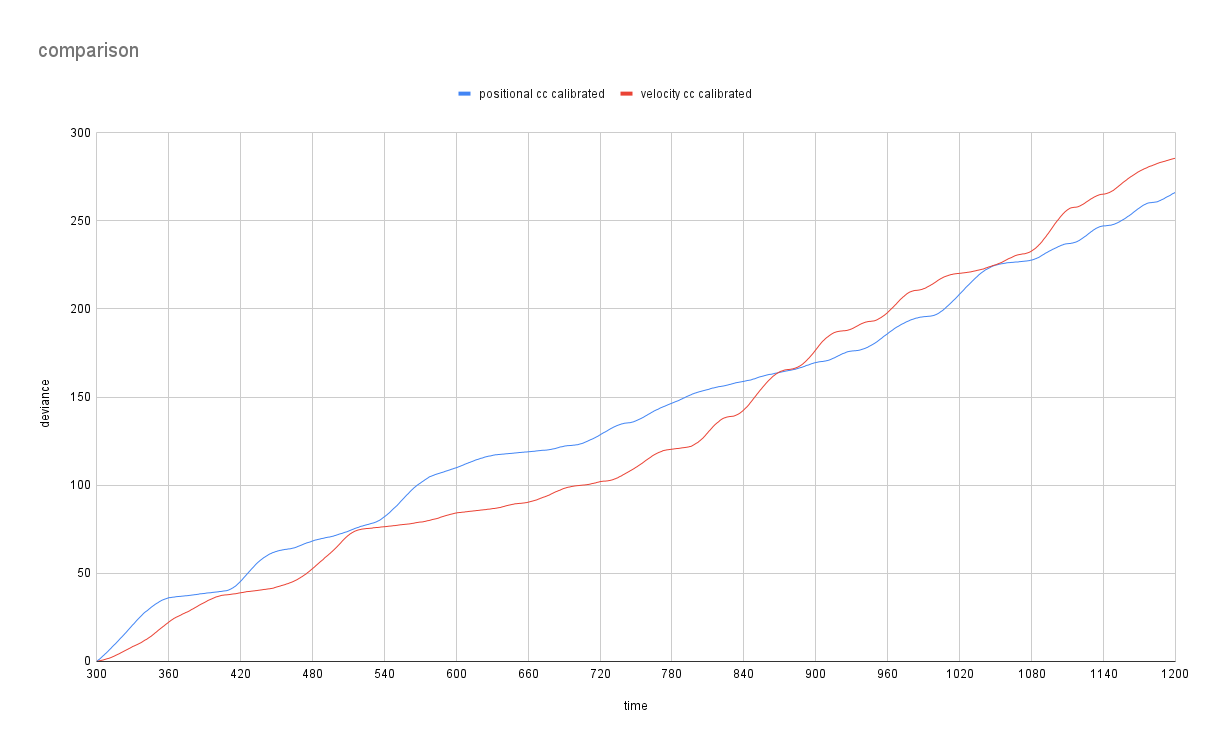

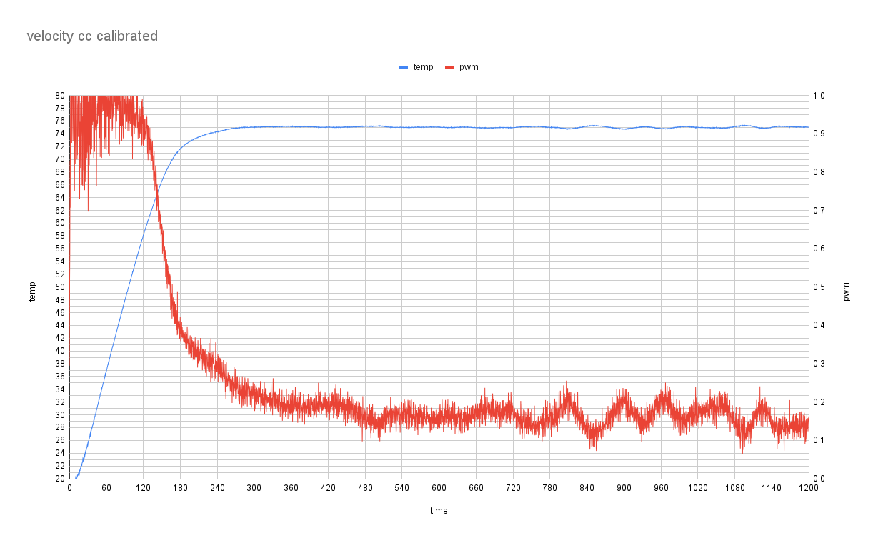

The following graphs show comparisons between Ziegler-Nichols classic & Cohen-Coon parameters generated from the same calibration run.
**The plot shorthand is as follows:**
positional - the current control algorithm used by klipper
velocity - the new velocity control algorithm
zn - Ziegler-Nichols
cc - Cohen-Coon
calibraded - pid parameters generated directly from a calibration run.
manual - pid parameters generated from a calibration run that have been manually tweaked to yield better performance.
**75C bed**
 ![75_position_zn](https://global.discourse-cdn.com/free1/uploads/klipper/original/2X/6/6c1680532fc0f406b56d1021917409118179b915.png)
 ![75_position_cc](https://global.discourse-cdn.com/free1/uploads/klipper/original/2X/0/06587ea082ba5a4a9bb51700e9982126f90fcd39.png)
 ![75_velocity_cc](https://global.discourse-cdn.com/free1/uploads/klipper/original/2X/8/87927ed8db58529cd88cd97f4e7c8349ceb4673d.png)
 ![75_full](https://global.discourse-cdn.com/free1/uploads/klipper/original/2X/6/6362a582678c5dc64b14160bf2bdf032ee748be0.png)
 ![75_over](https://global.discourse-cdn.com/free1/uploads/klipper/original/2X/9/929e3aece3dbae012a06e41f23f347085e7db595.png)
 ![75_deviance](https://global.discourse-cdn.com/free1/uploads/klipper/original/2X/5/5fa41324670bd597f11ba649f3c2aff30a195bd0.png)
**55C bed**
 ![55_full](https://global.discourse-cdn.com/free1/uploads/klipper/original/2X/9/9b47f92deaa70432c22482da06fda6b91a510395.png)
 ![55_over](https://global.discourse-cdn.com/free1/uploads/klipper/original/2X/f/f609b08aecd6c4cbf8c430b15d1dfa55ba0e010d.png)
 ![55_deviance](https://global.discourse-cdn.com/free1/uploads/klipper/original/2X/2/278ca98d45e63740f5353723d8906da1a9954d17.png)

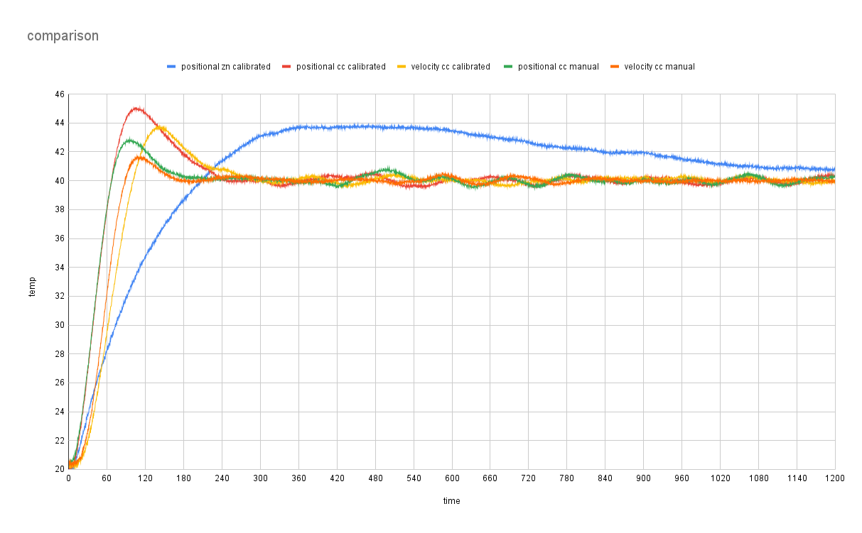

**40C bed**
40C is by far the hardest scenario to control on my printer. it’s within 20C of ambient and only requires 4 to 6% of the heaters capacity to maintain temperature.
 ![40_full](https://global.discourse-cdn.com/free1/uploads/klipper/original/2X/9/9419aaf713a74f92772eddac9b37a552aa90ab30.png)
 ![40_over](https://global.discourse-cdn.com/free1/uploads/klipper/original/2X/a/ade348ce438110381ec31fc0bc566e5ce25d545b.png)
 ![40_deviance](https://global.discourse-cdn.com/free1/uploads/klipper/original/2X/3/37f3237b2d895dedb5fe578be7a60dc15925032c.png)
