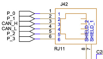

BTW - does the Octopus have a terminator on the bus? I couldn’t find anything in the documentation about termination resistor.
I don’t fully understand the schematic, but yes it does have a termination resistor. When connected to my bus which has a 120ohm resistor at the end I show 60ohms between L and H.
Thanks! There seems to be indeed terminator installed.

It uses RJ12, not 11.
RJ11 will not work
-Kharma
The schematic and wikipedia disagree:
RJ11 uses a 6-pin modular housing with the 2 center pins wired, which is what the Octopus 1.1 has. RJ12 is the same housing, but with more pins wired.
This is not correct. CAN only needs the middle two pins. RJ11 has 4 around the middle, RJ12 has all 6 pins. Both will work just fine.
I’m currently using RJ11 and can confirm it works fine
