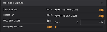

I’m using a [Noctua 4 wire fan](https://noctua.at/en/nf-a4x10-24v-pwm/specification) as the hotend fan connected to a BTT EBB SB2209 CAN (specifically the EBB SB0000 CAN) 4-wire fan header.
 ![image](https://global.discourse-cdn.com/free1/uploads/klipper/original/3X/5/4/54dcdb55d5c728249cd715bb714d33e975c2d5c3.png)
The configuration for the fan is as follows:
[heater_fan heater_fan]
pin: mcu1:PB14
max_power: 1.0
cycle_time: 0.00001
fan_speed: 1.0
hardware_pwm: False
heater: extruder
heater_temp: 50.0
kick_start_time: 0
off_below: 0.0
tachometer_pin: ^mcu1:PB15
tachometer_ppr:2
tachometer_poll_interval: 0.00004
The fan is running fine; switching ON and OFF when threshold is reached or the hotend is heating, but neither Fluidd nor Mobilraker show any RPM for the fan when it’s running.
 ![image](https://global.discourse-cdn.com/free1/uploads/klipper/original/3X/c/8/c81422e076c1e48f819edb4f96ad64b04e5ef26a.jpeg) ![Screenshot 2025-10-10 150621](https://global.discourse-cdn.com/free1/uploads/klipper/original/3X/f/a/fa83226252b57af68c7463511cc2b96d3ccbf3f3.png)
I have tried the following to fix it, but no luck:
 → Changed values for `tachometer_poll_interval` (0.01 to 0.00001)
 → Deleted and added pull-up to `tachometer_pin`
 → New fan
 → New printhead board 2x
 → Re-crimped the connector 3x
Nothing I try seems to give me any RPM for the fan, which makes it slightly hard to see if it’s running at the 5000 1/min which it should, or if I need to change settings.

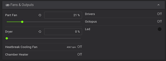

**Author:** ![nefelim4ag](https://yyz2.discourse-cdn.com/free1/user_avatar/klipper.discourse.group/nefelim4ag/32/2387_2.png) [@nefelim4ag](https://klipper.discourse.group/u/nefelim4ag)\
**Post date:** [October 10, 2025, 5:49pm UTC](https://klipper.discourse.group/t/fan-tachometer-not-giving-any-value-for-heater-fan/24989/10 "2025-10-10T17:49:06Z")
I did make a test:
[heater_fan heatbreak_cooling_fan]
pin: ebb42:PA0 # FAN0
heater: extruder
heater_temp: 70.0
fan_speed: 0.5
cycle_time: 0.003
tachometer_pin: PG15 # I do have hardware pull-up here
tachometer_ppr: 2
tachometer_poll_interval: 0.0003
So, I remapped working tachopin from other fan, and well, it works:
 ![image](https://global.discourse-cdn.com/free1/uploads/klipper/original/3X/3/6/362990d3134a69703b97117695f80596e36c5bdb.png)
> [@Gallo](#):
[respond]
[gcode_macro TEST_TACHO]
  ECHO { printer["heater_fan heatbreak_cooling_fan"].rpm }
$ TEST_TACHO
// Unknown command:"ECHO 5428.914217156571"
Your mobileraker screenshot clearly shows that UI is aware of the tacho pin.
So, I would guess there is an issue with detecting RPM, not ui or Klipper.

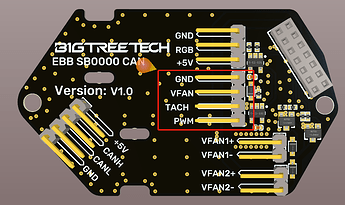

**Post date:** [October 10, 2025, 5:57pm UTC](https://klipper.discourse.group/t/fan-tachometer-not-giving-any-value-for-heater-fan/24989/11 "2025-10-10T17:57:02Z")
Probably it is the stm32 chip:
MCU 'mcu1' config: ADC_MAX=4095 BUS_PINS_i2c1_PA9_PA10=PA9,PA10 BUS_PINS_i2c1_PB6_PB7=PB6,PB7 BUS_PINS_i2c1_PB8_PB9=PB8,PB9 BUS_PINS_i2c2_PA7_PA6=PA7,PA6 BUS_PINS_i2c2_PB10_PB11=PB10,PB11 BUS_PINS_i2c2_PB13_PB14=PB13,PB14 BUS_PINS_i2c3_PA7_PA6=PA7,PA6 BUS_PINS_i2c3_PB3_PB4=PB3,PB4 BUS_PINS_i2c3_PC0_PC1=PC0,PC1 BUS_PINS_spi1=PA6,PA7,PA5 BUS_PINS_spi1_PA6_PA7_PA5=PA6,PA7,PA5 BUS_PINS_spi1_PB4_PB5_PB3=PB4,PB5,PB3 BUS_PINS_spi1a=PB4,PB5,PB3 BUS_PINS_spi2=PB14,PB15,PB13 BUS_PINS_spi2_PB14_PB15_PB13=PB14,PB15,PB13 BUS_PINS_spi2_PB2_PB11_PB10=PB2,PB11,PB10 BUS_PINS_spi2_PC2_PC3_PB10=PC2,PC3,PB10 BUS_PINS_spi2a=PC2,PC3,PB10 BUS_PINS_spi3=PB4,PB5,PB3 BUS_PINS_spi3_PB4_PB5_PB3=PB4,PB5,PB3 CANBUS_FREQUENCY=1000000 CLOCK_FREQ=64000000 MCU=stm32g0b1xx PWM_MAX=257 RECEIVE_WINDOW=192 RESERVE_PINS_CAN=PB0,PB1 RESERVE_PINS_crystal=PF0,PF1 STATS_SUMSQ_BASE=256 STEPPER_OPTIMIZED_EDGE=8 STEPPER_STEP_BOTH_EDGE=1
So probably it is the:
> <https://github.com/bigtreetech/EBB/blob/master/EBB%20SB2240_2209%20CAN/SB2209/Hardware/SB2209.png>

**Author:** ![Gallo](https://avatars.discourse-cdn.com/v4/letter/g/cab0a1/32.png) [@Gallo](https://klipper.discourse.group/u/Gallo)\
**Post date:** [October 10, 2025, 6:04pm UTC](https://klipper.discourse.group/t/fan-tachometer-not-giving-any-value-for-heater-fan/24989/13 "2025-10-10T18:04:51Z")
Yes, it’s the STM32 version.
> [@nefelim4ag](#):
Correct. The UI is aware of it, but no matter what I do, I can’t get any value for the RPM. I can test what you suggested, but if the Mobileraker UI isn’t detecting any RPM, I doubt a macro will.
I’m pretty sure the hardware is alright too, as I checked and double checked the crimped pin is sitting properly on the cable.
It could be, that the pull-up resistor build into the board is too small. I will try to add a hardware one.
