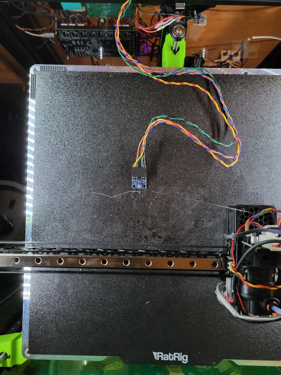

My Z is in stealthChop.
Without input\_shaper, there is a dull sound on the Z stop, with the shaper, there is no such sound.
It works.
ADXL345 glued with a glue gun to the bed temporarily for the test.
 ![image](https://global.discourse-cdn.com/free1/uploads/klipper/original/3X/5/a/5a3c7f1b4ce3f08c8d302237cb60f8f1d19b48c4.jpeg)
[raw\_data\_z\_adxl345\_20250921\_012012.zip](https://klipper.discourse.group/uploads/short-url/xazmCKlQ7B7iFtenMpl17ilxp5L.zip) (2.1 MB)

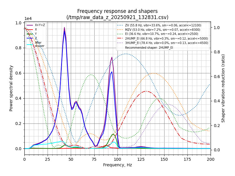

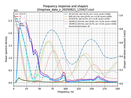

**Author:** ![MRX8024](https://avatars.discourse-cdn.com/v4/letter/m/c37758/32.png) [@MRX8024](https://klipper.discourse.group/u/MRX8024)\
**Post date:** [September 21, 2025, 11:21am UTC](https://klipper.discourse.group/t/feature-testing-z-axis-input-shaper/24886/11 "2025-09-21T11:21:42Z")
I find this innovation useful, as it significantly reduces z-axis vibration. Even if you don’t use zhop constantly (and many do, and it takes up significant print time), any z-axis movement will now be faster without increasing vibration. A resonance test for the z-axis can help identify and fix problems on this axis.
Vzbot235, attached the adxl345 to the bed base frame via screw. I have a standard base made of 2020 profile and plastic, as is the entire z-axis.
I increased these parameters because the vibrations were not noticeable against the background noise, but I overdid it a little, I think it’s not a big deal.
accel_per_hz_z: 40
sweeping_accel_z: 100
> **Without shaping**
> ![Without shaping](https://global.discourse-cdn.com/free1/uploads/klipper/original/3X/b/4/b48d8c09ef535e131c51149f5b12932dd1438d89.jpeg)
> [raw\_data\_z\_20250921\_132831.zip](https://klipper.discourse.group/uploads/short-url/lsgT5zlBSPkDoFuxFsXsAUdv1qM.zip) (2.9 MB)
> **With shaping**
> ![With shaping](https://global.discourse-cdn.com/free1/uploads/klipper/original/3X/4/c/4c91d05156ab73c047f672feb38bed95b566895a.jpeg)
> [raw\_data\_z\_20250921\_133427.zip](https://klipper.discourse.group/uploads/short-url/9QIMafVYvs9Q0k9x8EfoYSlHgXA.zip) (2.5 MB)
> **With standard parameters and up to 200 Hz**
> ![Without shaping](https://global.discourse-cdn.com/free1/uploads/klipper/original/3X/4/8/489b467a4a3416091c56e8ef0f5507686bbc8a7a.jpeg)
> [raw\_data\_z\_20250921\_130933.zip](https://klipper.discourse.group/uploads/short-url/81UfgRBNDV74fS36pXFCSemGa4V.zip) (5.5 MB)
I think we have several resonances due to the transition nodes. The bed is driven by two trapezoidal screws through Oldham couplings, and then they are connected by a ring belt to a single motor.
Overall, I don’t think you even need to run a resonance test; the mere existence of the 3hump shaper at around 80Hz will dampen almost the entire range, and rounding is probably not important on z-axis. Do you have any comments on this, Dmitry?
If you need to test something else, let me know, I don’t plan to move away from this functionality, and the adxl will probably hang on the bed for a long time.

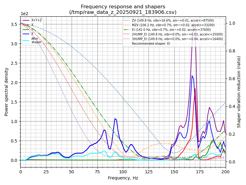

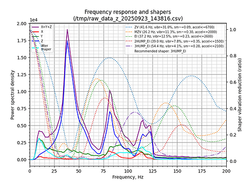

**Post date:** [September 21, 2025, 8:00pm UTC](https://klipper.discourse.group/t/feature-testing-z-axis-input-shaper/24886/13 "2025-09-21T20:00:56Z")
Another vzbot235 from the community but with a metal z-axis. Default test settings.
> **Graph**
> ![raw_data_z_20250921_184858](https://global.discourse-cdn.com/free1/uploads/klipper/original/3X/9/b/9b3320d0e7f41f481a9bc8dbc297c6d00205f0eb.png)
> [raw\_data\_z\_20250921\_184858.zip](https://klipper.discourse.group/uploads/short-url/pCMRzyoR9qIpj25zpLsASRzffId.zip) (5.3 MB)
I would like to point out that the new method of resonance generation (sweeping) is very good for trapezoidal screws that have play in the nuts, and without it the measuremets is distorted. I’m not sure if it’s them exactly, but it’s likely.
> **Graph**
> ![raw_data_z_20250921_183906](https://global.discourse-cdn.com/free1/uploads/klipper/original/3X/e/f/ef5dcb86a894f98ead1c8043a4056ad795258d4b.png)
> [raw\_data\_z\_20250921\_183906.zip](https://klipper.discourse.group/uploads/short-url/sLsMe1kHeP5Lpwrn2Wu19zJLSFw.zip) (4.7 MB)

> [raw\_data\_z\_20250921\_223356.zip](https://klipper.discourse.group/uploads/short-url/5Q4F8RZdT7AsryB70qHhl4xilmo.zip) (2.6 MB)
I would say that this is still low, and I would like to see a clear 1e3, but as you can see the peaks are clearly visible, and in any case we will not be able to find the optimal value for all printers, I think that accel\_per\_hz\_z=15 is a good default/starting point.

More graphs from another vzbot235, but this time with a mellow aluminium z-axis.
> **accel\_per\_hz\_z=12.5**
> ![accel_per_hz_z=12.5](https://global.discourse-cdn.com/free1/uploads/klipper/original/3X/8/7/87680c890d87a0cc57c73280eb2ba05cb53e2ee6.png)
> [raw\_data\_z\_20250923\_112132.zip](https://klipper.discourse.group/uploads/short-url/h81RmdwblEHzx9u6Cl4nnyuOdMN.zip) (5.2 MB)
> **accel\_per\_hz\_z=15**
> ![accel_per_hz_z=15](https://global.discourse-cdn.com/free1/uploads/klipper/original/3X/0/b/0bc685a6fb903fae4762e03e4d54942edf5c37f4.png)
> [raw\_data\_z\_20250923\_111551.zip](https://klipper.discourse.group/uploads/short-url/nr4vIZ8jcwlAWSB4QxO5YMsbJCw.zip) (5.4 MB)
I also ran a test on my personal vz235 (from [this](https://klipper.discourse.group/t/feature-testing-z-axis-input-shaper/24886/11) post) with accel\_per\_hz\_z=100, just for experiment.
> **accel\_per\_hz\_z=100**
> ![accel_per_hz_z=100](https://global.discourse-cdn.com/free1/uploads/klipper/original/3X/5/9/59628c31f70e35e26b976c07e3351f999967ce51.png)
> [raw\_data\_z\_20250923\_143816.zip](https://klipper.discourse.group/uploads/short-url/rO4Ctp0ojrwAaJPK20avDcM112P.zip) (4.2 MB)
