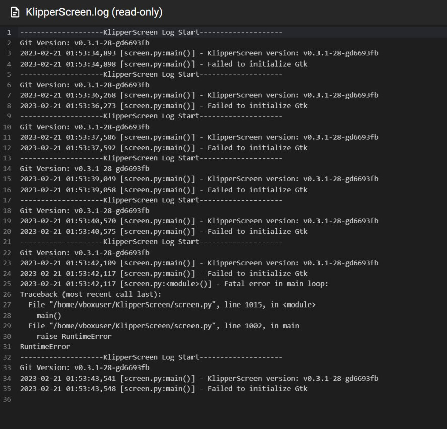

Only when Klipperscreen is not connected to any device, the log file keeps registering the same errors:
Failed to initialize Gtk and Fatal error in main loop: RuntimeError.
Is this normal?
Is this normal?
