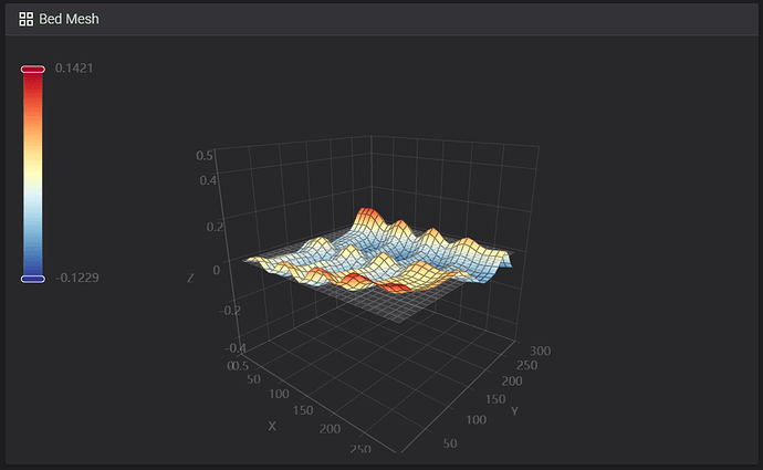

I may have found a solution to my bed level issue. From my prior post on the 27th, one thing you will notice from the main picture is the location of the bed screws and other thing is that I’m using a magnetic base as well. One test I ran last night was to increase my mesh points to 80 x 80, essentially giving me around 6400 points on my mesh. While this did crash my MCU every time I tried to home an axis, I was able to visualize the mesh in the tune window of Fluidd. What I was able to see was the impact the bed screws were having on my bed mesh which was generating false dips in the bed.
The first step I took was to identify the screw regions as faulty regions and input them into my printer.cfg file.
Next, as part of the 80 x 80 mesh, I noticed ripples in the mesh which is noted as a possible issue when using a bicubic algorithm. I was using the default bicubic\_tension =0.2. I never increased the value. Rather I continued to decrease the matrix mesh, eventually getting to 6x6 but never entirely removing the ripples. Once I reached 6x6 I switched from bicubic to Lagrange and the ripples disappeared.
Finally, I realized the left to right issue on the bed was due to the x-axis not moving symmetrically on the left and right. This is most likey due to the large x-axis of 400. I’ve tried tightening the v roller but there is still too much play on the right side of the gantry. I’ve ordered a couple of T8 Anti Backlash Spring Loaded Nuts. I already had a dual z setup but when I moved to the enderextender XY upgrade I didn’t have a long enough belt to reach the right side of the gantry. I thought I could get by without it but now I see I do need to add the dual z back into the system. I’ve ordered a longer belt as well and will report back if this resolved the issue shown in the images from left to right.
**Author:** ![ReXT3D](https://yyz2.discourse-cdn.com/free1/user_avatar/klipper.discourse.group/rext3d/32/200_2.png) [@ReXT3D](https://klipper.discourse.group/u/ReXT3D)\
**Post date:** [June 30, 2021, 3:09am UTC](https://klipper.discourse.group/t/impossible-bed-mesh-leveling-cr10spro-v2/204/38 "2021-06-30T03:09:49Z")
If you are curious what flat spotted X-gantry wheels result in, have a look at the following two images. The first one shows my bed mesh after I had a somewhat controlled nozzle crash into the bed while I was experiencing issues with BL Touch installation. This occurred while I was also experimenting with inexpensive but allegedly “good quality” polycarbonate wheels from AliExpress. The second one shows the exact same installation just after I replaced the awful polycarbonate wheels with the reasonably high quality Openbuilds wheels. Note that there is still a wave in the Y axis that I believe is caused by the design of the Y rails on the CR-10S Pro.
 ![bed_mesh_BAD_PC_Wheels](https://global.discourse-cdn.com/free1/uploads/klipper/original/1X/d2fda783f497534d1617dfeeb95b55abb177367d.png)
 ![bed_mesh_GOOD_OB_Wheels](https://global.discourse-cdn.com/free1/uploads/klipper/original/1X/e311ce4ec696e9ab5b300977e8db4cdd587e6830.png)
When you install the anti-backlash nuts make sure that you install them the correct way or they could make things worse. The springs have to be ABOVE the gantry, pushing the gantry down with gravity assist. Unfortunately many guides, including some created by allegedly reputable places show the anti-backlash nuts installed INCORRECTLY with the springs below the gantry, resulting in the springs trying to lift the gantry against gravity. Also get quality anti-backlash nuts. The first ones I got off Amazon were simply awful, they looked like something I would file in my basement with a hand file after a New Years’ Eve party. Ones I currently use came from ‘REPRAP Official Store’ on AliExpress and they are of very high quality.
