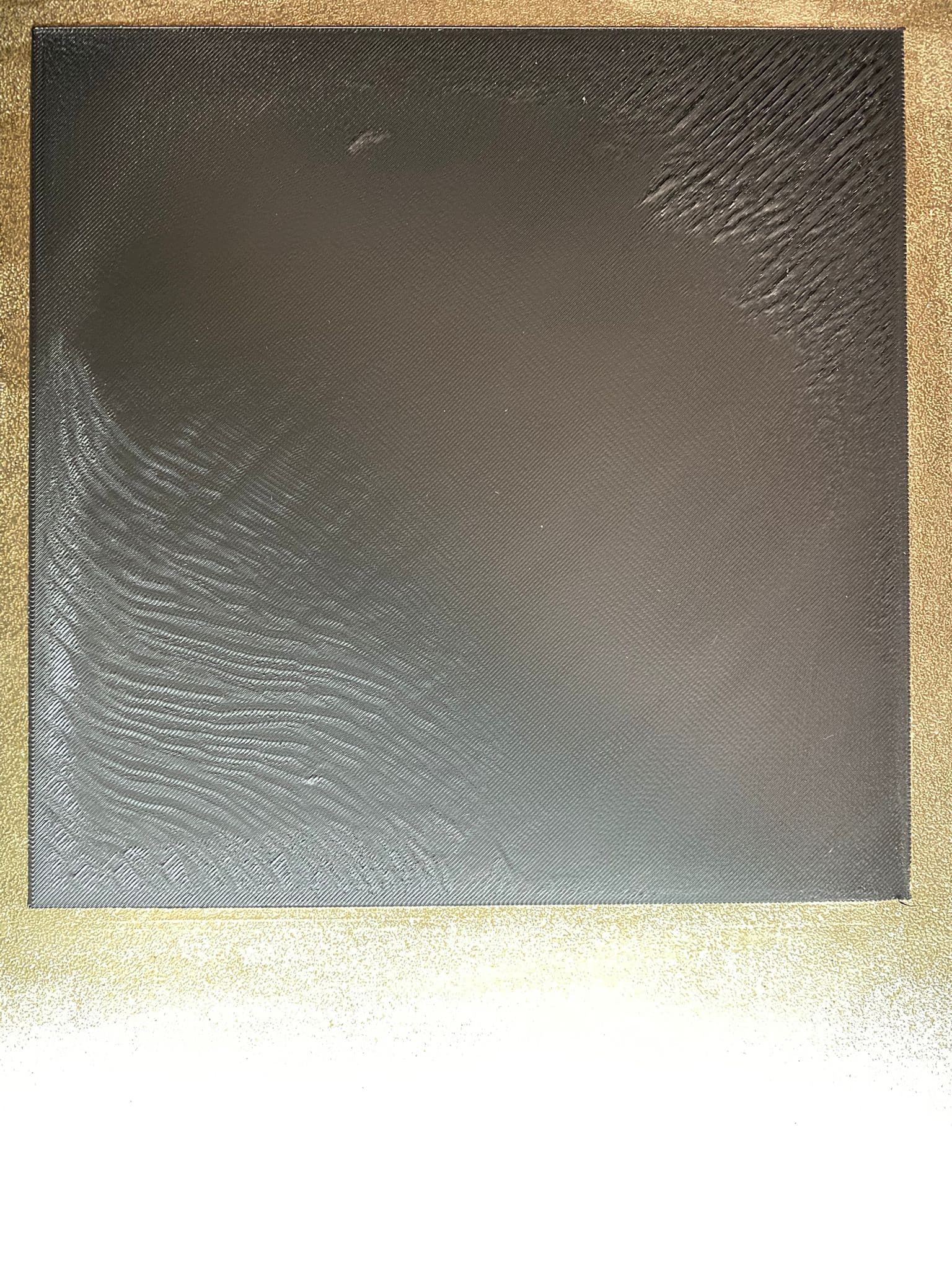

 ![WhatsApp Image 2025-07-25 at 09.29.23 (1)](https://global.discourse-cdn.com/free1/uploads/klipper/original/3X/8/c/8c9c547757b23ee6b33a4a1d31fe3250d81c296d.jpeg)
 ![WhatsApp Image 2025-07-25 at 09.29.23](https://global.discourse-cdn.com/free1/uploads/klipper/original/3X/2/3/233b57c6781e1e3f8e11be462bbc2b30bbd296cb.jpeg)
 ![WhatsApp Image 2025-07-25 at 09.29.22 (3)](https://global.discourse-cdn.com/free1/uploads/klipper/original/3X/2/8/28b5d10bcb84d96e491d6a28826dead693428602.jpeg)
 ![WhatsApp Image 2025-07-25 at 09.29.22 (2)](https://global.discourse-cdn.com/free1/uploads/klipper/original/3X/f/6/f637ceaa807e48b2642742eb034188c74bb3ce5f.jpeg)
 ![WhatsApp Image 2025-07-25 at 09.29.22 (1)](https://global.discourse-cdn.com/free1/uploads/klipper/original/3X/1/0/10467cc605f124f786bc7f8ed5e70b8a187653a1.jpeg)
The first layer print is as shown in the images I sent.

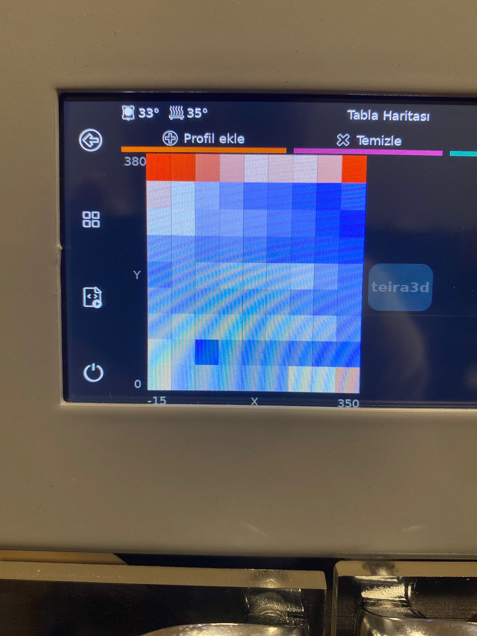

In Mainsail (Hightmap) /Fluidd (Tune) you have a bed mesh visualisation.
How does that look?
**Author:** ![rkutun](https://avatars.discourse-cdn.com/v4/letter/r/53a042/32.png) [@rkutun](https://klipper.discourse.group/u/rkutun)\
**Post date:** [July 25, 2025, 7:44am UTC](https://klipper.discourse.group/t/inconsistent-first-layer-across-bed-despite-z-tilt-and-mesh-leveling/24344/5 "2025-07-25T07:44:27Z")
![WhatsApp Image 2025-07-25 at 10.43.01](https://global.discourse-cdn.com/free1/uploads/klipper/original/3X/e/d/ed65c74f272febf2b8fd5d6d3d3a0c2a2cbc1d52.jpeg)
 ![resim](https://global.discourse-cdn.com/free1/uploads/klipper/original/3X/f/7/f72cef6bccf61035f0702eb7d5f36eec937d09e0.png)

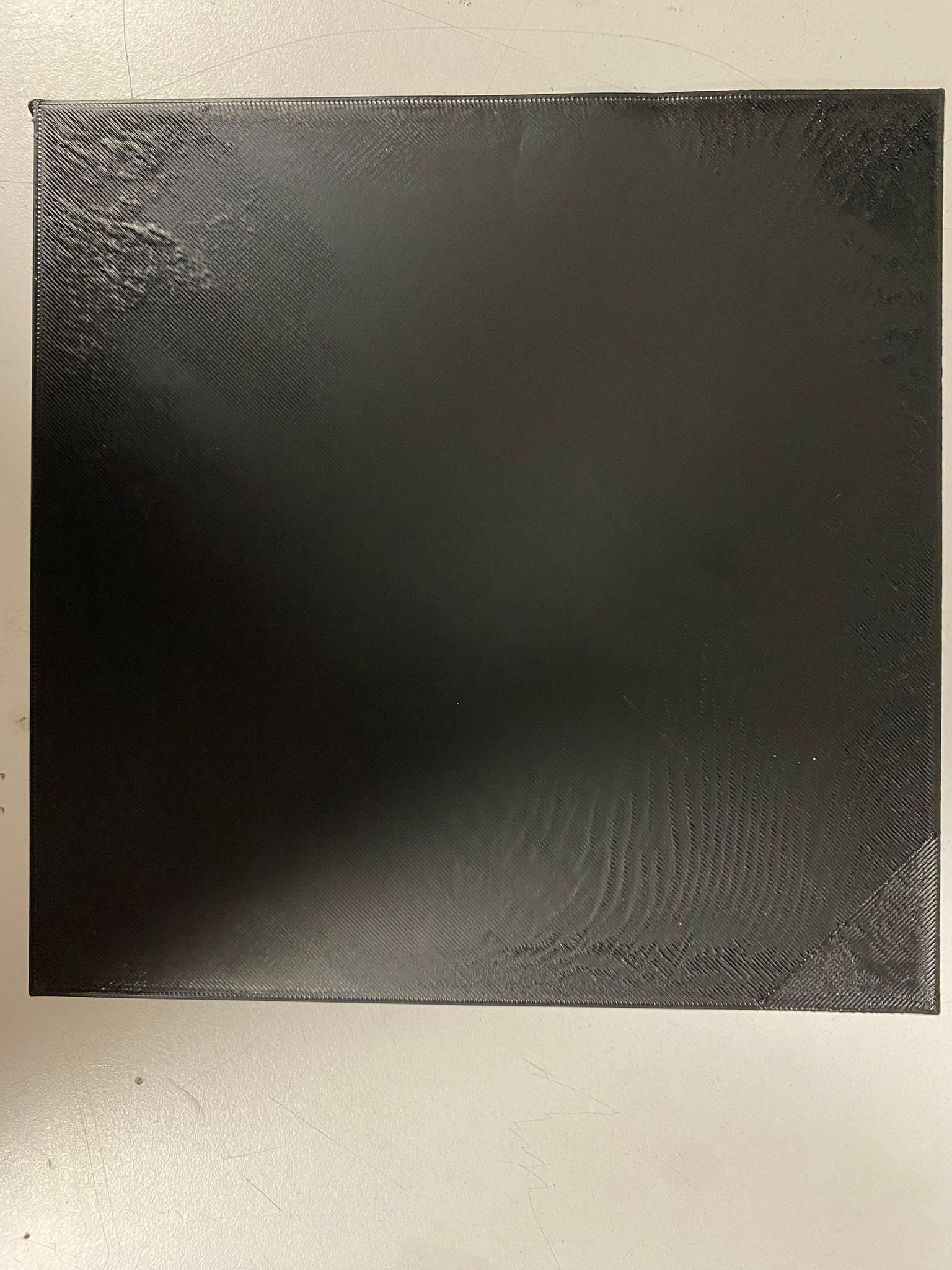

![WhatsApp Image 2025-07-25 at 16.34.50 (1)](https://global.discourse-cdn.com/free1/uploads/klipper/original/3X/3/5/35219768586a62634240fadd0022d295797a3951.jpeg)
 ![WhatsApp Image 2025-07-25 at 16.34.50](https://global.discourse-cdn.com/free1/uploads/klipper/original/3X/5/9/592439c68e34c6448bf269c794b6d5ad455f0414.jpeg)
Problems with printing are still ongoing. Help please!
**Post date:** [July 25, 2025, 3:05pm UTC](https://klipper.discourse.group/t/inconsistent-first-layer-across-bed-despite-z-tilt-and-mesh-leveling/24344/16 "2025-07-25T15:05:54Z")
First, you may find out, what lifts up the bed on the left side?

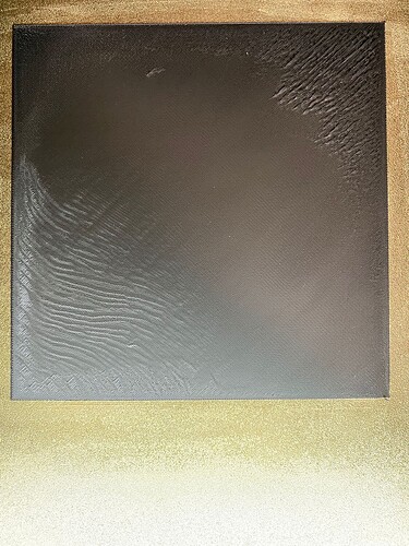

![Print](https://global.discourse-cdn.com/free1/uploads/klipper/original/3X/4/3/4357cf4aa101f8e8979b9e40113e2b95ed81db54.jpeg)
The area marked as number 1 in the photo corresponds to the front-right corner of the bed (X max, Y min). After performing a mini step adjustment (Z offset calibration) here, the print starts well in that area. However, in areas 2 and 3, the print quality deteriorates. In area 2, the nozzle is too close to the bed, even causing vibration during printing. In area 3, the nozzle is too far from the bed. Area 4 shows good print quality and looks fine.
What could be the cause of this issue, and how can I fix it? I would really appreciate your help.
