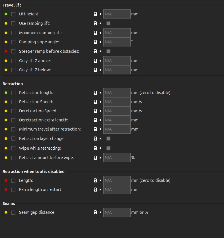

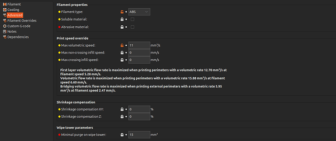

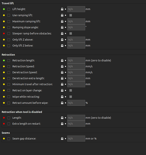

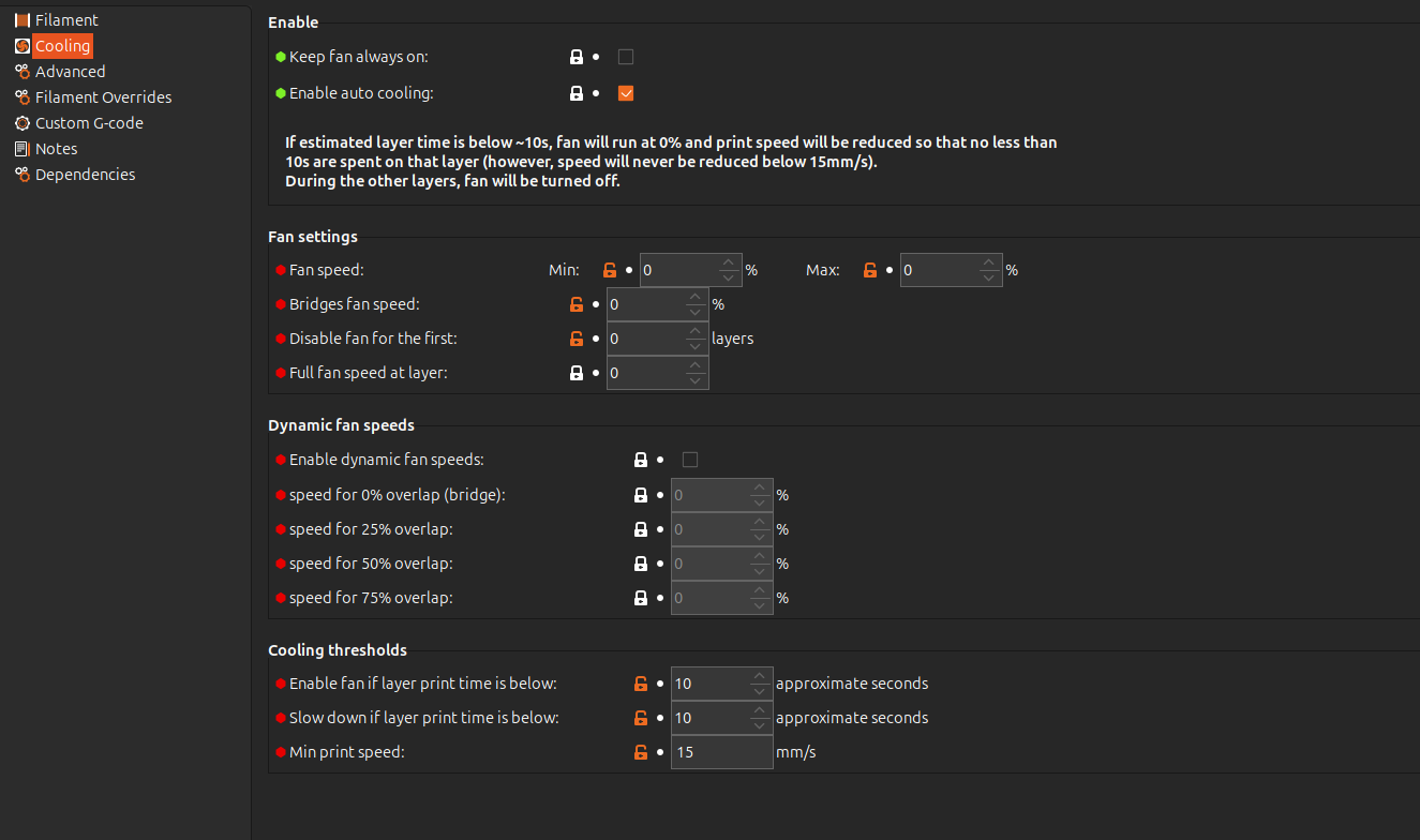

**Author:** ![rkutun](https://avatars.discourse-cdn.com/v4/letter/r/53a042/32.png) [@rkutun](https://klipper.discourse.group/u/rkutun)\
**Post date:** [August 1, 2025, 12:09pm UTC](https://klipper.discourse.group/t/inconsistent-first-layer-across-bed-despite-z-tilt-and-mesh-leveling/24344/30 "2025-08-01T12:09:27Z")
![resim](https://global.discourse-cdn.com/free1/uploads/klipper/original/3X/5/a/5ad3fae56fb719ba17b48bf96e330f187ca72a1c.png)
 ![resim](https://global.discourse-cdn.com/free1/uploads/klipper/original/3X/4/0/40fe8658d1940f95af7b18718877155862952acd.png)
 ![resim](https://global.discourse-cdn.com/free1/uploads/klipper/original/3X/8/1/8165f20999a4aa285b15e1643a187ffc2afe600a.png)
 ![resim](https://global.discourse-cdn.com/free1/uploads/klipper/original/3X/5/b/5b248e114e7770fff07a0a27be1ee211597c9af9.png)
 ![resim](https://global.discourse-cdn.com/free1/uploads/klipper/original/3X/4/a/4a7d8bc9915eb74d1bf855feacb926c82950867e.png)
 ![resim](https://global.discourse-cdn.com/free1/uploads/klipper/original/3X/7/6/76abb0f06b7ba0ae3339248e81bdbe53aec3d1bb.png)
Are there any errors in my Prusa settings?

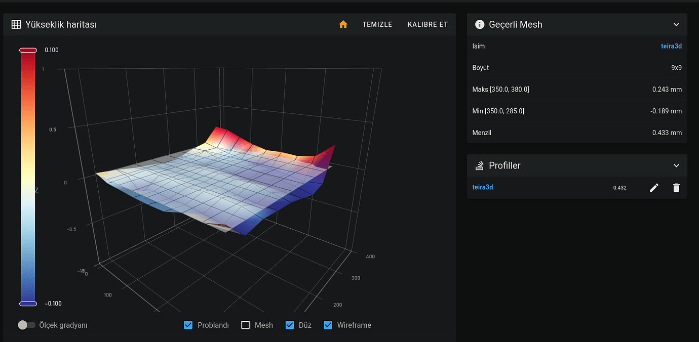

Did you run your mesh at 100 °C? Is klipper adjusting Z for the wrong bed shape?
I’d also adjust the mesh area to exclude the high edge,
 ![image](https://global.discourse-cdn.com/free1/uploads/klipper/original/3X/c/9/c9edc0b4e828ffd2dd0c2d7d4d345b67b32ddf98.jpeg)
I think the high points are “edge effects” and are not accurate.

![resim](https://global.discourse-cdn.com/free1/uploads/klipper/original/3X/9/a/9aa79d70c40dd6916be4cc30b0f031eb7e8cf59e.png)
I did this by changing the bed leveling positions. This is how it looks. I took 15mm inward from the edges of the printing table.
