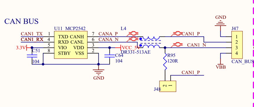

HOWEVER… The CAN bus connector on the right hand side of the board…
 ![image](https://global.discourse-cdn.com/free1/uploads/klipper/original/2X/1/10a86dc2d012dfcd6d9703ac4065aad096c06b0e.png)
directly interfaces with an MCP2542
> **[MCP2542FD-4FD-MCP2542WFD-4WFD-Data-Sheet20005514B.pdf](https://ww1.microchip.com/downloads/en/DeviceDoc/MCP2542FD-4FD-MCP2542WFD-4WFD-Data-Sheet20005514B.pdf)**
> 1065.46 KB
Which is another CAN Bus transceiver.
Which brings us full circle back to…
> You cannot have CAN Bus without some sort of CAN Transceiver.

### Author: ![TheFuzzyGiggler](https://yyz2.discourse-cdn.com/free1/user_avatar/klipper.discourse.group/thefuzzygiggler/32/12313_2.png) [@TheFuzzyGiggler](https://klipper.discourse.group/u/TheFuzzyGiggler)
#### Post date: [April 16, 2024, 8:16pm UTC](https://klipper.discourse.group/t/issues-with-can-bus/15771/51 "2024-04-16T20:16:20Z")
You’re both focused on the U2C.
The SKRAT has NO CAN TRANSCEIVER on the USB CONNECTOR.
Therefore it CANNOT do CAN Bus via the connector in the way that @DrumClock is connecting it.
Just because a Microcontroller has the CAN Protocol built it, it HAS to have a transceiver to drive the CAN lines per the CAN standard.
Lets recap:
- I agree the STM32 chip on both the SKRat and the U2C support to the CAN Bus protocol.
- I agree that, althought its weird, the U2C supports CAN bus over that USB A connector
What I DON’T agree with, Is that you can use the SKRats USB connector as CAN Bus.
@DrumClock - Yes, The STM32G0B1 supports CAN on PA11/PA12.
On the SKRat
 ![image](https://global.discourse-cdn.com/free1/uploads/klipper/original/2X/f/ffcbf511c058dc4eeb8a52420b8a52e0a07ee13b.png)
CAN RX/TX is connected to PD1/PD0.
PA11/PD12 are configured for USB.
PA12/PA11 do not have a CAN transceiver, PD1/PD0 do.
 ![image](https://global.discourse-cdn.com/free1/uploads/klipper/original/2X/6/6721fd53f9d07c431d27b0d6f206bf451258dd59.png)
Therefore, to use CAN Bus on the SKRat in the way your wiring picture is up top doesn’t work. You HAVE to connect it like you’ve connected the EBB boards using the CAN connector on the right hand side of the board.
Edit:
From the STM32G0B1 datasheet, PD0 and PD1 are FD Can pins, and the MCP2542 is an FD Can transceiver. That’s the pin setup for the SKRat.
 ![image](https://global.discourse-cdn.com/free1/uploads/klipper/original/2X/2/2412b2d2e25be4589f360bbc0ee1fc252258288c.png)
#### Post date: [April 16, 2024, 8:33pm UTC](https://klipper.discourse.group/t/issues-with-can-bus/15771/53 "2024-04-16T20:33:28Z")
You have to have a CAN Transceiver as the physical layer and signal conversion/conditioning.
The Microcontroller only sends out digital signaling but CAN Bus is differential signaling, CAN Bus requires specific termination and line impedance requirements and biggest of all, They’re wildly different voltages.
 ![image](https://global.discourse-cdn.com/free1/uploads/klipper/original/2X/1/134ac62f9078d098c0f3d46f569d20228b30d16f.png)
CAN RX/TX is just the serial protocol, It always requires a transceiver.
Which the SKRat has, it’s just on different pins than the USB connector.
Edit: Unless you’re saying the U2C and SKRat are trying to communicate with each other via their CAN Bus RX/TX lines? Maybe that’s where I’m getting lost at and that’s janky as hell.
