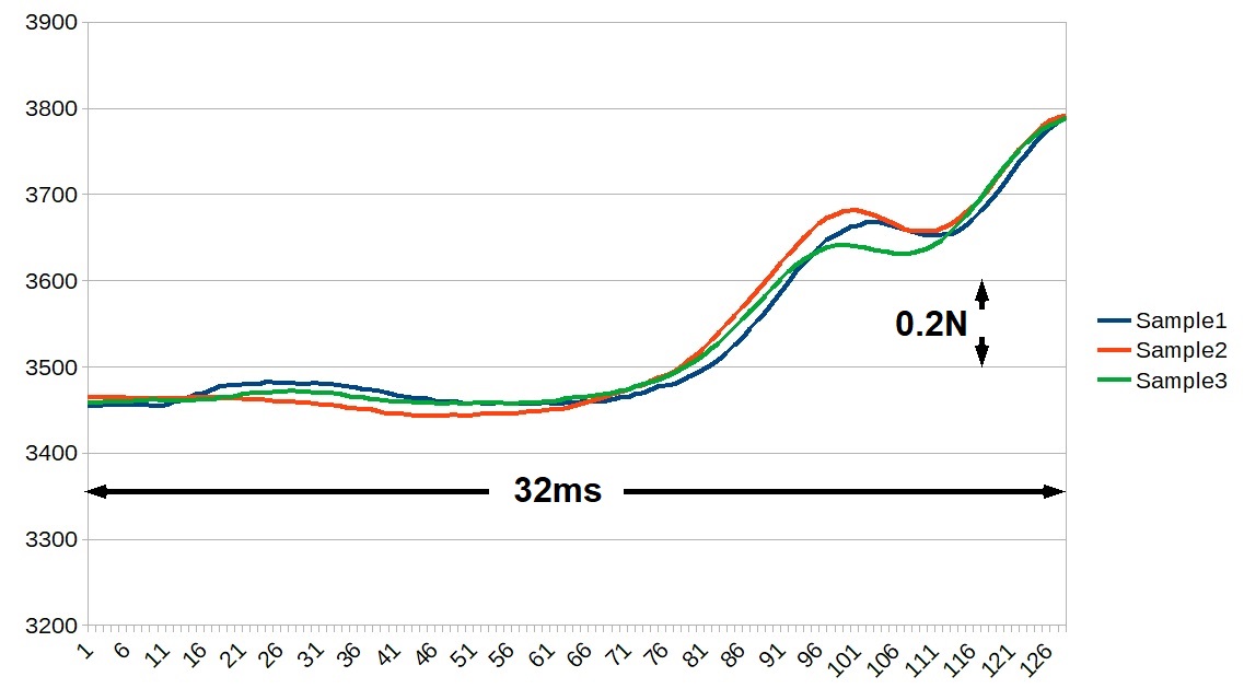

First picture is a trace from a 27mm piezoelectric disc with a simulated contact at only 1mm/sec. This trace is my favorite as it was the very first trace I got and I expected only some tens of milivolts but got 8.0V. More details on [Piezoelectric disks for Z contact detect and bed levelling](https://reprap.org/forum/read.php?1,635075,page=1). The decay after the peak is somewhat faster than I would have expected, but I now think that this is a result of elasticity in parts of the jig - this would also account for the acceleration in the mid part of the upstroke.

The second picture shows three repeats of a 2mm per second nozzle contact on a glass plate with a Kapton film. Each trace is the sum of the output of three piezo discs in an underbed arrangement and each is the pre-trigger data in the 32ms before contact. The trigger was set artificially high to see what was happening. This picture is from the same forum thread, but on the last page.

I like that, I REALLY want a oscilloscope!
It looks really linear, but if you put a straight edge next to it, you see its actually increasing:

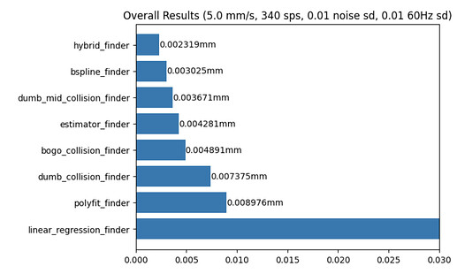

@Alexb I added your “mid” finder as `dumb_mid_collision_finder` and the idea of cascading multiple algorithms as `hybid_finder`.
Here with no noise, the strategies that assume there is some information in the data perform best. This gives you a good idea of the natural rank of the guess based finders.
 ![Screenshot 2023-08-05 at 6.23.22 PM](https://global.discourse-cdn.com/free1/uploads/klipper/original/2X/0/063b554fe520566d343b6f724740aef56ce6670c.png)
But with added noise the hybrid approach is able to win:
 ![Screenshot 2023-08-05 at 6.27.07 PM](https://global.discourse-cdn.com/free1/uploads/klipper/original/2X/d/d7f7536fd362d7620151bada6d1b2648a32f8c36.jpeg)
`dumb_mid_collision_finder` even beats the estimator finder!

Great work! Cannot read through everything right now. But i wanna make one point about the dynamics.
Basically the printbed acts like a mass between two springs, (printhead mount, and printbed mount) one of the two springs includes the strain guage. before the collision the printbed has 0 velocity, or full probing velocity(depending on printer). If we assume both springs have the same stiffness the printbed will accelerate or decelerate to have 0.5\*probing\_velocity during the contact phase.
Let’s assume the printhead is a lot lighter than the buildplate.
This acceleration or deceleration causes a nonlinear behaviour. When mesuring force above the printhead it will be a bump, with momentarily higher deflection(force) at the load cell.
If we measure the force below the bed, the opposite will occur, and it will gradually acellerate before showing a deflection.
Here are my measurements with 3 load cells (5k, hx711) below the printbed.
 ![b84dcc2f22ad40f0674b5566de4aa96a90ae1967_2_1035x696](https://global.discourse-cdn.com/free1/uploads/klipper/original/2X/d/d4daac47092f776c6309b32830939d0d57655d41.png)
 ![c1ed380e15e86f391e6b1a71e0f2d16f14c6578b_2_1035x678](https://global.discourse-cdn.com/free1/uploads/klipper/original/2X/4/4a7b06e1382fba3c35bc9d98f07a3d0b94b9b67d.png)
