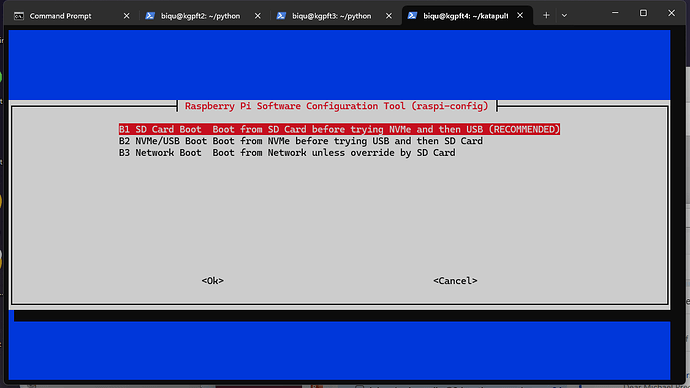

Hey @mykepredko, so I’ve ran into an issue when trying to SSH into my CM5. I ensured to configure the wireless connectivity the exact same way as last time when I got it connected.
I cannot find its IP address on my router so I have a feeling I haven’t flashed the OS image from the SD card correctly.
What I did so far was the following:
1. Ease the memory of the eMMC on the Pi
2. Write the RPI 64 Bit lite OS to my 32 GB SD Card
3. Flash the OS by first disconnecting the board from power, turning DIP switches 3 and 4 OFF, inserting the SD card into the slot all the way and then turning the power back on the board. Am I supposed to see LED ACT flicker after 5 minutes or so? The LED remained static.
I wonder why the connectivity is not working despite having set up the wireless connection on RPI Imager just like before when it worked.
**Post date:** [July 21, 2025, 1:58pm UTC](https://klipper.discourse.group/t/manta-m5p-flashing-and-running-custom-firmware/24269/25 "2025-07-21T13:58:58Z")
The LED should flash for a few minutes during booting.
The most likely cause of what you’re seeing now is that the boot order in the CM5 is still the eMMC.
When you’re doing this, I suggest you connect an HDMI monitor to the Manta M5P so you can see how the CM5 boot is progressing.
Why didn’t you go into `raspi-config` and set the boot order to SD Card first?
 ![image](https://global.discourse-cdn.com/free1/uploads/klipper/original/3X/3/4/34976a6f7cea8684cdfd80f5afc8176599cef728.png)
To go there, select “6 Advanced Options” and then “A4 Boot Order”.
This way, you wouldn’t have had to change anything in your eMMC and if it worked, we could go back to what you’ve done to the eMMC image and figure out what went wrong.

**Post date:** [July 21, 2025, 10:18pm UTC](https://klipper.discourse.group/t/manta-m5p-flashing-and-running-custom-firmware/24269/26 "2025-07-21T22:18:47Z")
Ohh had I known I would have definitely just kept the OS written on the Pi and did what you recommended. Too late now unless I go back and flash the Pi and retrace my steps.
I’ll connect a screen first and see how it tracks when I flash with the SD card to ensure it’s progressing properly. Would’ve thought the network connection would be the least of my problems never know with this stuff hahaha. Thanks for the suggestion.

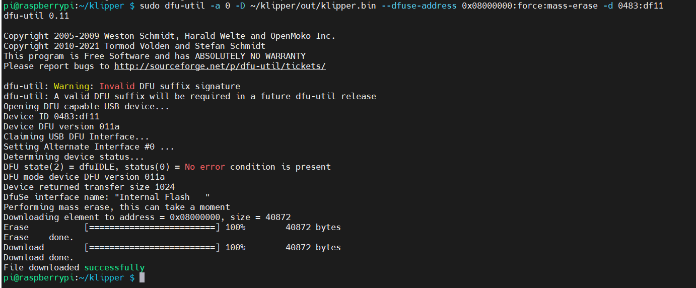

**Author:** ![AlSabra](https://avatars.discourse-cdn.com/v4/letter/a/59ef9b/32.png) [@AlSabra](https://klipper.discourse.group/u/AlSabra)\
**Post date:** [July 22, 2025, 1:35am UTC](https://klipper.discourse.group/t/manta-m5p-flashing-and-running-custom-firmware/24269/29 "2025-07-22T01:35:19Z")
No worries then. Turns out I was able to boot and flash the firmware all fine now after writing to the eMMC again! However, this time I didn’t play around with any of the raspi configs like I did before and I also accepted a prompt to join to the “dialout” and “tty” groups which appears to be necessary for Klipper to access serial ports, which are used to communicate with the 3D printer’s microcontroller. I honestly do not recall this prompt coming up in my previous attempt so maybe when I tampered with the raspi-configs it messed up the usb-serial communication.
Really nice to see and will continue now working towards achieving some basic stepper control and eventually running my own application via moonraker.
