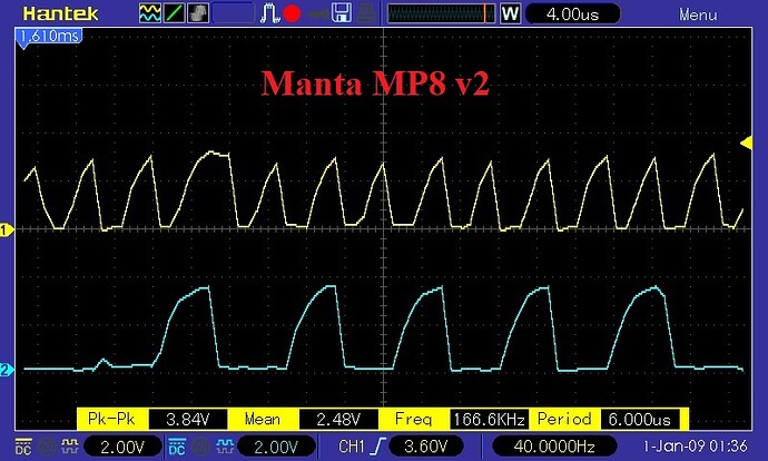

no I’m not trying to connect to EBB 42! I have EBB SB2240 board! but Eddie is connected directly to MANTA MP8 v2 in i2c connector with long cable about 2m
> [@mykepredko](#):
> Try 4k7 pullups on it and keep your lines as short as possible.
The Manta board already has pull-up resistors on the 10kOhm bus! If I add another 4.7KOhm, it will be too much. On the contrary, I need to reduce the resistor rating on the board! But this is very difficult and after changing this port, you will not be able to turn on anything else because it will be configured for this cable length!
there is still a problem! when Eddy is power on
then Knomi loses wi-fi) but Eddy even with such a bad schedule scans the table, but not always) an error appears shutdown: i2c timeout

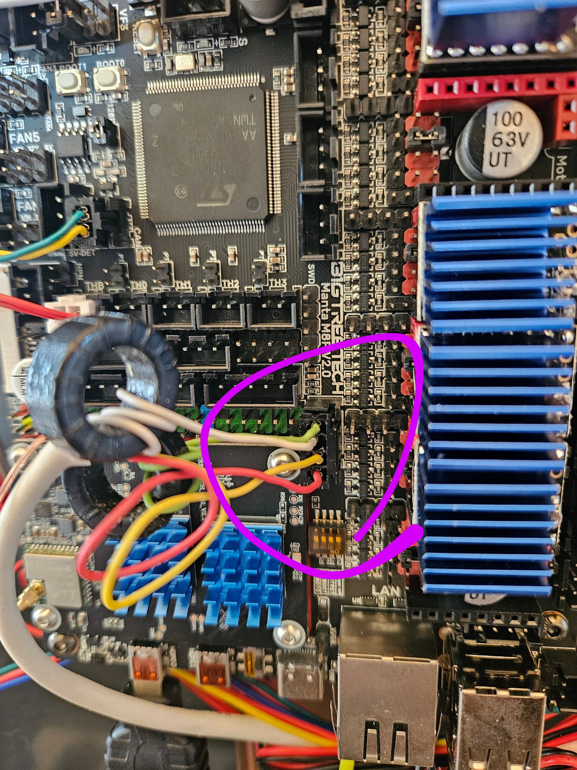

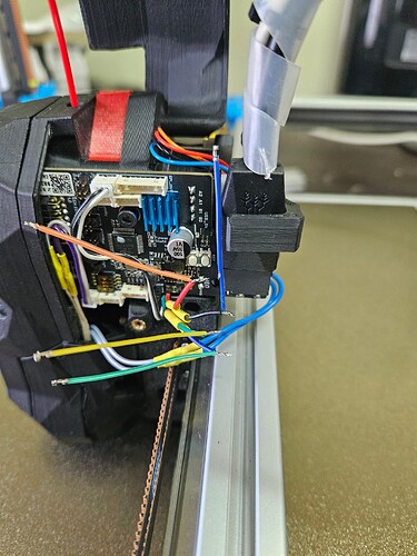

> [@mykepredko](#):

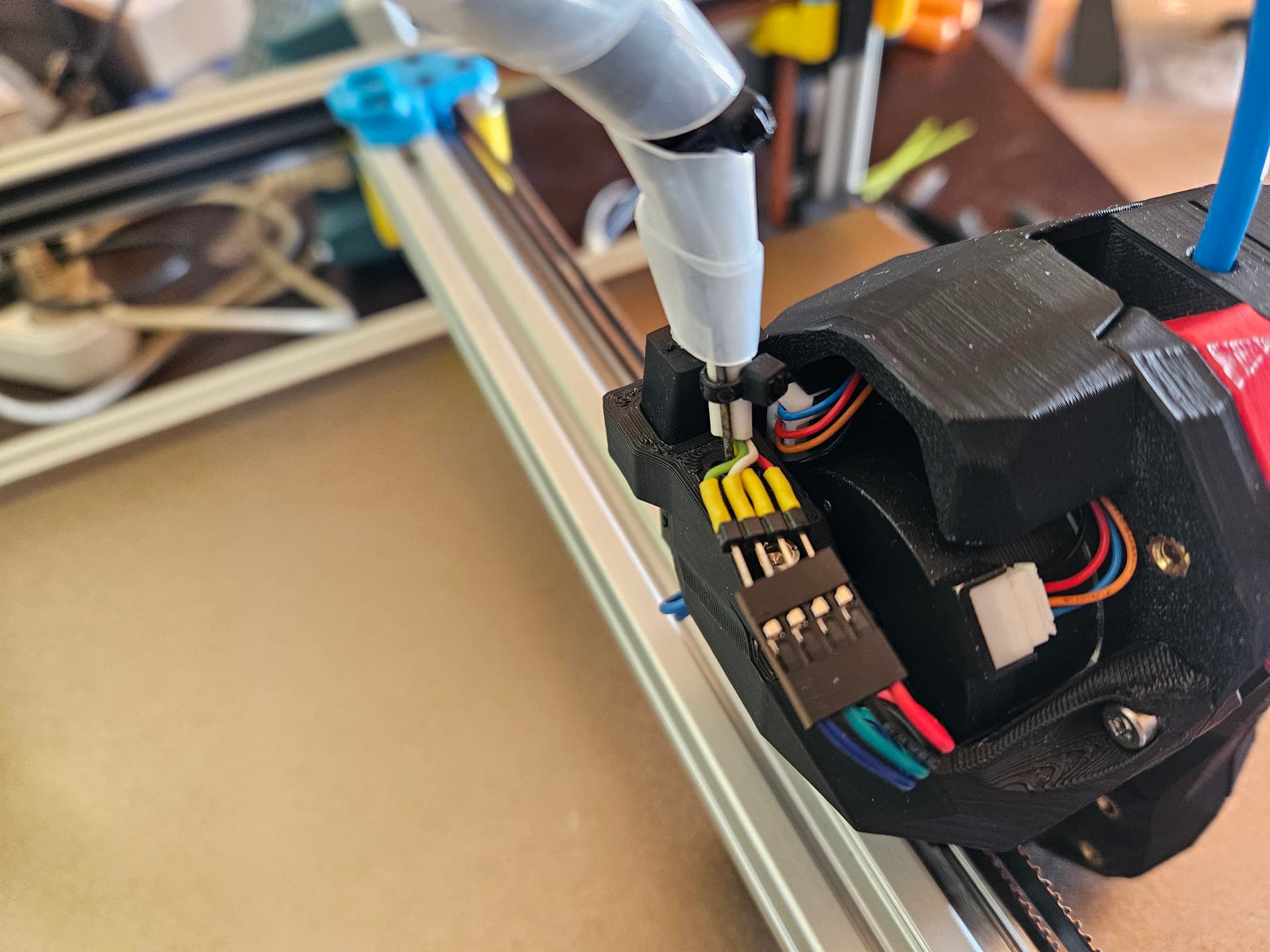

> Can you share pictures of how you’re wiring the connection between the M8P V2 and the Eddy Coil?
 ![20240919_165615~2](https://global.discourse-cdn.com/free1/uploads/klipper/original/2X/b/bb1c255b0a7884b9aac37b0a4d6c74df2dacaa14.jpeg)
 ![20240919_165609](https://global.discourse-cdn.com/free1/uploads/klipper/original/2X/b/bc73328874dacda9bb12a6dc3a72f40308cbbd37.jpeg)
 ![20240919_165531](https://global.discourse-cdn.com/free1/uploads/klipper/original/2X/2/22a875fcd4152321d7929dee03ff4cde510e6ae9.jpeg)
 ![20240919_165523](https://global.discourse-cdn.com/free1/uploads/klipper/original/2X/0/01214c3f1319ebb1c54186f3ea380d9e07527447.jpeg)
**Post date:** [September 19, 2024, 7:29pm UTC](https://klipper.discourse.group/t/manta-mp8-v2-shutdown-i2c-timeout/18892/24 "2024-09-19T19:29:43Z")

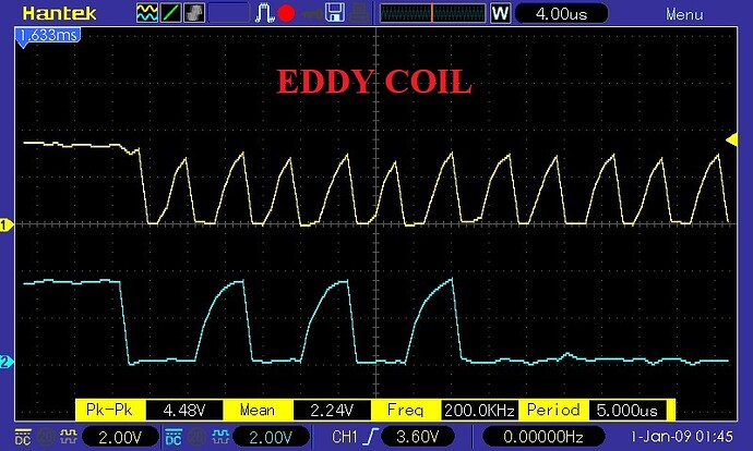

Apologies, I misread the CAN toolhead controller when I did a quick scan of the first post in the thread.
Thanx for the 'scope images at both ends - the way you have things wired, it will never be reliable.

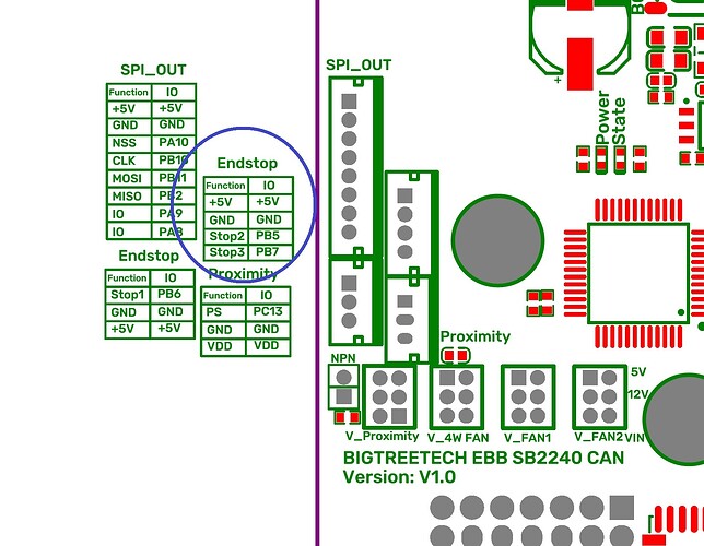

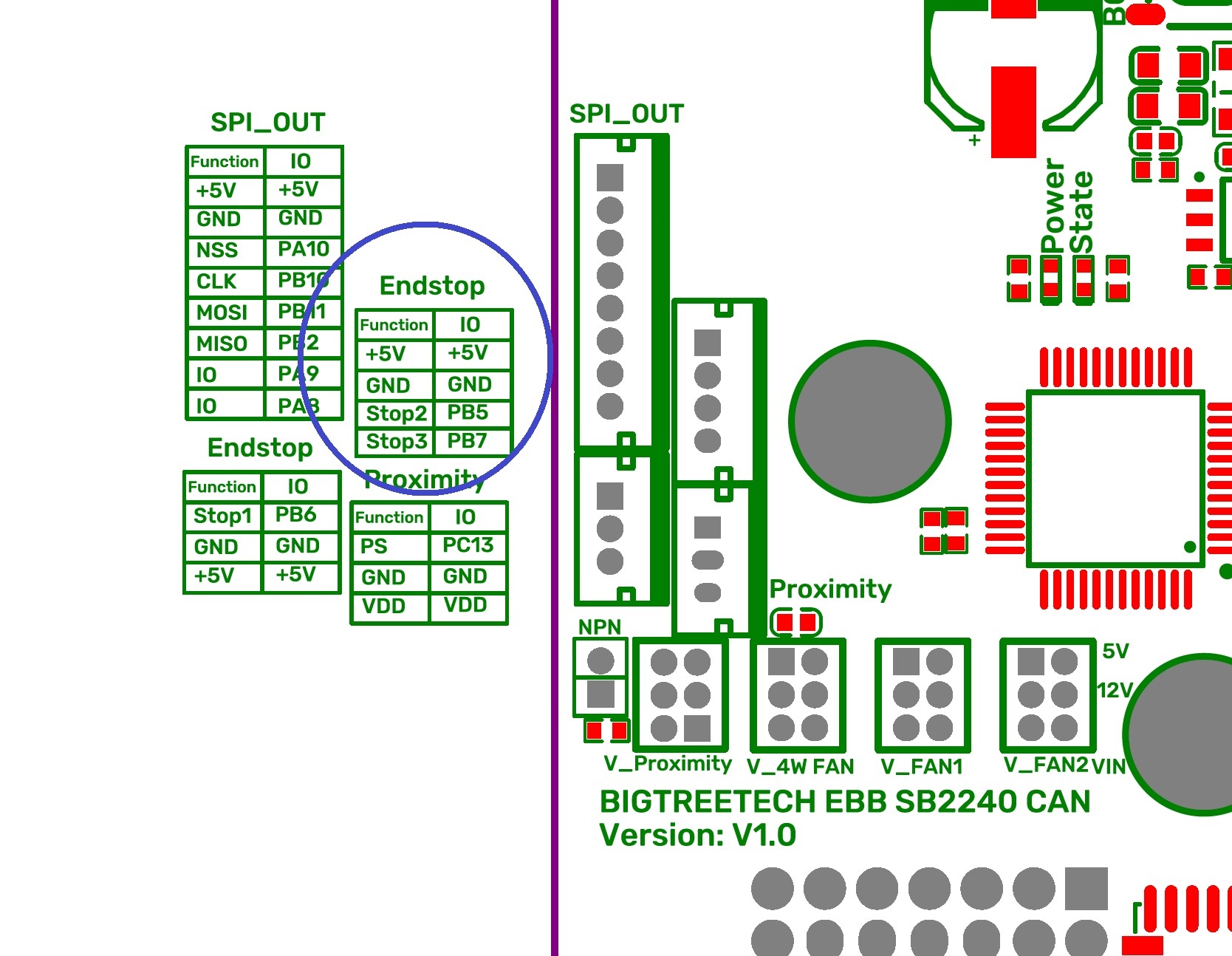

Now, I don’t know how you have your SB 2240 set up, but if you have header P19 open (Endstops 2 & 3) on the board:
![image](https://global.discourse-cdn.com/free1/uploads/klipper/original/2X/7/79818994f602e397b252a37175ba953427c26a32.png)
Then you should be able to wire it as shown in the Eddy Coils User Manual for the EBB42:

If you’re already using P19, then I suggest you look at P5 (BLTouch Connector) but you may want to add a 4k7 resistor to the `SERVOS` line.

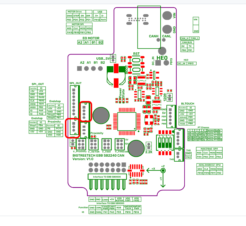

if i understood you correctly! then you suggest
getting rid of the long wire and connecting Eddy coil directly to the EBB2240 board! i thought about it too! but i don’t understand which #i2c\_bus: to choose in the settings! pin PB5 does not support the function i2c
Here are the possible options:
MCU ‘sb2240’ config: ADC\_MAX=4095
BUS\_PINS\_i2c1\_PA9\_PA10=PA9,PA10 BUS\_PINS\_i2c1\_PB6\_PB7=PB6,PB7 BUS\_PINS\_i2c1\_PB8\_PB9=PB8,PB9 BUS\_PINS\_i2c2\_PB10\_PB11=PB10,PB11 BUS\_PINS\_i2c2\_PB13\_PB14=PB13,PB14
BUS\_PINS\_i2c3\_PB3\_PB4=PB3,PB4 BUS\_PINS\_i2c3\_PC0\_PC1=PC0,PC1
 ![endstop_2_3](https://global.discourse-cdn.com/free1/uploads/klipper/original/2X/b/b3916bbea9fe92d4760a1b11d257046db6c2d25b.jpeg)
 ![I2C_2](https://global.discourse-cdn.com/free1/uploads/klipper/original/2X/2/2671506fcd85465b4e5f8d63d303fe66acf2fdac.jpeg)
**Author:** ![borysne](https://yyz2.discourse-cdn.com/free1/user_avatar/klipper.discourse.group/borysne/32/14612_2.png) [@borysne](https://klipper.discourse.group/u/borysne)\
**Post date:** [September 19, 2024, 8:50pm UTC](https://klipper.discourse.group/t/manta-mp8-v2-shutdown-i2c-timeout/18892/26 "2024-09-19T20:50:24Z")
> [@borysne](#):
I think it’s possible to use this Bus pins PB6,PB7
and X axis assign a limit switch pins PB5
or else
> [@borysne](#):
use BLTouch Connector
What do you think, will this work?

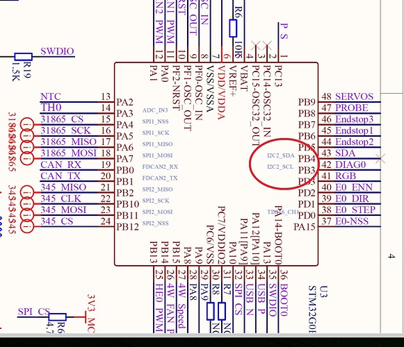

Actually, I’m working on a new board design with the STM32G0B1 (the same as in the EBB SB2240) and PB6/PB7 would be my recommendation **BUT** they will have to straddle two connectors that could be awkward to wire to:
 ![image](https://global.discourse-cdn.com/free1/uploads/klipper/original/2X/d/d1391924dded856664e5f57c7a22298d67802c6a.png)
I suggested Endstop2/Endstop3 as it would be easier to wire and, as I said in my previous post, you would use `i2c_software_scl_pin` and `i2c_software_sda_pin`.
Now, I’ve just taken a look around at what other people are doing and it seems like you get the best results using a hardware I2C port so, if you wanted to use a hardware I2C then PB6/PB7 would be the way to go (which means combining between the two connectors).
I think the best way to wire it would be to use P10 for 5V/GND/Stop1 (PB6 - SCL) and Pin 3 on P19 for Stop2 (PB7 - SDA). Not completely neat but I’ve seen worse as there’s no need for soldering, you just need to make up the cable or modify the one that came with the Eddy Coil (I would probably choose the latter).
PB6/PB7 are the default I2C1 port/bus pins in Klipper.
Once you wire in the Eddy Coil, look at the I2C signals on your 'scope (and show here) to see how the signal has changed (and hopefully improved significantly).

these 1.5mm connectors are a nightmare to crimp! I soldered them) if I can’t do the pull-up programmatically, I can install resistors on these wires!

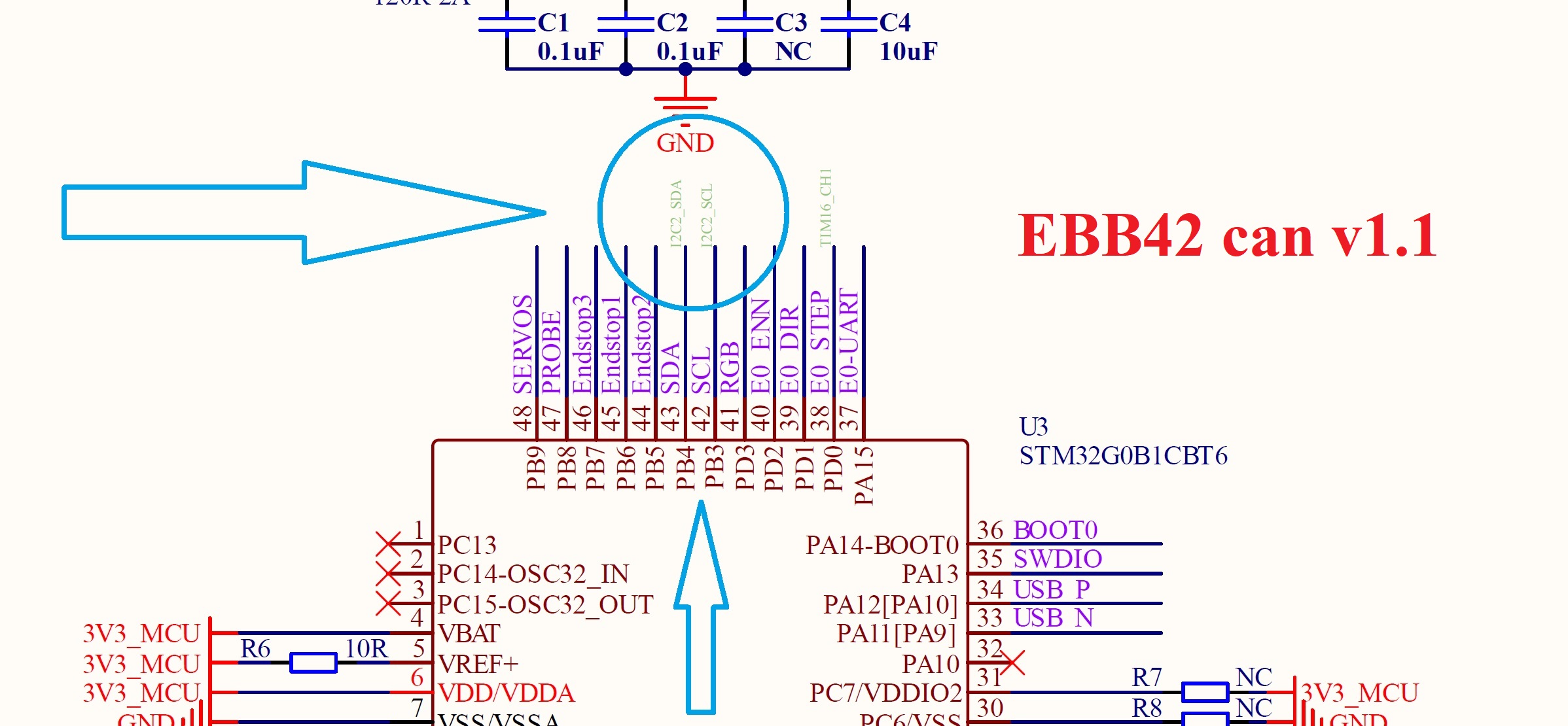

I’m starting to get confused! According to the Klipper BUS\_PINS\_i2c3\_PB3\_PB4=PB3,PB4
to the scheme EBB42 can V1.1 or EBB SB2240 — i2c2\_PB3\_PB4 ???
 ![EBB42 can v1_1](https://global.discourse-cdn.com/free1/uploads/klipper/original/2X/9/91e9306b85c94ab7ebf4ae0a46a6db3738270c7d.jpeg)

When I suggested you use PB6/PB7 on P10/P19 of the SB2240, it was because there are pull ups on the pins already.
Again, looking at the EBB SB2240’s schematic you can see the 10k pull ups:
First off, I’m confused by your use of the EBB42 schematic - I’m going by the EBB SB2240.
The photograph you’re showing looks like the EBB SB2240:
![image](https://global.discourse-cdn.com/free1/uploads/klipper/original/2X/5/5ed931df089e8ee78f96a01338e9755f32117b2a.jpeg)
Regardless, I chose PB6/PB7 as Stop1/Stop2 because:
1. There would probably be nothing else connected to them
2. They came out to a connector (which I understand you have problem crimping to now - sorry, I don’t have a board in front of me)
3. They are the primary I2C bus used by Klipper and the STM32G0B1
I did not choose PB3/PB4 because they are use for other functions on (both the EBB42 and) the EBB SB2240. PB3 is the DIAG0 pin on the TMC driver and can probably be repurposed to being used for the I2C port. PB4 is a no connect on the EBB SB2240 and would be harder to connect to.

I can’t check with an oscilloscope! Because the signal only goes during the command execution! Because of the error, the signal is immediately interrupted!
So as things stand now! I have a connection now
I connected everything as we agreed) there are no additional resistors!!! I removed them
my head board sb2240!
connection:
PB6 - SCL
PB7 - SDA
!!!my config!!!
probe_eddy_current btt_eddy]
sensor_type: ldc1612
z_offset: 1 # Set to a non-zero value
i2c_mcu: sb2240 # MCU name of the actual board connected to Eddy Coil
i2c_bus: i2c1_PB6_PB7 # I2C bus actually connected to Eddy Coil
x_offset:0 # Set actual offset relative to nozzle
y_offset: 20 # Set actual offset relative to nozzle
data_rate: 500
Now I’ll turn on the printer, I’ll get an error and I’ll post the Klipper log
