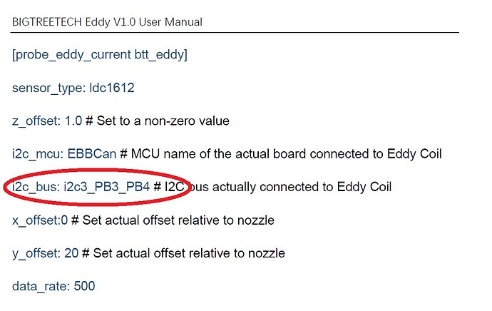

**Author:** ![borysne](https://yyz2.discourse-cdn.com/free1/user_avatar/klipper.discourse.group/borysne/32/14612_2.png) [@borysne](https://klipper.discourse.group/u/borysne)\
**Post date:** [September 20, 2024, 9:36pm UTC](https://klipper.discourse.group/t/manta-mp8-v2-shutdown-i2c-timeout/18892/70 "2024-09-20T21:36:07Z")
I have long noticed some discrepancies in the diagram and in the instructions!! I will send them now
 ![z](https://global.discourse-cdn.com/free1/uploads/klipper/original/2X/3/38ecc7a383372b334e9042d0b66b288d8ee7ac9a.jpeg)
see photo above
i2c2\_SDA – Pin PB4
i2c2\_SCL – Pin PB3
ok Let’s look further at the instructions for Eddy next photo
 ![zz](https://global.discourse-cdn.com/free1/uploads/klipper/original/2X/6/6748bc4abaa228497c64349010c05ecbe191c57c.jpeg)
how can this be explained???

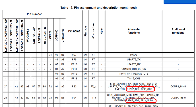

**Post date:** [September 20, 2024, 9:55pm UTC](https://klipper.discourse.group/t/manta-mp8-v2-shutdown-i2c-timeout/18892/72 "2024-09-20T21:55:17Z")
When I look at the datasheet, PB3/PB4 can be used for either I2C2 or I2C3:
 ![image](https://global.discourse-cdn.com/free1/uploads/klipper/original/2X/f/f4fa2d4d3673b0ba9d820f7390b97cff7e7e1a3d.png)
However, when I look at how Klipper configures things, it’s as:
MCU 'sb2240' config: ADC_MAX=4095 BUS_PINS_i2c1_PA9_PA10=PA9,PA10 BUS_PINS_i2c1_PB6_PB7=PB6,PB7 BUS_PINS_i2c1_PB8_PB9=PB8,PB9 BUS_PINS_i2c2_PB10_PB11=PB10,PB11 BUS_PINS_i2c2_PB13_PB14=PB13,PB14 BUS_PINS_i2c3_PB3_PB4=PB3,PB4 BUS_PINS_i2c3_PC0_PC1=PC0,PC1 BUS_PINS_spi1=PA6,PA7,PA5 BUS_PINS_spi1a=PB4,PB5,PB3 BUS_PINS_spi2=PB14,PB15,PB13 BUS_PINS_spi2a=PC2,PC3,PB10 BUS_PINS_spi3=PB4,PB5,PB3 CANBUS_FREQUENCY=1000000 CLOCK_FREQ=64000000 MCU=stm32g0b1xx PWM_MAX=255 RECEIVE_WINDOW=192 RESERVE_PINS_CAN=PB0,PB1 RESERVE_PINS_crystal=PF0,PF1 STATS_SUMSQ_BASE=256 STEPPER_BOTH_EDGE=1
Going back to the EBB SB2240 schematic; “I2C1” is PA9/PA10 (which is the USB port) or PB6/PB7 (Endstops and recommended pins). “I2C2” is PB10/PB11 (the ADXL345 SPI SCK and MOSI pins) or PB13/PB14 (already assigned to the heater and the fan). “I2C3” is PB3/PB4 (No Connect and TMC2240 DIAG0 pin) or PC0/PC1 (which doesn’t have a pin on the 48 pin STM32G0B1 used in the EBB SB2240).
So, when I look at the schematic and how pin are assigned, PB6 & PB7 are not used except as endstops, already have pull ups so they should fit the bill for I2C. PB3/PB4 could be used in a pinch but it will be more work for you with greater probability that you’ll ruin your board. I use Klipper as my reference as to how buses are assigned so it’s either I2C1 with PB6/PB7 or I2C3 with PB2/PB4.
Again, it’s probably best to wait for @nefelim4ag to chime in.

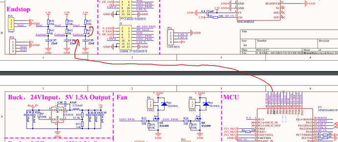

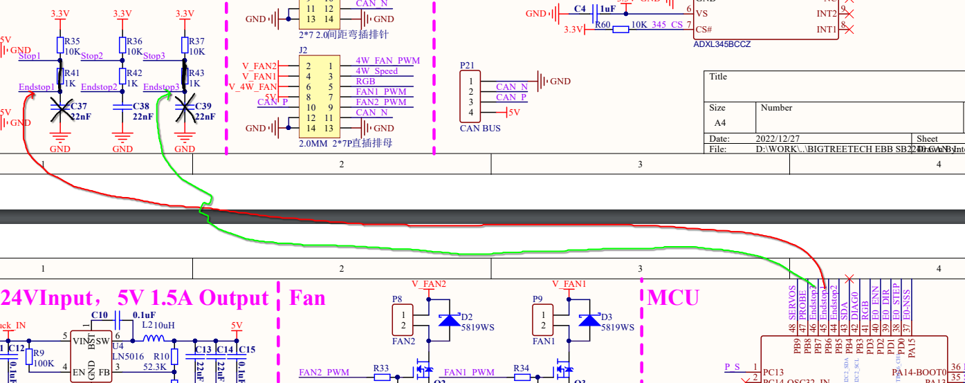

**Post date:** [September 20, 2024, 10:34pm UTC](https://klipper.discourse.group/t/manta-mp8-v2-shutdown-i2c-timeout/18892/74 "2024-09-20T22:34:59Z")
SB2240 according to [schematics](https://github.com/bigtreetech/EBB/blob/master/EBB%20SB2240_2209%20CAN/SB2240/Hardware/BIGTREETECH%20EBB%20SB2240%20CAN%20%20V1.0_SCH.pdf) has STM32G0B1CBT6.
Which is handled in stm32f0\_i2c.c
There are hardcoded timings for F0 ~ 100kHz.
> <https://github.com/Klipper3d/klipper/blob/9574754219932a4fb667f5c6ed33dbf2a7ac20db/src/stm32/stm32f0_i2c.c#L33>
This is commit from logs at [51 message](https://klipper.discourse.group/t/manta-mp8-v2-shutdown-i2c-timeout/18892/51)
So, the configuration looks correct.
From the software side, this board has a slightly higher peripheral clock frequency in comparison to F0, so actual i2c should hardcode to 100 \* 64 / 48 = 133kHz.
Which should not be a problem, because according to LDC1612 datasheet it should support up to 400kHz.
But there is a capacitor connected to the line with 22nF
 ![image](https://global.discourse-cdn.com/free1/uploads/klipper/original/2X/f/f1c41d8a126c27e45d58c9e776f9e73755116cfe.png)
Which are out of spec of i2c by orders of magnitude.

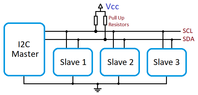

**Author:** ![nefelim4ag](https://yyz2.discourse-cdn.com/free1/user_avatar/klipper.discourse.group/nefelim4ag/32/2387_2.png) [@nefelim4ag](https://klipper.discourse.group/u/nefelim4ag)\
**Post date:** [September 20, 2024, 11:35pm UTC](https://klipper.discourse.group/t/manta-mp8-v2-shutdown-i2c-timeout/18892/79 "2024-09-20T23:35:23Z")
> Do you think that if i remove the capacitors it will give a result?
> or do I need to set a different capacitor rating?
I can only use schematics and my imagination.
According to schematics, there are inline resistors 1kOm, pull-up 10kOm, and capacitor.
 ![image](https://global.discourse-cdn.com/free1/uploads/klipper/original/2X/1/16b25d884a3551e52d3888728b3213838a92dd3d.png)
On I2C capacitance should be minimized, as a consequence capacitors should be removed and ground disconnected on SDA/SCL (endstop3/endstop1) (PB7/PB6).
Inline resistors should “not” add/solve a problem, the line is short, so there, I believe - you can just short them.
Pull-ups can be kept in place.
In the end, it will look like a normal i2c bus, it should work.
 ![image](https://global.discourse-cdn.com/free1/uploads/klipper/original/2X/3/38bdb0e6b2e807531a65116b865ccef438621966.png)
