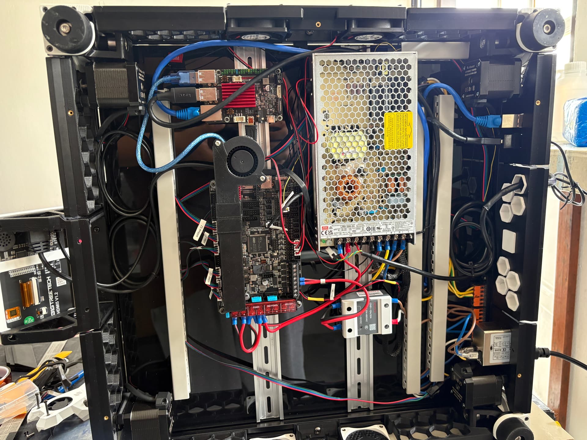

Printer Model: Voron2.4
 MCU / Printerboard: Octopus 1.1
 Host / SBC BTT Pi 1.2
[klippy.log](https://klipper.discourse.group/uploads/short-url/bZoFNZ8jjSLOPYtKsGyljdaGqJi.log) (2.7 MB)
Full log. 40mb.
[klippy.zip](https://klipper.discourse.group/uploads/short-url/1m93carQUgBdRmBq66XKfDxnbcM.zip) (3.2 MB)
_Fill out above information and_ **_in all cases attach your_ `klippy.log` _file_** (use zip to compress it, if too big). _Pasting your_ `printer.cfg` _is **not** needed_
_ **Be sure to check our “Knowledge Base” Category first. Most relevant items, e.g. error messages, are covered there** _
### Describe your issue:
Printer randomly disconnect. Already tried multiple USB cables. BTT’s, short blue shielded cable for ESP32 flashing, and OEM phone data cable. Use contact cleaner to clean surface contact. BTT Octopus(mcu) use klipper fw and toolhead mcu use katapult.

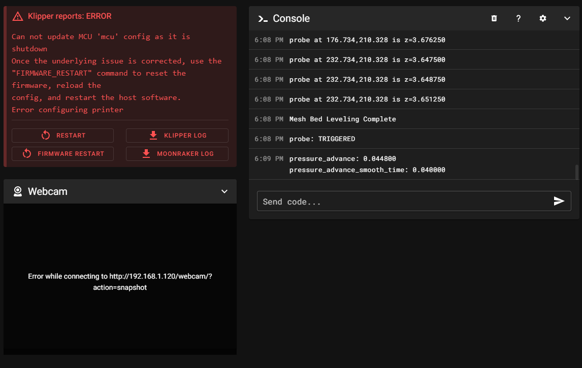

1. It just show MCU disconnect without any explanation.
2. How do I know which file and which line show error?
**Post date:** [July 22, 2025, 7:35am UTC](https://klipper.discourse.group/t/mcu-randomly-disconnect/24321/4 "2025-07-22T07:35:42Z")
Reproduce the issue and take a screenshot, please. Also attach the `klippy.log` directly after the event.

**Post date:** [July 22, 2025, 12:35pm UTC](https://klipper.discourse.group/t/mcu-randomly-disconnect/24321/5 "2025-07-22T12:35:50Z")
![Screenshot 2025-07-22 192840](https://global.discourse-cdn.com/free1/uploads/klipper/original/3X/5/1/510bdfb7138188d359a4fba46834d85fa9eb7ee4.png)
The file is too large to upload on this site so…

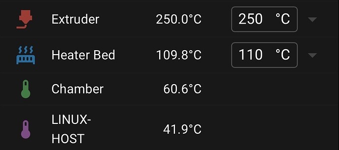

That’s a very very huge klippy.log [MCU randomly disconnect - #7 by erk](https://klipper.discourse.group/t/mcu-randomly-disconnect/24321/7) 😉
My first impression is, you run a very hot system.
 ![temp_sineos_2](https://global.discourse-cdn.com/free1/uploads/klipper/original/3X/e/e/eef13bfba978bf1efb3dbc58e49bb333d9df3c43.png)
MCU-TOOLHEAD: (I guess an EBB) up to almost 90°C! That is amazing. Or I made a mistake!
LINUX-HOST: BTT Pi 1.2 up to almost 66°C. That’s very hot.
MCU-MAIN: Octopus 1.1 over 50°C. I think, that’s ok.
I hope my interpretation is right!
Where did you mount your BTT Pi 1.2? Close to the chamber? How do you cool it?
You should get rid of that.

- I mounted BTT Pi directly to side of the chassis fan
 ![2B1FA73A-561D-4494-8BD2-21B0FE007023](https://global.discourse-cdn.com/free1/uploads/klipper/original/3X/a/7/a748ee179275ce63beab78f5092003ff5177b959.jpeg)

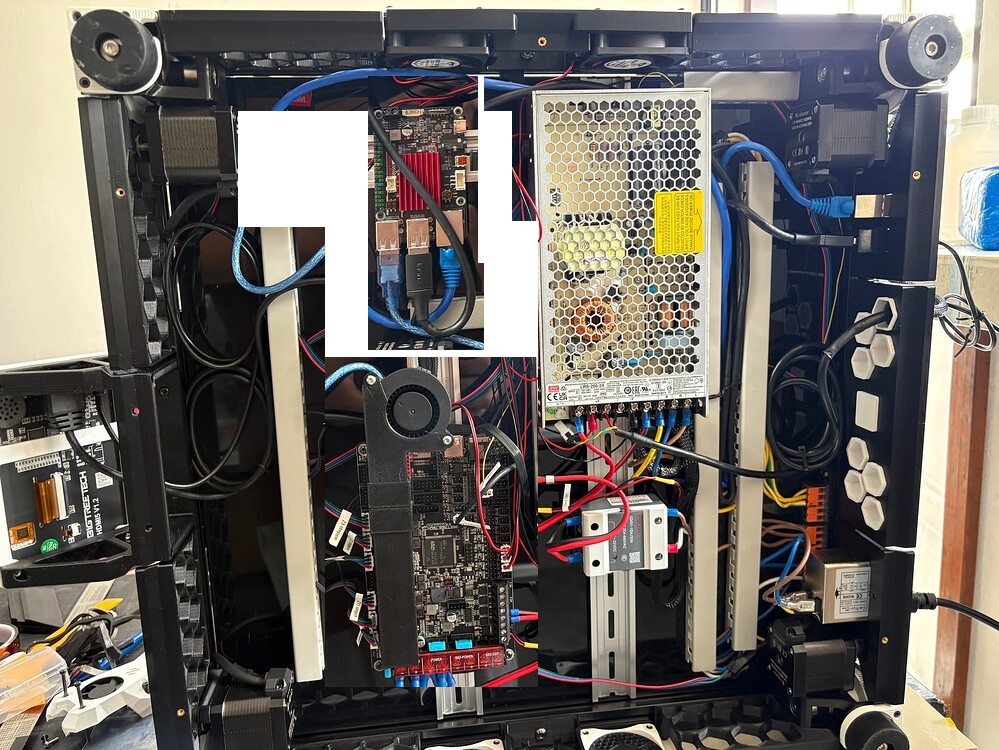

**Post date:** [July 24, 2025, 7:32pm UTC](https://klipper.discourse.group/t/mcu-randomly-disconnect/24321/17 "2025-07-24T19:32:40Z")
Mmmmh, very hot system.
I wonder why your MCU-TOOLHEAD is still working. The temperature is WAY too high.
You could turn the BTT Pi 1.2 90° CCW. You got enough space. I think this would improve the cooling. Also don’t place the USB cable above (or under, depends on the perspective) the heatsink. This also reduces the cooling a tiny bit and you are struggling with every degree 😉
 ![suggestion](https://global.discourse-cdn.com/free1/uploads/klipper/original/3X/e/b/eb9b1ad3f3aa539656149f069f295ef4bff14035.jpeg)
