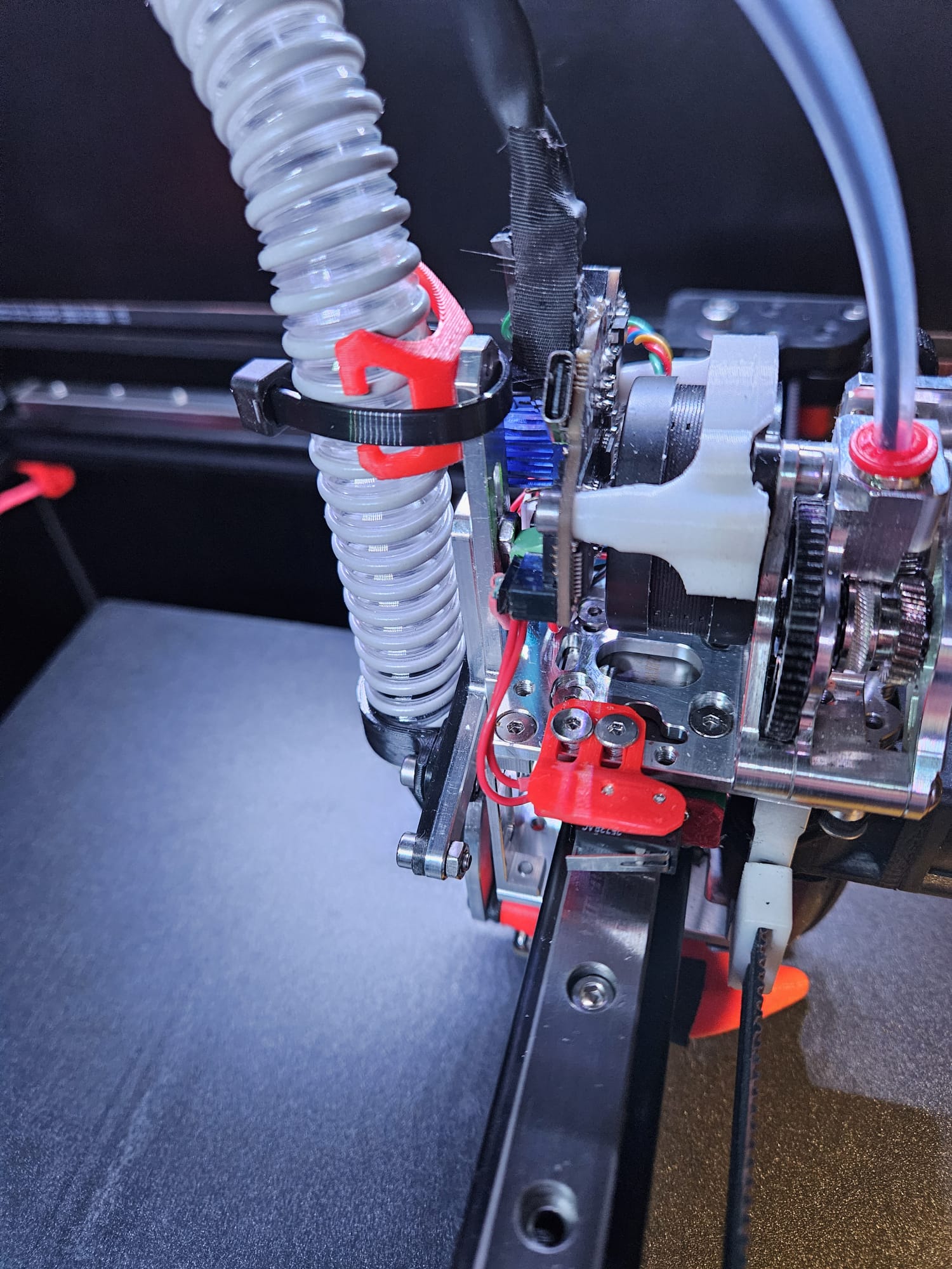

Could you please post a picture how you mounted your EBB?

**Post date:** [March 5, 2025, 5:31pm UTC](https://klipper.discourse.group/t/mcu-shutdown-after-couple-hours/22319/16 "2025-03-05T17:31:29Z")
sure!
 ![IMG-20250305-WA0011](https://global.discourse-cdn.com/free1/uploads/klipper/original/3X/7/e/7e73d1d2656dadda7dfb5634fe1ccee9038b8b00.jpeg)
 ![IMG-20250305-WA0012](https://global.discourse-cdn.com/free1/uploads/klipper/original/3X/a/0/a0a5cf6ff346a6908188462e968426f4e6aa3518.jpeg)
 ![IMG-20250305-WA0013](https://global.discourse-cdn.com/free1/uploads/klipper/original/3X/b/e/be7862dcee235719f367194aeac9f8f4ea94de27.jpeg)
 ![IMG-20250305-WA0014](https://global.discourse-cdn.com/free1/uploads/klipper/original/3X/e/c/ec2225e221a89f5a151c0b5dd1615df4ee554550.jpeg)

**Post date:** [March 5, 2025, 7:09pm UTC](https://klipper.discourse.group/t/mcu-shutdown-after-couple-hours/22319/18 "2025-03-05T19:09:02Z")
> [@Wattie](#):
> sure!
Thanks. I’ll get back on the weekend, cause I would like to go deeper on that (time).

Thanks @Sineos for pointing me in the right direction!!!
I hope everyone that sees this thread and has the same issue can fix it now.
It was a very frustrating issue to find.
