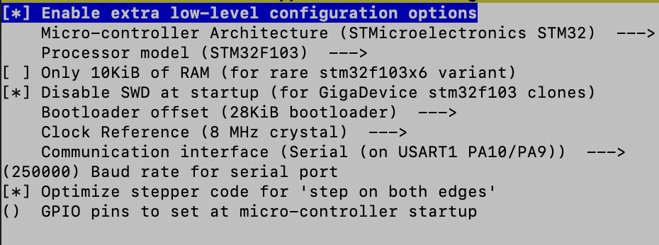

Hey, I tried flashing Klipper on my Ender 3 V2 (board 4.2.2 GD32F303) following the config guide, but no luck.
- Screen is stuck on the Creality logo
- Tried disabling SWD at startup — still not working
- Printer doesn’t show up in the web interface
- 1gb samsung sdcard formated to fat32 with 4096

Did it all the trys
Maybe I do somthing wrong in the make settings look at the image or it’s OK?

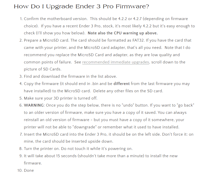

**Post date:** [August 4, 2025, 8:43pm UTC](https://klipper.discourse.group/t/need-help-flashing-ender-3-v2-4-2-2-gd32f303/24483/6 "2025-08-04T20:43:21Z")
Can you go through the process that you’re using to update the firmware?
Please be as precise as possible and list all file names and show what’s on the SD Card.
You should be following the process:
 ![image](https://global.discourse-cdn.com/free1/uploads/klipper/original/3X/d/2/d20f76777b17b11761f829c43c0c60705de29dc3.png)

One thing jumped out at me:
![image](https://global.discourse-cdn.com/free1/uploads/klipper/original/3X/0/9/09ba082fe9eb6576c799068a8e7a0dd0d97ab9f6.png)
Could you try not renaming `klipper.bin` and loading the file as is on the SD Card? I seem to recall that the file name has to be eight characters - your name has nine.

Where did you get the `make menuconfig` settings? Have you tried any others?
You’re using the rPi Zero 2W as your host. How are you connecting it?
**Author:** ![michisha](https://avatars.discourse-cdn.com/v4/letter/m/51bf81/32.png) [@michisha](https://klipper.discourse.group/u/michisha)\
**Post date:** [August 5, 2025, 8:17am UTC](https://klipper.discourse.group/t/need-help-flashing-ender-3-v2-4-2-2-gd32f303/24483/17 "2025-08-05T08:17:30Z")
Yes when i load firmware i get the logo and the screen.
I got the make menuconfig from the config file of ender 3v2 and ender3v2 pro tried all of them
i am connecting the pi like that microusb to usb\> usb to micro usb\> micro usb to ender

> [@michisha](#):
> Interface: `USB (on PA11/PA12)`
This is definitely wrong. Needs to be `serial (on USART1 PA10/PA9)`
**Post date:** [August 5, 2025, 11:22am UTC](https://klipper.discourse.group/t/need-help-flashing-ender-3-v2-4-2-2-gd32f303/24483/19 "2025-08-05T11:22:58Z")
about the usb interface it was misspelled look at the picture
the only discusion i saw is here [Support for new Creality boards 4.2.2 with GD32F303 - #28 by fklco](https://klipper.discourse.group/t/support-for-new-creality-boards-4-2-2-with-gd32f303/3016/28?page=2)
