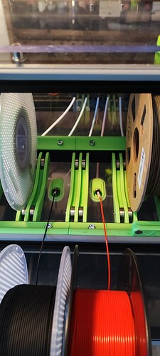

Btw, this is my current solution:
 ![IMG_20240222_080844](https://global.discourse-cdn.com/free1/uploads/klipper/original/2X/8/8270a36d5af155005d95b56b0acbdac351e2f107.jpeg)
 ![IMG_20240222_080820](https://global.discourse-cdn.com/free1/uploads/klipper/original/2X/c/c7438abf32c3bf55d34a708a3a6f411420d5a96a.jpeg)
Logically, the rollers will get replaced in v2
Behind the box is the ERCF and the puffer from the ERCF v2, that i wanna get rid of

Mechanical Setup:
2 3030 Extrusions as Frame (And a Box with lots of silica around it)
3D-Printed Spacers to hold bearings and axels
693ZZ Bearings, with 3mm Steel Rods, that Hold 3D Printed Rollers
R280 DC Motoren 3-6V - Cheap, may they work, may they don’t.
the gearing from the Bambu First stage Feeder rebuild-\>[printables.com](http://printables.com) (the only reason i need to change direction)
Electronics:
Maybe a RP2040 Plus board as mcu
Either PWM Motor Drivers (DRV8871 won’t work i figured out. wrong Voltage range)
Or Buck Converters(I like that Idea) - But since we have 3 Brains here, one telling PWM is doable without noise, i may should give it a try.
Well, thanks to thisiscam, i got some code. It definitly needs some adaptions, but its a start, i appreciate that.
I really don’t wanna rush the electronics decision, there are many ways to do that and many things to keep in mind. All in all i think its a good idea too keep it simple enough to enable others to rebuild it. There’s a big difference between a non Programmer, a Programmer and a good Programmer.
Btw, my Name is Sebastian. I’m a He, since i’ve read some unsure therms
