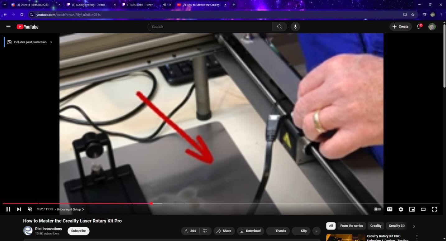

I happened to have won a Creality Rotary add-on for a new Laser Engraver they were promoting.
But when it came in, I went to take a picture for a shout out to @CrealityA1FalconLaser
When I snapped this photo, my mind went to another place.., but I put the idea off untill I saw this post; and decided now is good time as any.
After review of the instructions, it seems its just a standard stepper, 1:1 on the chuck. The connection is simply done by unplugging the Y stepper from the engraver, and using thier extension cable to connect it.

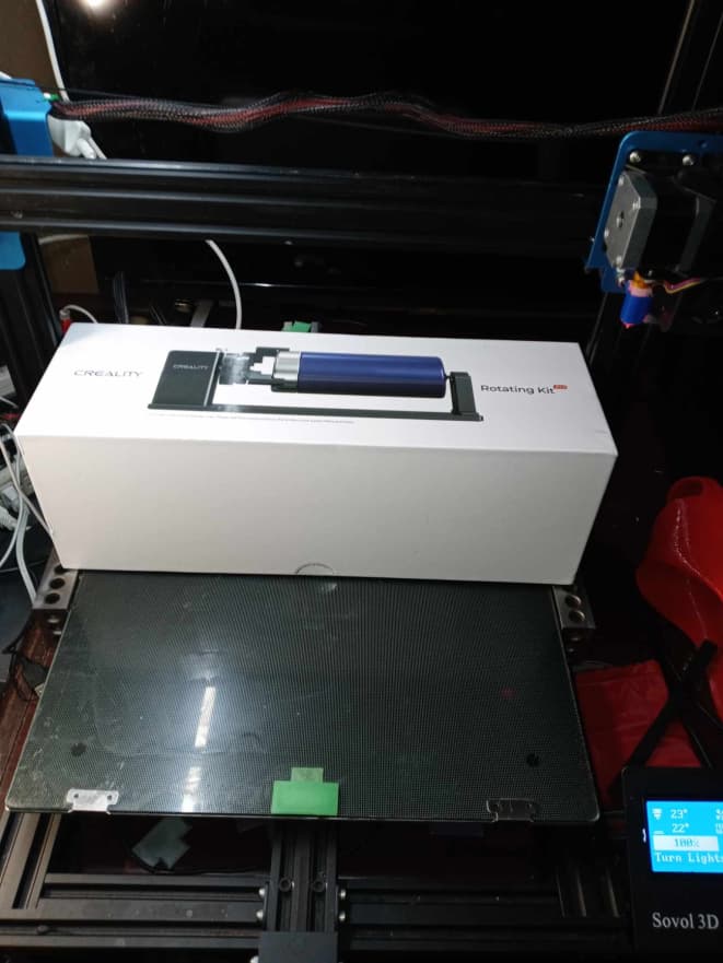

So… this project is going on is a Sovol SV03, 350x350x400
It has a Creality 2.2.1 motherboard with 5 drivers, and was intialy setup as X,Y,Z,E0,Z1
I was able to setup the new Rotary at the bed center and chose the biggest cylinder that I could find that it can hold.
My first thought was using the dual Z ports on the board to “syncronize” the Y movements. it worked slightly. But I couldnt control them independantly of course. Reading where mandela64 spoke of running out of steppers…
I happend to have a spare Creality 2.2.1 board, So I moved the Y stepper and endstop along with the Rotary stepper and configured the following

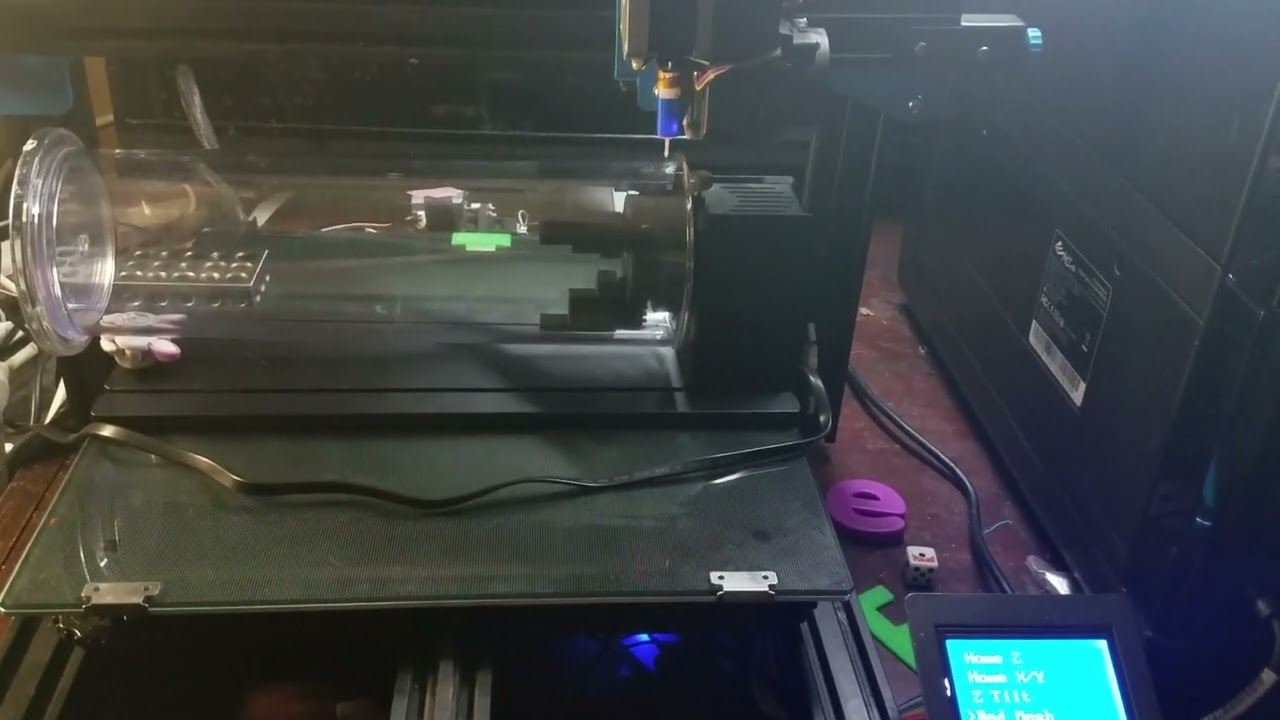

The key is the Rotation distance for the Rotary. It needs to match the size cylinder’s circumference. The piece I’m using for protyping is not the best.
but the vase is ~360mm in Circumference" which coincidentially matches the size of bed it now rests on. So I set the rotation distiance to 360.
To utilize the dual carrige, I first start with the Z gantry already raised above the rotary and issue a home X and Y. Y1 then also homes after Y is done (although I’d prefer it not to need an endstop at all.)
But for now I’m manually triggering the endstop for Y1 (I will model an endstop mount in the near future.) I then issue the command
SET_DUAL_CARRIAGE CARRIAGE=1 AXIS=Y MODE=COPY this syncronizes the Rotary to the Bed and moves the Rotary to under the probe.
Homing Z then with [safe_home] placing the Z probe at the center of the Cylinder.
Once homing is complete. I set the Rotary carrige (y1) to primary. SET_DUAL_CARRIAGE CARRIAGE=1 AXIS=Y MODE=PRIMARY
This locks down the bed and sets the Rotary active for all Y motion.
I then run a z_tilt_adjust, this probes both ends which levels the gantry to the Cylinder (This removes the minor taper from end to end)
once complete, I run a new home z as always. and then of course run the mesh.
Once the mesh is done, I issue the command again to set the rotary to copy mode.
Then manually move the Bed/Rotary so the nozzle is over the cylinder.
one last command to set the rotary back as primary. and is now ready for printing… well soon anyways…

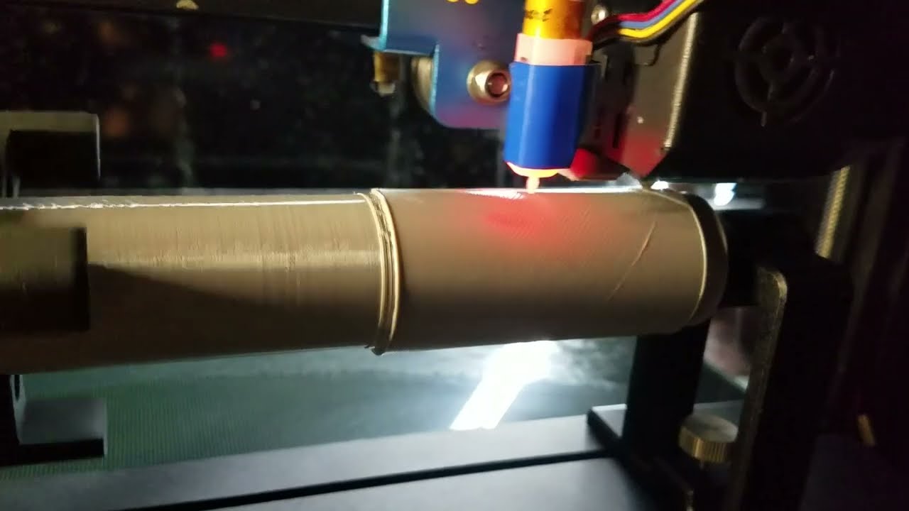

It’s working!! I printed a 100mm(circ) cylinder first on the normal bed. And then mounted it on the Rotary and printed a 60x70x2mm flattened cube as a test.
