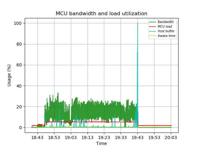

**Author:** ![jakep\_82](https://avatars.discourse-cdn.com/v4/letter/j/ea666f/32.png) [@jakep\_82](https://klipper.discourse.group/u/jakep_82)\
**Post date:** [April 6, 2022, 4:30pm UTC](https://klipper.discourse.group/t/possible-threading-issue-in-klippy/2492/11 "2022-04-06T16:30:02Z")
Here’s the stat graph. Not sure what’s happening, but you can see the problem at the end.
![Stats](https://global.discourse-cdn.com/free1/uploads/klipper/original/2X/0/03ef07ba35260d3d51a4155a3996e7a3e81237b2.png)
**Author:** ![koconnor](https://avatars.discourse-cdn.com/v4/letter/k/aca169/32.png) [@koconnor](https://klipper.discourse.group/u/koconnor)\
**Post date:** [April 6, 2022, 4:30pm UTC](https://klipper.discourse.group/t/possible-threading-issue-in-klippy/2492/12 "2022-04-06T16:30:21Z")
There are some tools you can use to analyze the Klipper log (details at [Debugging - Klipper documentation](https://www.klipper3d.org/Debugging.html#generating-load-graphs) ). For example, your log shows ( `scripts/graphstats.py klippy-3.log -s` ):
 ![load](https://global.discourse-cdn.com/free1/uploads/klipper/original/2X/b/bdf920bc18d94093e952dd642634e9cbe2b04f92.png)
The host cpu is clearly struggling to keep up during the entire duration (blue system load average is regularly above 100%). It’s actually fairly impressive that Klipper ran as long as it did. Ultimately, it looks like you also went into memory swap (note the decreasing yellow line) which finally killed it.
FWIW, low end host cpus aren’t a target for me. I don’t know of anyone currently working on it.
