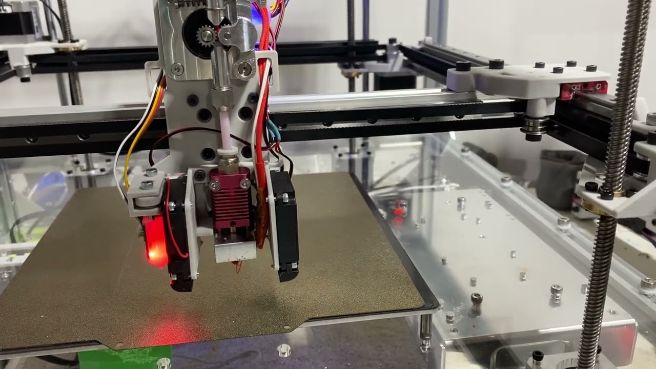

After getting homing operations working with sensorless homing (see: ), I now find that every time I try to print, the toolhead moves outside of the print range as shown here:
[![](https://global.discourse-cdn.com/free1/uploads/klipper/original/2X/c/c783d5098d4882943fc7cad261268a7e9df0ec81.jpeg "Print operation moves outside of print envelope") ](https://www.youtube.com/watch?v=lKj-afez6aw)

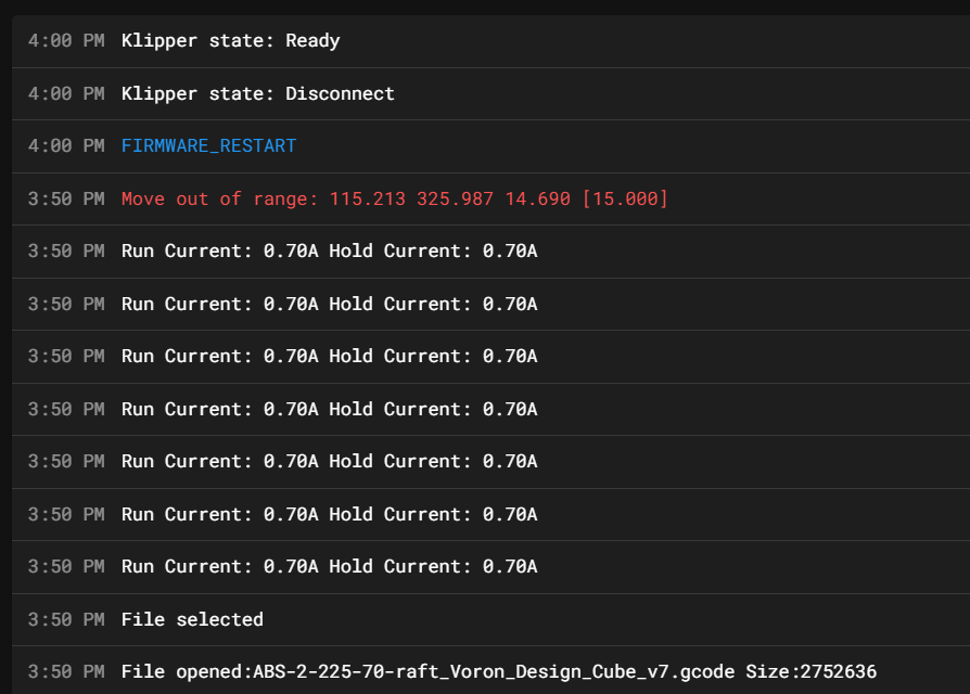

Everytime it executes, I get the error message Move out of range:
 ![image](https://global.discourse-cdn.com/free1/uploads/klipper/original/2X/8/88e830570a18bef8159ed116d2e6cfa0a238d09b.png)
This is for multiple gcode files (I’ve attached one I just built to see if there was a version issue) and I’ve power cycled the machine. The only options selected in Cura was to produce the thumbnails so the design is displayed on Mainsail.

Have you tried adding G90 to your start gcode to explicitly set absolute coordinates?
**Post date:** [February 3, 2023, 3:03am UTC](https://klipper.discourse.group/t/problems-with-printing-after-getting-homing-working/6374/4 "2023-02-03T03:03:22Z")
Nope. What will that do exactly?
I’m trying it right now…
**Author:** ![jakep\_82](https://avatars.discourse-cdn.com/v4/letter/j/ea666f/32.png) [@jakep\_82](https://klipper.discourse.group/u/jakep_82)\
**Post date:** [February 3, 2023, 3:07am UTC](https://klipper.discourse.group/t/problems-with-printing-after-getting-homing-working/6374/5 "2023-02-03T03:07:10Z")
G90 tells the printer to interpret gcode moves as absolute positions. G91 tells the printer to interpret move commands relative to the current position.
**Post date:** [February 3, 2023, 3:13am UTC](https://klipper.discourse.group/t/problems-with-printing-after-getting-homing-working/6374/6 "2023-02-03T03:13:19Z")
Sorry, where do I put it?
The current initial code is:
; myke's Custom CoreXY Start G-code
G92 E0 ; Reset Extruder
G28 ; Home all axes
; #### Put G90 here?
G1 Z2.0 F3000 ; Move Z Axis up little to prevent scratching of Heat Bed
G1 X0.1 Y20 Z0.3 F5000.0 ; Move to start position
G1 X0.1 Y200.0 Z0.3 F1500.0 E15 ; Draw the first line
G1 X0.4 Y200.0 Z0.3 F5000.0 ; Move to side a little
G1 X0.4 Y20 Z0.3 F1500.0 E30 ; Draw the second line
G1 X5 Y20 Z0.3 F5000.0 ; Move over to prevent blob squish
I’m guessing after the `G28` as I’ve marked in the comments above?
**Post date:** [February 3, 2023, 3:15am UTC](https://klipper.discourse.group/t/problems-with-printing-after-getting-homing-working/6374/7 "2023-02-03T03:15:02Z")
That should be fine.
**Post date:** [February 3, 2023, 3:21am UTC](https://klipper.discourse.group/t/problems-with-printing-after-getting-homing-working/6374/8 "2023-02-03T03:21:00Z")
That seems to have fixed the problem.
Thanx!
