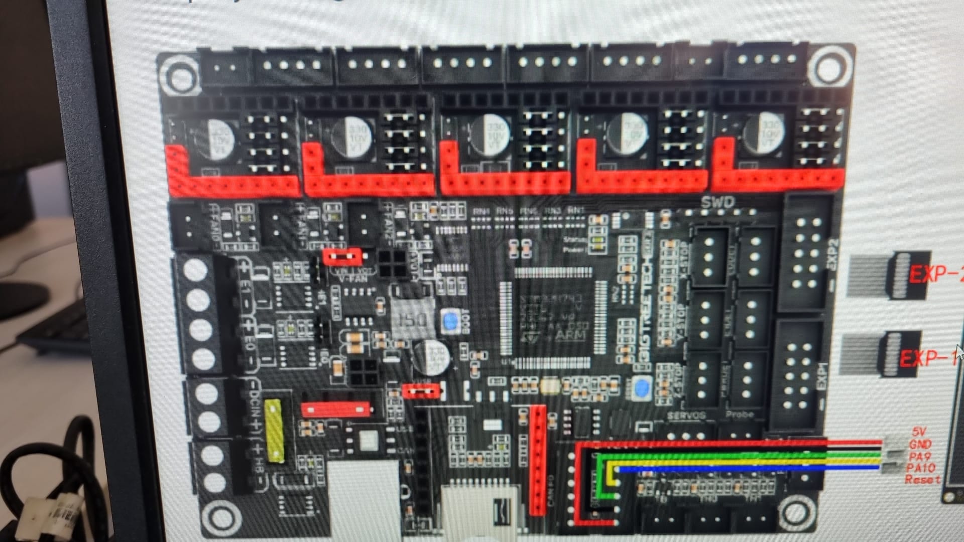

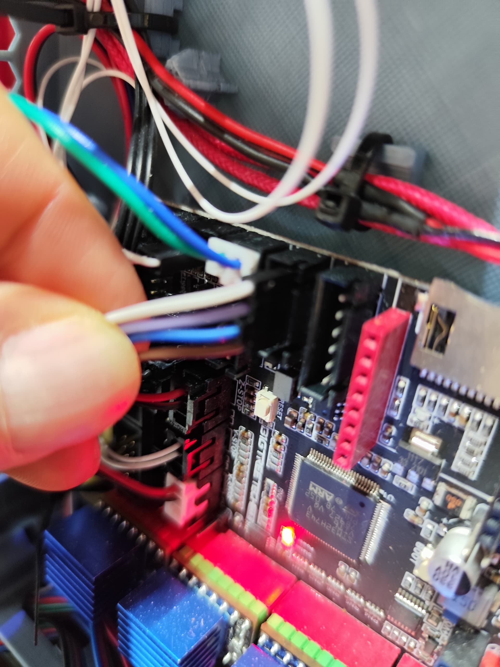

4
 ![skr3 pin](https://global.discourse-cdn.com/free1/uploads/klipper/original/3X/0/d/0d3929358037b1e3b5fcc03d031f1b6051baae42.jpeg)
I built a box for the printer to hold both the SKR3 and the Pi1, but the USB cable went around the outside, and if I accidentally bumped it, the Raspberry Pi would turn off. I hope I’ve been clearer so that you can help me in some way.

> 4 → Image from a website
Not what I was asking for. I wanted to see the cable and how it connects to the SKR 3 and the Raspberry Pi.
Serial connections are a lot harder to set up and get working reliably than USB ones; I can say that with experience.

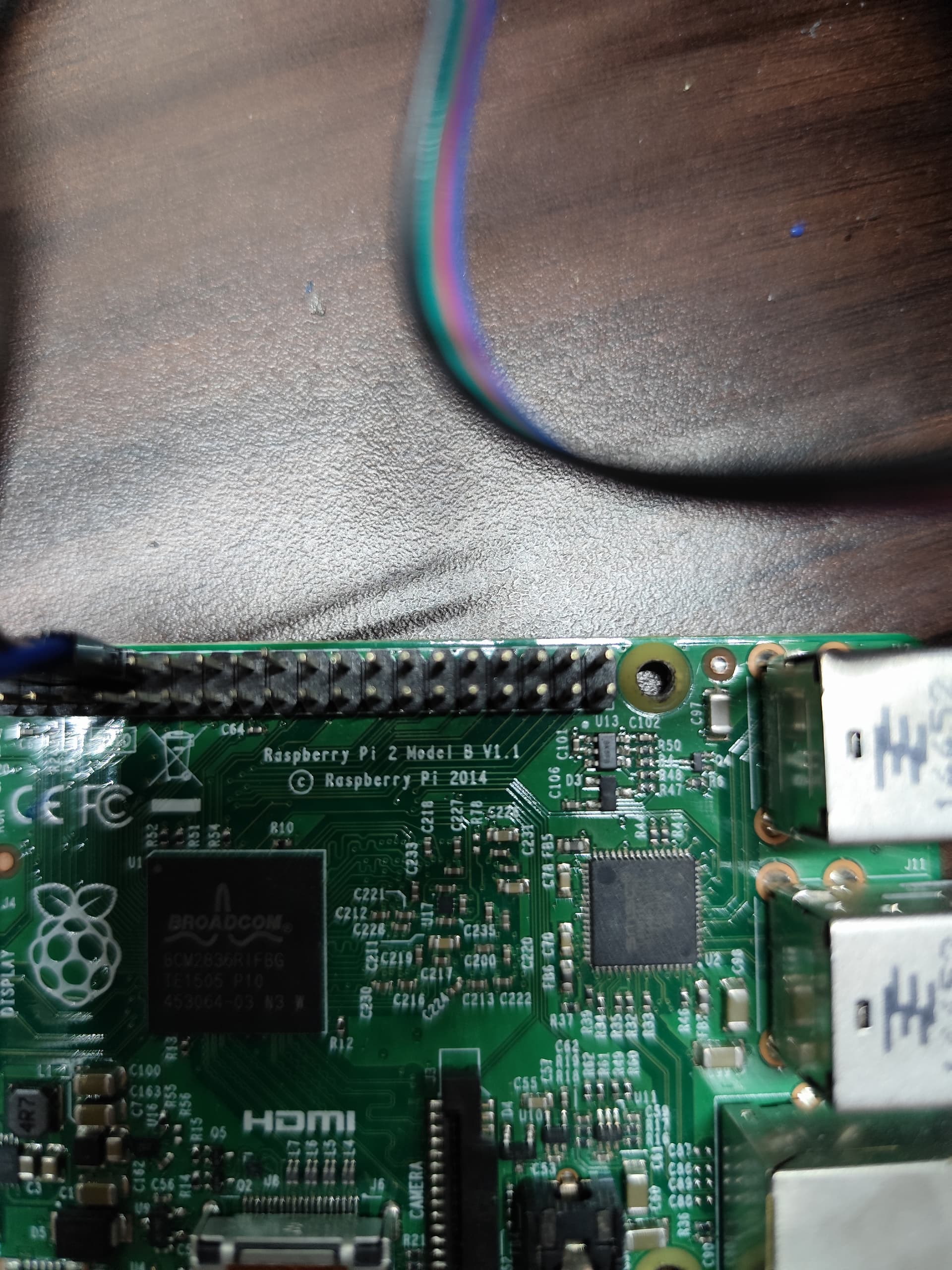

**Author:** ![hfintegrale](https://avatars.discourse-cdn.com/v4/letter/h/71e660/32.png) [@hfintegrale](https://klipper.discourse.group/u/hfintegrale)\
**Post date:** [July 2, 2025, 9:07pm UTC](https://klipper.discourse.group/t/problems-with-usart1/24093/7 "2025-07-02T21:07:19Z")
My fault, the Raspberry is a Pi 2 from 2014. I just found out now that I took the picture.

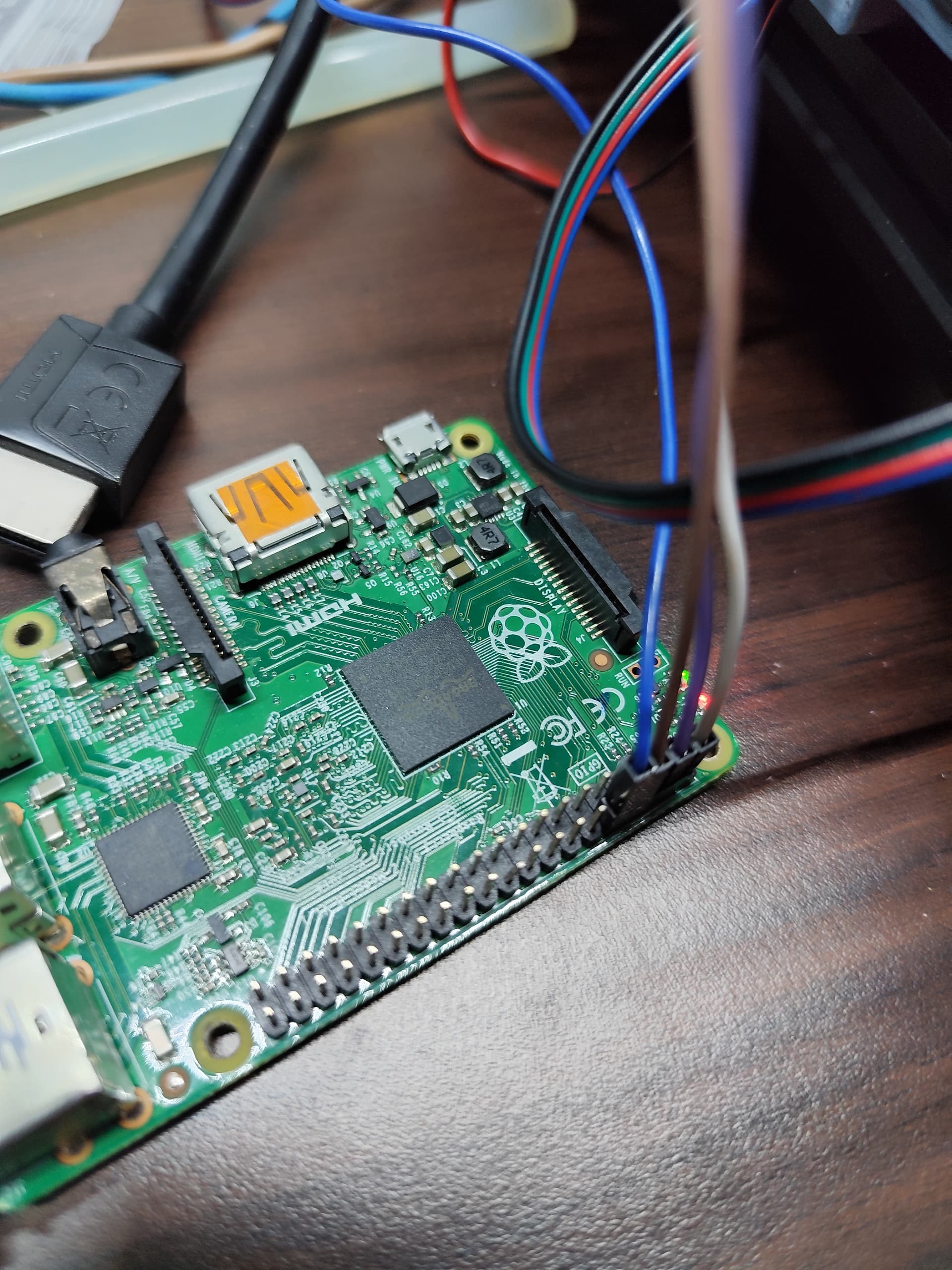

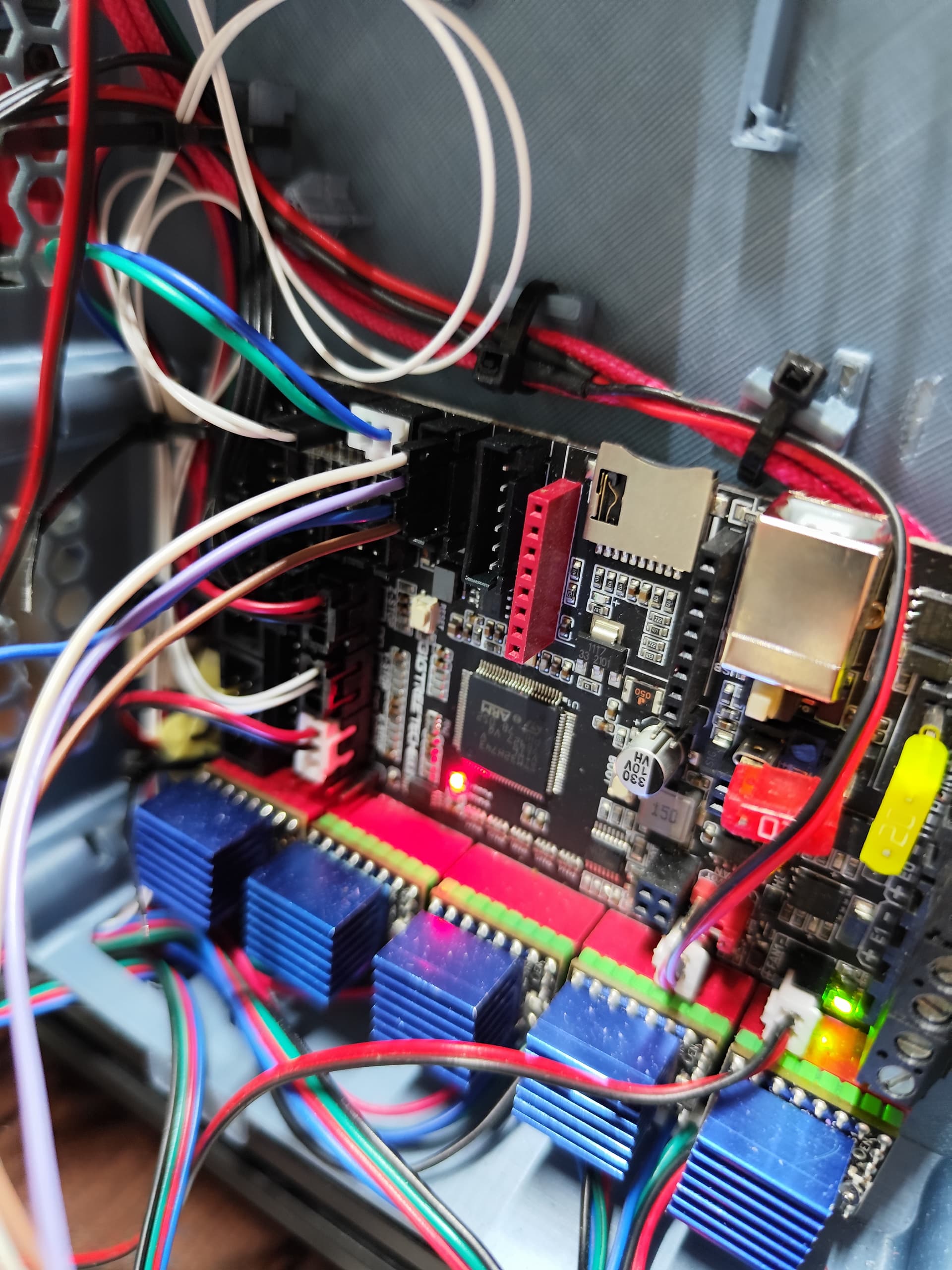

![IMG_20250702_223707](https://global.discourse-cdn.com/free1/uploads/klipper/original/3X/d/3/d3c15ed78a0121ed9a6d9215b4ef2c5559e87a0b.jpeg)

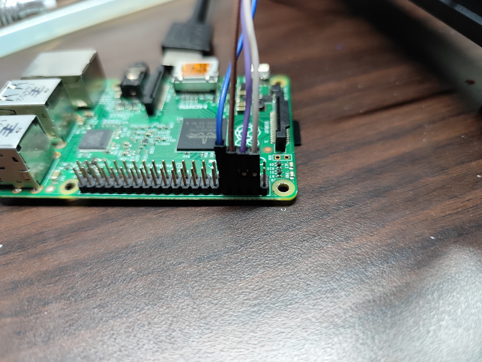

![IMG_20250702_223715](https://global.discourse-cdn.com/free1/uploads/klipper/original/3X/0/c/0c22da4ba61af365e265e18ed05ac561dee5dc54.jpeg)

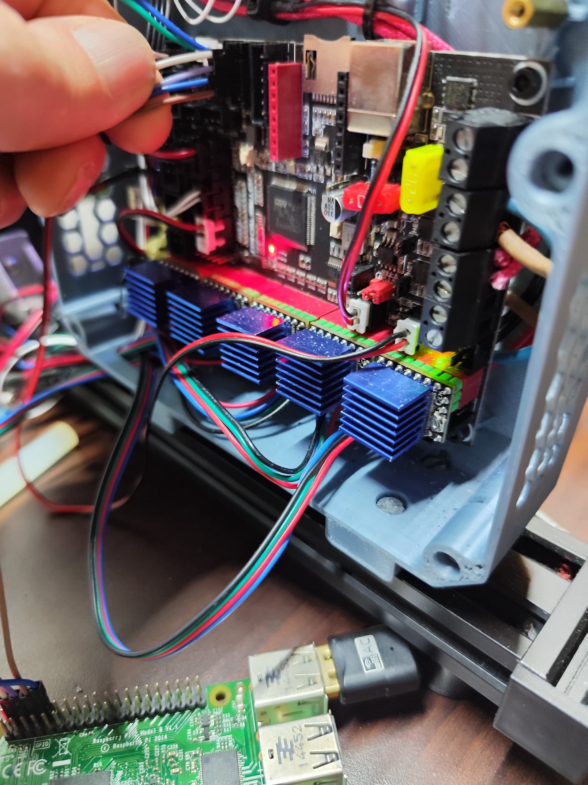

![IMG_20250702_223718](https://global.discourse-cdn.com/free1/uploads/klipper/original/3X/a/5/a5707b0361c68694542cb2c022b6eb4ba4f7fe16.jpeg)

**Post date:** [July 3, 2025, 1:43am UTC](https://klipper.discourse.group/t/problems-with-usart1/24093/14 "2025-07-03T01:43:55Z")
That’s really helpful - that’s what I’m looking for.
Now, it looks like you’re powering the Raspberry Pi 2 from the BTT SKR 3 board. Is that correct?
If it is, could you disconnect the 5V line to the rPi and power it from a Raspberry Pi power supply? Leave the other three lines (GND, RX & TX) in place.
I am wondering about the draw the Raspberry Pi 2 (and WiFi adapter) has on the SKR 3 5V power supply. If it’s too great, then it may cause the MCU on SKR 3 to brown out, leading to the problems that you’re having.

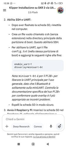

Problem solved, with the help of a good mentor who found that the uart port had to be enabled with two strings to be added to the config.xtx file

Could you post the text from the picture above? I guess it’s Italian. Go\*gle translator might help 😉
**Post date:** [July 25, 2025, 7:02am UTC](https://klipper.discourse.group/t/problems-with-usart1/24093/21 "2025-07-25T07:02:13Z")
You are right
UART Connection Setup on Raspberry Pi
The Raspberry Pi 2B+ has a UART interface (GPIO 14 TXD and GPIO 15 RXD) that needs to be enabled and configured.
- Disable serial console and enable serial port:
  - Connect to your Raspberry Pi via SSH.
  - Edit the config.txt file:
sudo nano /boot/config.txt
  - Add the following lines to the end of the file:
enable\_uart=1
dtoverlay=miniuart-bt
  - Look for any line that might disable the serial port and comment it out or remove it:
  - Save the file (Ctrl+O, Enter, Ctrl+X).
  - Edit the cmdline.txt file:
sudo nano /boot/cmdline.txt
  - Locate the text console=serial0,115200 or console=ttyAMA0,115200 and remove it completely. Your line should look something like this:
console=tty1 root=/dev/mmcblk0p2 rootfstype=ext4 elevator=deadline fsck.repair=yes rootwait quiet splash plymouth.ignore-serial-consoles
  - Reboot your Raspberry Pi:
sudo reboot
