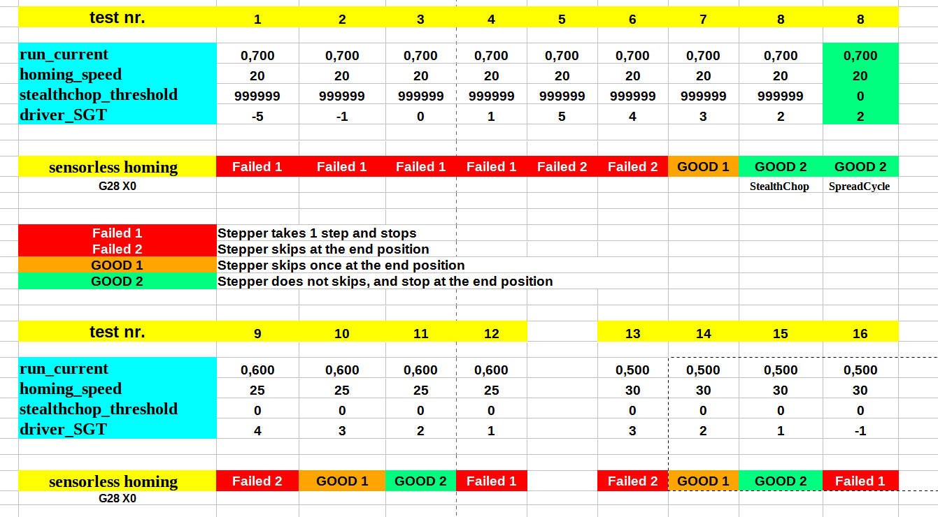

**Post date:** [November 13, 2023, 8:25pm UTC](https://klipper.discourse.group/t/sensorless-homing-with-the-tmc-2240-drivers/11438/45 "2023-11-13T20:25:28Z")
@DrumClock
Just looking at your table:
 ![image](https://global.discourse-cdn.com/free1/uploads/klipper/original/2X/9/9dbb24d75ff445fdeaf6f71309ab98de2c114d7a.png)
and I was thinking you might want to expand your variables a bit - try 0.6A for your run\_current and 25 for your homing\_speed.
These are the values that I am using and I’m getting a better range of values where StallGuard works instead of the single value that you’re getting.
**Author:** ![DrumClock](https://yyz2.discourse-cdn.com/free1/user_avatar/klipper.discourse.group/drumclock/32/177_2.png) [@DrumClock](https://klipper.discourse.group/u/DrumClock)\
**Post date:** [November 14, 2023, 6:30pm UTC](https://klipper.discourse.group/t/sensorless-homing-with-the-tmc-2240-drivers/11438/46 "2023-11-14T18:30:05Z")
HI @mykepredko ¨
so I did more tests and it’s the same, just too sensitive.
the best combination is marked “green”
-Petr
 ![image](https://global.discourse-cdn.com/free1/uploads/klipper/original/2X/3/3c1507a090e5614597a10385bdb4b05c2f37beae.png)
**Post date:** [November 14, 2023, 6:32pm UTC](https://klipper.discourse.group/t/sensorless-homing-with-the-tmc-2240-drivers/11438/47 "2023-11-14T18:32:44Z")
Interesting that the chip is that sensitive to only have one working value for sensorless homing.
I don’t know what else to say other than I’m happy things are working for you.
