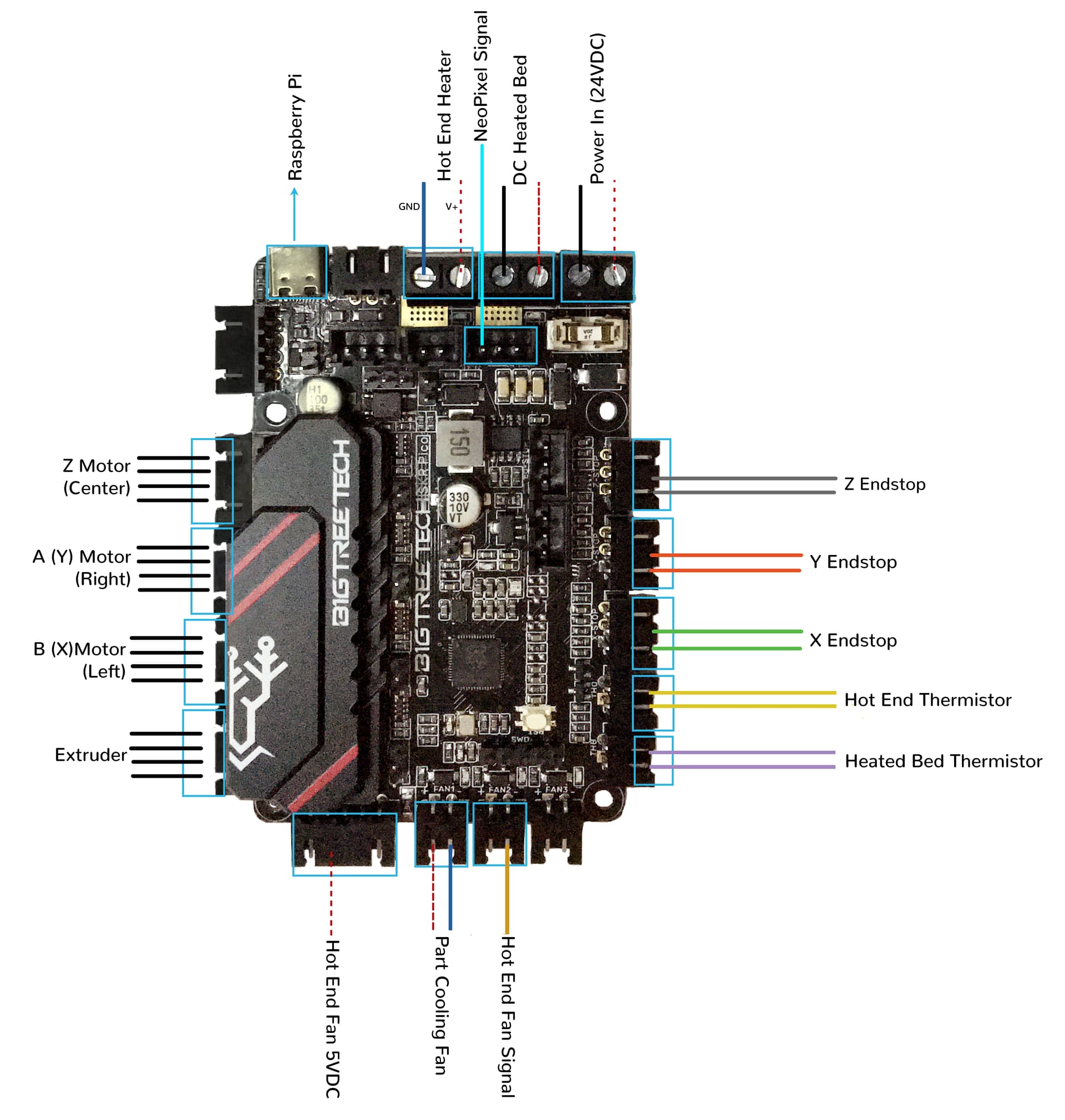

SKR Pico fans don't work just heat up
SKR pico
orangepizero2w
… After days of problems installing mainsail i finaly was able to make it work
When was The time creating The printer.cfg, everything eles worked except The fans
I tested some Settings and nothing worked, they fans just heat up a lot and don’t rotate
I tested de out voltage with a multimeter and it’s 24.11v and then fan is 24v so I don’t see where they problem is

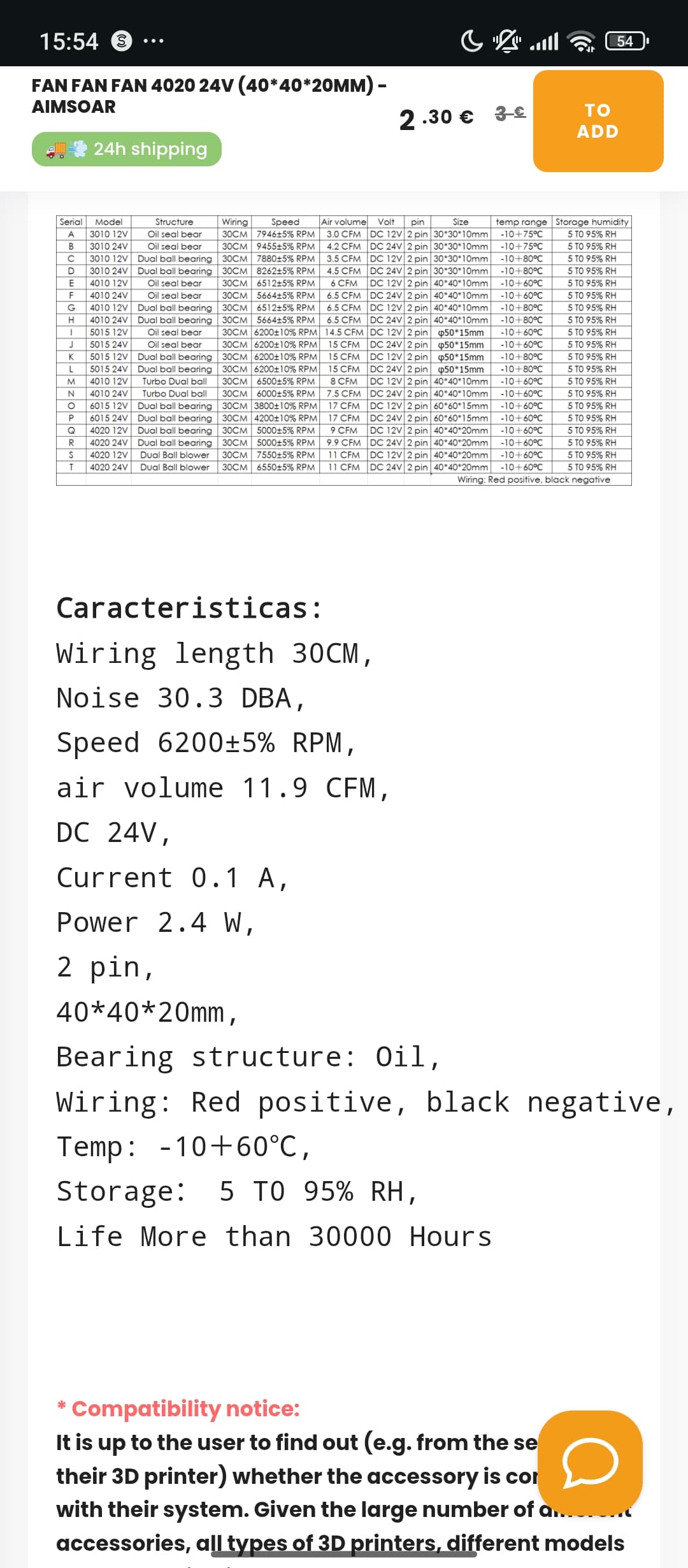

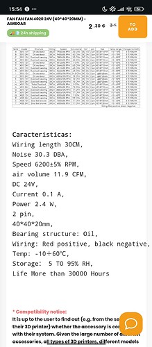

What is the manufacturer name and witch type are those fans?
A link to the datasheet is appreciated :winking_face_with_tongue:
2 pin fans, positive and negative , fans are from aimsolar 24v oil fans
Now searching they fan specs I think I can tweak they printer cfg file , the max power of the fan to match the fan specs
Try:
  1. Disconnect the fans.
  2. Set the fan’s output to fully on.
  3. Use a digital multimeter to measure the voltage across the relevant pins.
If the DMM does not read 24 V, then either your pin definition is incorrect (although it appears to be correct) or your board is faulty.
Datasheet was best wish.
What is written on the label of your fans? A photo would help.

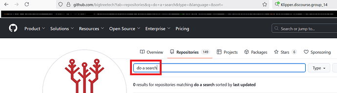

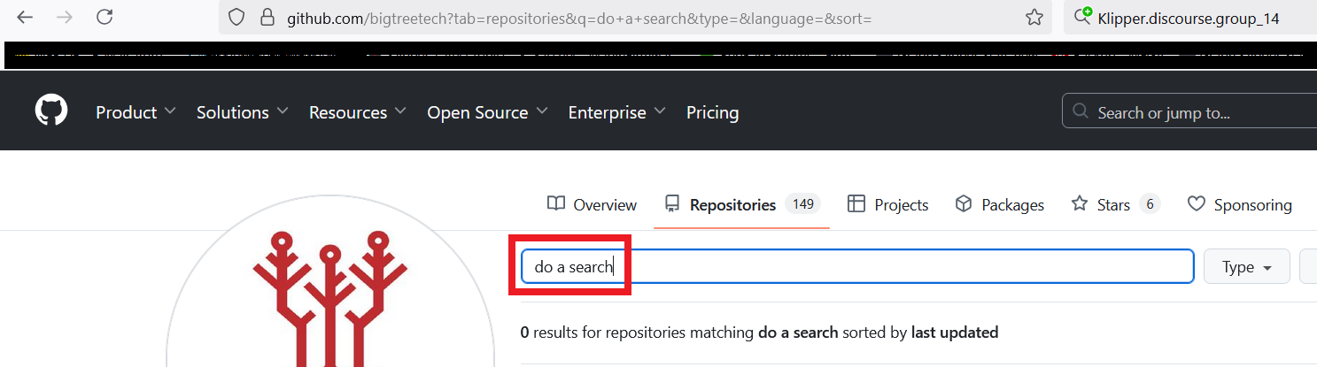

finally after some time , i found an image that solves the issue
I completely misunderstood you, sorry.
If you need information about any (well, I guess not all) Bigtreetech (also known as BTT) products go here and do a search (_oo_gle search would give you of course the same results)
If you would have searched for “pico”, you would have ended here GitHub - bigtreetech/SKR-Pico.
In the “directory” Hardware you’ll find the files you were looking for.
