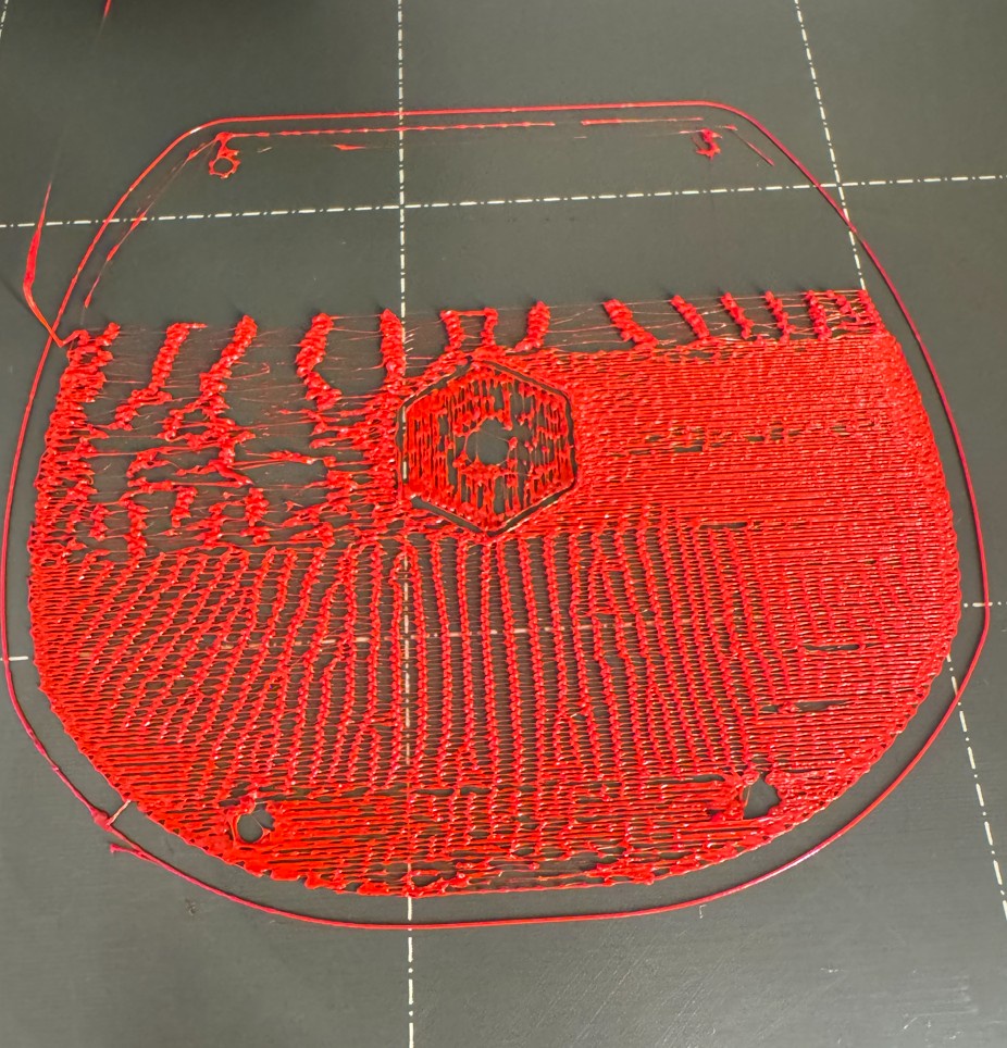

Hello, there had been stability issue with my phone connecting to Klipper. So, I went to Update Manager in mansail from the browser and updated the firmware. Not sure if this is related but since last night, it cannot even print the first layer properly. Done first layer calibration many times and washed the PEI sheet each time I printed. Changed the nozzle and filament but same net-like first layer. Anybody knows what is wrong and how to fix it?
[klippy\_netlike\_firstlayer.zip](https://klipper.discourse.group/uploads/short-url/midvW8iAXasrlf7PnyOSEZ5uAZt.zip) (207.9 KB)
[https://imgur.com/a/rUhFLKQ](https://imgur.com/a/rUhFLKQ)

I can put the imgur image here on @printeruser 's behalf:
 ![rMP6pHA](https://global.discourse-cdn.com/free1/uploads/klipper/original/3X/6/8/6830be275c92fd7bbad8042046c63f736a4e707f.jpeg)
To me, this looks like a clogged nozzle.

At first I thought it could be a clogged nozzle. I changed to another one but same thing happened.

If the nozzle is clogged it is mostly not caused by the nozzle.
Most times there is a gap between the nozzle and the heatbreak where the molten filament escapes, cooles down and solidifies and sooner or later blocks the whole way through the hotend.
Besides the main topic it looks like you are either a bit too far away from the bed or the first layer flow is to small or maybe even both.
How much filament did you extrude on the request of @3dcoded?
Looks like the first few cm might be fine and the more it extrudes the less comes out.

I pressed “Load filament” once and sometimes twice and it extruded consistenly.
Now, there is a bigger issue. I tried to print another thing that used to work but it also failed. Instead of filling in the first layer, it printed in strips. I noticed one bad thing. Even I loaded the filament before starting the print job, during the 1st priming stage (when the nozzle moved from right to left), almost no filament was extruded. When it moved from left to the x-axis position where the print object starts, it extruded filament. I tried again. Pressed Load Filament to load it. It extruded consistently. Then during the first step of the priming, no filment was extruded. I could easily pull the filment out from the hotend. The printer did not even try to grap the filament when I tried to pull it out during printing. When I tried again and no filament was extruded after priming, I pushed the filament down by force and it was extruded. So what is wrong?
