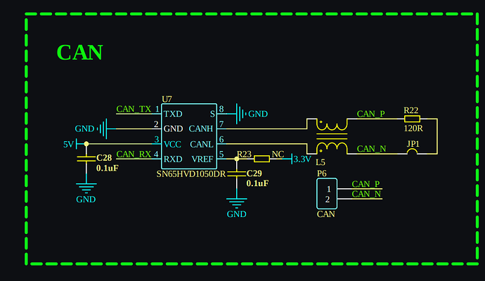

Thanks for the help.
From what I understand the octopus has termination already present and the ebb36 has a jumper pin to enable the resistors. If I measure between CANH/L I get 60ohms on both ends and between CANH/GND and CANL/GND I get 120ohms, so I think that is in order.

From what I read on EMI mitigation (mostly from a Lincoln electric doc on cnc plasma cutters), shields should be drained on one side only to earth with as low resistance as possible, so that is what I did. Since then I also tried draining it to the octopus 24VGND/PSU 24VGND, none of which behaved differently.

From other issue tickets and threads I noticed a lot of instances of this error originating because of fault SBC storage (SD/eMMC).
I’ll try running the system with the OrangePi R1 plus LTS with a new SD card and a clean install to rule out the rpi3 being faulty and keep the thread posted.

Can being a Bus, the termination is supposed to be on the physical ends of the Can H/L pair. Termination resistor function is to suppress signal reflections. Their manual you linked above shows that one should extend the bus past the termination resistor, so to me there will be _some_ reflections, question is if it matters…
` R=MCU===============EBB=R===Eddy`
To test, you could connect the bus lines from the MCU to eddy instead of EBB and keep the existing connection between eddy and ebb36:
` R=MCU===============Eddy====EBB=R`
**Author:** ![nefelim4ag](https://yyz2.discourse-cdn.com/free1/user_avatar/klipper.discourse.group/nefelim4ag/32/2387_2.png) [@nefelim4ag](https://klipper.discourse.group/u/nefelim4ag)\

> [@bozzo](#):
You’re right. However when I tested the same exact setup on the Manta M8P v2+rpi cm5 I have had 0 errors, not on eddy, ebb, nor the mcu. Also per the [Esoterical CANbus guide](https://canbus.esoterical.online/troubleshooting/termination_resistor_info.html) it shouldnt be that big of an issue. Also, further patches applied bellow mitigated my problem entirely, so I’m confident to say that it wasnt a problem of signal reflections.
