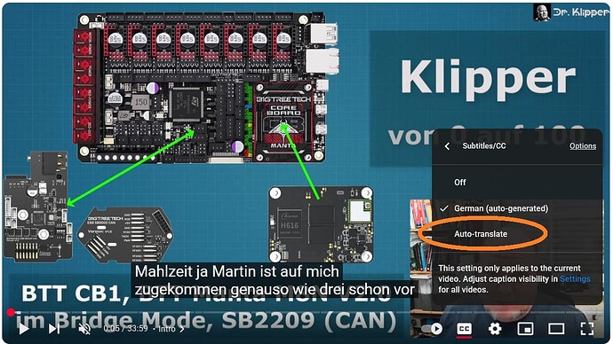

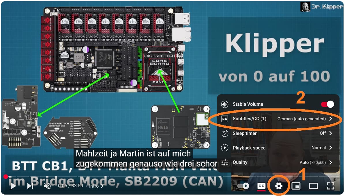

Next try. G\*\*gle You\*ube (use Subtitles/closed caption (c))
 ![1a](https://global.discourse-cdn.com/free1/uploads/klipper/original/3X/1/a/1ac27a7caeb2f8b4b4d83c25b4382c222b198497.jpeg)
 ![2a](https://global.discourse-cdn.com/free1/uploads/klipper/original/3X/8/a/8a4e46000e7c9c053763cd06b10e22e081cf75bb.jpeg)
Then choose your language.
