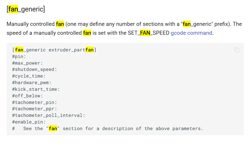

2. When copying in a list, use the “Preformatted Text” tags:
 ![image](https://global.discourse-cdn.com/free1/uploads/klipper/original/3X/8/f/8fd7c2771618a10241184d80ba49c2a0b6708e85.png)

Can I ask why you’re defining this pin as an LED and not a fan using something like:
 ![image](https://global.discourse-cdn.com/free1/uploads/klipper/original/3X/7/4/746492803ba5587e28619842c20a693502370d10.png)
On the Octopus, PB11 is the “HE3” (Extruder Heater) output.
In your comments, you’re saying that “PB11 is negative turn on source” - what do you mean by that? When the MCU’s PB11 pin is high/positive, the N-Channel MOSFET of HE3 (which is what PB11 controls) will be on and the pin will be effectively tied to ground. If PB11 is low (negative) the transistor will be in a high impedance state.

I am turning on the power to my CPAP Fan using a Heater control. "Negative to turn on source is my shorthand for it switches on the Ground and not on VCC.
I control the speed of my CPAP from my PI (GPIO26) and if I don’t want the fan at full speed during boot I need to turn the power off to the CPAP control board. Then turn it on when I am using it.
Edit for clarification. With the HE3 I am not trying to control speed. I just want to turn it on or off. That is why I used LED. If memory serves I tried FAN at first and was getting some unexpected behavior, so I used LED instead.
