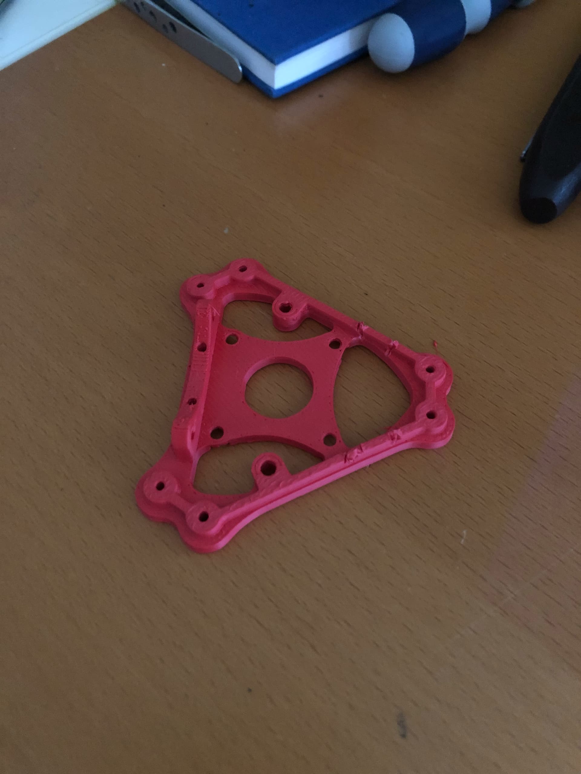

MCU ‘mcu’ shutdown: Timer too close
working Git version: ‘v0.10.0-107-g913d0992’
failing Git version: ‘v0.10.0-122-gc179db3d’
FLSUN QQ-S pro (delta kinematic)
Klipper host: 64bit x86\_64 with 2 cores, AMD E-350 Processor, 2.8 GB
MCU mcu: MKS Robin Mini (FLSUN QQ-S Pro)
MCU Bluepill: Bluepill (PT100 Sensor)
Stepper driver: TMC2209, serial connection
Limits (timer too close) for simple moves:
v0.10.0-107: Klipper bails out at “G28; G0 Z10 F55000”
v0.10.0-122: Klipper bails out at “G28; G0 Z10 F120000”
Nevertheless, v0.10.0-122 fails doing a simple print (max. 80mm/s)
The identical gcode worked fine with v0.10.0-107.
Only workaround I found so far was to change microsteps from32 to 16 for all three axes.
[klippy.zip](https://klipper.discourse.group/uploads/short-url/rWESpZPVwaZBG635U0a3QlP2DwZ.zip) (42.5 KB)
 ![IMG_7394](https://global.discourse-cdn.com/free1/uploads/klipper/original/1X/f2486db72285781a61804284c0412d4950a2256b.jpeg)
 ![IMG_7395](https://global.discourse-cdn.com/free1/uploads/klipper/original/1X/0b12221198f0a037848516217d08b72ee0328093.jpeg)
Last two prints show the markers where the failure occured.
