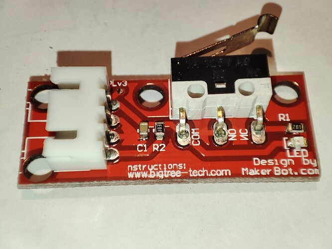

I quickly build that schema and connected MakerBot design end-stop from BTT.
Then hook-up oscilloscope there, here is my findings:
MakerBot end-stop, +5v connected, triggered, 1.92ms to reach 0.8v level

**Post date:** [May 25, 2024, 3:05am UTC](https://klipper.discourse.group/t/what-is-klippers-homing-sampling-rate/16653/8 "2024-05-25T03:05:51Z")
As I said at the start, I was thinking of a simple switch. The Maker Bot endstop adds additional capacitance to the circuit.
Regardless, the critical situation is when the switch closes and that will be very fast whether there is a capacitor on the line or not. When the switch opens you will get a much more pronounced RC curve but that shouldn’t be an issue.

**Post date:** [May 25, 2024, 6:36am UTC](https://klipper.discourse.group/t/what-is-klippers-homing-sampling-rate/16653/9 "2024-05-25T06:36:55Z")
Is my understanding correct:
Makerbot endstop-design:
- Typically 10k / 100 nF
- NC design, so the important factor is the discharge time of the cap
According to this data:
- Time Constant is 1 ms
- Following V\_C = V\_{C0} \times e^{(\frac{-t}{τ})} the discharge time from 5V to 0.8V would be 1.83 ms (which seems to fit quite nicely to @gaolst measurement 1.92 ms)
The difference to the 365ns is indeed massive.
**Author:** ![gaolst](https://yyz2.discourse-cdn.com/free1/user_avatar/klipper.discourse.group/gaolst/32/10026_2.png) [@gaolst](https://klipper.discourse.group/u/gaolst)\
**Post date:** [May 25, 2024, 10:53am UTC](https://klipper.discourse.group/t/what-is-klippers-homing-sampling-rate/16653/10 "2024-05-25T10:53:52Z")
Yes, it’s correct.
But it should be noted that when End-stop is used for some alignments of the system like in Delta or it’s used as a distance probe - they should be very careful what kind of end-stop they use and what kind of schema they have on board and in end-stop, **especially it’s important when user is doing upgrades of mainboard and keeping old end-stops.**
If they are not careful - they can get a condition when electronics will create that 2ms delay and if they have very fine microsteping and high speeds - steppers can overshoot by 6-50 microsteps, overshoot depends from speed and rotation distance.
So thumb-up rule rule is following: If your board have capacitance in end-stop chains - You should use passive end-stop which triggers by shorting Signal line to Ground, you can also use Active end-stop which don’t have any capacitance and have same logic - triggering will short Signal to Ground.
Releasing of a triigger should not be used at all.
**Author:** ![TheFuzzyGiggler](https://yyz2.discourse-cdn.com/free1/user_avatar/klipper.discourse.group/thefuzzygiggler/32/12313_2.png) [@TheFuzzyGiggler](https://klipper.discourse.group/u/TheFuzzyGiggler)\
**Post date:** [May 25, 2024, 11:39am UTC](https://klipper.discourse.group/t/what-is-klippers-homing-sampling-rate/16653/11 "2024-05-25T11:39:33Z")
The “newer” Makerbot style switch is SPDT which avoids this whole issue.
 ![image](https://global.discourse-cdn.com/free1/uploads/klipper/original/2X/7/7c27038e792a6a91fb71664ab20c7ff052494c21.jpeg)
It pulls straight to VCC or GND so there is no charging through the capacitor.
You and Myke are correct that it’s an issue with a SPST switch to ground.
Circuit analysis is below for both if you want to play around:
[Makerbot v1.2 Style Switch](https://www.falstad.com/circuit/circuitjs.html?ctz=CQAgjCAMB0l3BWEAWayDM7ICZfP8gJwLogKRkqkICmAtGGAFABuZ2AHCJ1wpyIQBsUEcgpIKk6AiYBlEFmTdIXdH2VcKEAGYBDADYBnGiOxMATtw5chVrmADswrfEhMAxne7YlPL1voHKFh4MB8EZEEEMEgHZFxCUhg4ZnRBG2FsFQFhMHwRNwB3bgRM7L8szSZiip8vSqhqhUhfcusNRpr2x0z2hqKFdTBCbEHR2wG1Ubwx-ya-WymcztnbPgzGyz9FLyWpRHm+o9UWlaXt9T2m9a8bq67VS6fRyef2R5fWBWmHUfRRjiSUQUdDQJIFaRNQRKQHgfiwtyWHrLZHDF7gVwecBObxKZF+AJ0IKgrCueDYQR4CDJSDMJE4vzIzDOYIHYphLiw5EIprI2zcyS8nHMkDQhRpM5-CX-bi-TbLBpgQQUfoYuC85UdfHZAb4uraqrsnFo7FlQ2mjrYUodNwAWQV2TFquwkOKYpFMpFAzFsJlPIA9igQJoUJBCIRWfAnNhEoRkCQwhIQnBCE5SlbTEH0EwgA)
[SPST Style to Ground](https://www.falstad.com/circuit/circuitjs.html?ctz=CQAgjCAMB0l3BWEAWayDM7ICZfP8gJwLogKRkqkICmAtGGAFABuZ2AHCJ1wpyIQBsUEcgpIKk6AiYAnbhy5CFXMAHZhFMPEhMAxiu7ZkhniLD01KaIVt3bgjYNyQJsSM3SClw7JB-g+CK6AO7cCL7+plGhpsbRXLFYJn5cZqlQTGFm6r6K3DFZIOh8BVwl2IaxZsoVAppFdcp8AbryZsmGdVKIRen5HZAmSaUdpd1FLYZTE9n5dQulI5V1M0usxZXYaiuVHJKiFOjQpAcwMmGCJvvg-Ddt4Br1j8JghJVaOvovRia5VeBLMVoNh7PYONhBGASqd3Mx5P8ck9MJooO4LrcuDd-vciv9lDjJHjkV4QFdiqSkitSegtjtMvJlBkwIIKBlPnA8ayyj92cTfPFEYUwv83pUhYl+TzsBEeboALLPDLk9ncaRFckozYUhqXa5HPZEgDOxSGPLqqogADMAIYAGyNNCYAHtiiBEihILZwFpsNAPStikwgA)
Both have the scope set to 1ms/DIV
**Post date:** [May 25, 2024, 12:17pm UTC](https://klipper.discourse.group/t/what-is-klippers-homing-sampling-rate/16653/12 "2024-05-25T12:17:26Z")
> [@TheFuzzyGiggler](#):
Well I actually did use SPDT type of a switch for a test and get those results,
here are photos of it, I’m wrong ?
 ![IMG_20240525_150034](https://global.discourse-cdn.com/free1/uploads/klipper/original/2X/b/b94968e0e0298e37924a35046a1b6776323db930.jpeg)
 ![IMG_20240525_150021](https://global.discourse-cdn.com/free1/uploads/klipper/original/2X/d/d24281374f62d8256b668b52b94c9b413c531cf9.jpeg)
**Post date:** [May 25, 2024, 6:45pm UTC](https://klipper.discourse.group/t/what-is-klippers-homing-sampling-rate/16653/13 "2024-05-25T18:45:35Z")
When high it SHOULD have a direct connection to VCC and thus the current path shouldn’t be through a capacitor. (VCC → Current Limiting Resistor → MCU Pin → Internal MCU path to Ground)
With just a simple switch pulling to ground, when it’s open the “high” is tied through a resistor with the capacitor in the ground circuit causing the RC time constant.
I’ll admit, I second guessed myself about 5x while looking at this and doing the circuit simulation though.
@mykepredko - Any input on this and the two simulations I posted? Maybe I’m the one doing it wrong.

I was confused by your original model of the Makerbot V1.2 because it didn’t make sense that the NO contact of the switch was tied to 5V - by doing that, the filtering RC circuit is effectively bypassed and does SFA as you can see by the crisp edges in the diagram above.
I would have thought the _correct_ approach for Makerbot would be to leave the NO contact disconnected so the filtering components are active in the circuit like:
 ![image](https://global.discourse-cdn.com/free1/uploads/klipper/original/2X/3/3991d85e3e1c198c12291a7fb73108fe70bc257c.png)
But, when I do some research, I find that is the case, the NO contact is tied to Vcc as per:
[https://reprap.org/wiki/Mechanical\_Endstop](https://reprap.org/wiki/Mechanical_Endstop)
With the schematic:
 ![image](https://global.discourse-cdn.com/free1/uploads/klipper/original/2X/b/b137eddb2c2703671fc3c121959272a0fa3df87e.jpeg)
Which looks like the “Original design” is probably more correct than the latest one.
From all this, I have come to three conclusions:
1. The 0.1μF cap was put in by somebody onto a main controller board for some unknown reason and people have copied it blindly without questioning it’s presence.
2. The 0.1μF cap doesn’t perform any useful function and could be problematic depending on how mechanical endstops are wired.
3. This thread is probably the deepest discussion on the design of endstops, one of the most critical components in a 3D printer, that has been done in the past 20 years.

> [@mykepredko](#):
I agree with that, when looking into it more than once I was like… What? Why?
And you’re right on the common ground, I did it both ways but they should have been connected to a common ground. I didn’t see it ultimately made much difference in terms of what we were looking at but I redid it so many times I’ve lost track now.
I came to the same conclusion on the capacitor though, In the “newest” Makerbot version it serves no purpose as far as I can tell.
I think someone just took the idea of a bypass capacitor too far and everyone ran with it.
**Post date:** [May 25, 2024, 8:01pm UTC](https://klipper.discourse.group/t/what-is-klippers-homing-sampling-rate/16653/16 "2024-05-25T20:01:24Z")
The way it’s wired, it’s not a “bypass” capacitor, it is a “filter” capacitor. You can see the filtering in the simulation waveforms.
Bypass capacitors provide a low impedance path for high frequency noise and do not have a resistive current source in series (like a low pass filter circuit, like the one we’re talking about here, does).
Sorry for being pedantic but it could be the person who put the capacitor in originally, didn’t understand how the circuit would work.
**Post date:** [May 25, 2024, 8:51pm UTC](https://klipper.discourse.group/t/what-is-klippers-homing-sampling-rate/16653/17 "2024-05-25T20:51:12Z")
I modeled it [this way](https://www.falstad.com/circuit/circuitjs.html?ctz=CQAgjCAMB0l3BWcMBMcUHYMGZIA4UA2ATmIxAUgoqoQFMBaMMAKACcQAWYwkFPPFx5c4UZHHYiqnbCil8BYsPEgswhOd16dRWroU58QAEzoAzAIYBXADYAXBjbrHwYqjEisAykO0GQhBia-u4gljYAznRiKCwAxvIInIY6tMRyVGCwKjk5YIzkCNm5uRAeniwA7vKECLyBcrW8qtUNFOkBQVx47lWdmpyCbfyCLf0KgnojUH1TiqkTM9V6nP4ywYaqAOY1dTWKvQBKvotTKJtiOtShMAgs2ISC2A-6hs-a6m4sALIg769-F4IMAZPjQO7LXRrXSyJbyVYpXTCMYLBFcWFolFQt4vTF9aZo-54jgLBAdBZNJSMYizURJRHSZF9NqUtpkjIsAD24GwIFGIlI1EI0AucjAvOwLCAA). IMO the cap does just nothing.
In a regular circuit, it would serve to debounce the switch and reduce the impact of noise. In my first printer 10 years back, this was really a topic and the initial RAMPS boards had not RC circuit on board.
Today, I’d rather consider them detrimental, as @mykepredko pointed out.
**Post date:** [May 25, 2024, 9:08pm UTC](https://klipper.discourse.group/t/what-is-klippers-homing-sampling-rate/16653/18 "2024-05-25T21:08:13Z")
That’s the lowest ESR capacitor I’ve ever seen in my life.
(Totally jk I know the simulation won’t work without it.)
To one of Myke’s original points, Even if there was a 5-20 microstep delay. It really doesn’t matter for X/Y homing anyways. Absolute worst that would happen is the first time you home your gantry rams into the side and you’d adjust your endstop to compensate.
For the Z axis everyone uses a probe of some sort anyways, and those that possibly do use a Microswitch have adjusted their Z offset to compensate.
It’s an interesting discussion on how things propagate because no one questions them, and there potentially COULD be a “better design”. But at the end of the day, does it really matter/is it worth it?

> [@mykepredko](#):
I did some history digging …
First design of end-stops was to use mechanical switch in default LOW state and when triggering is happening - it would go to HIGH level,
that capacitor was introduced for pure mechanical switches as a countermeasure to solve switch “bouncing” and EMI protection (
more about that [here](https://marlinfw.org/docs/hardware/endstops.html#endstops-and-electromagnetic-interference-(emi)))
Then MakerBot did develop optical end-stop which was working other way (trigger when on LOW) and it was used in their boards which didn’t contain that capacitor, eventually they create mechanical version based from optical version to reduce cost and wiring (SPDT type - 1.0v), in this moment they introduce that capacitor to mechanical end-stop board, so it would be compatible with their mainboards together with optical end-stops which don’t have it.
So MakerBot was handling it correctly - their boards did have only MCU Pin input, pull-up resistors and capacitor (for mechanical version) was present in end-stop itself.
But as time did go forward, different end-stop designs propagated everywhere most of the boards designs did try to follow MakerBot design (trigger on LOW) and eventually moved pull-up and capacitor into their boards.
Now we have them on-board almost in each board designs and if you try to use Optical end-stop - you will get 2 pull-up resistors, if you use mechanical MakerBot end-stop - you will get 2 pull-up resistors and 2 capacitors in same circuit 🤣
Most probably you are right, but don’t judge just for simple kinematics like Cartesian, for example Delta kinematics is very dependent from exact end-stop triggering, overshoot distance depend from rotation distance and in some hardware configurations your error can reach 0.1mm - which is pretty high for Delta kinematics.

> [@gaolst](#):
This is true, but I imagine with delta kinematics you’re using the same endstop type on each of the three pillars so it SHOULD (very ideally) even itself out. In other words, They’d all have roughly the same delay within part tolerance that is.
Or, like you said, you can just use an optical or hall effect endstop.
I’ll leave that one up to the Delta printer owners to handle.
