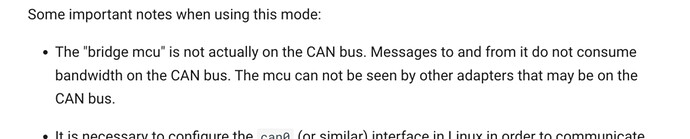

Isn’t the USB to CAN bus bridge mode (e.g. BTT Octopus 1.1) the better solution?
I’ve seen statements that this puts a burden on the raspberry pi, though looking at the Klipper documentation that should not be the case:

Personally, I think it’s the optimal solution as it is the simplest approach from the system (and wiring) perspective and I haven’t had any issues to suggest otherwise. However, other people don’t agree with me and have had problems in their printers.
Having said that, it is somewhat tricky to get the CAN Adapter working in the Octopus with Klipper for the first time and I used the CanHat and U2C solutions before going on to implementing it on my Octopus boards.
I would recommend that if you are starting out with the CanHat solution, keep with it and get your wiring fixed up (which should basically eliminate all dropped frames) and then migrate to running the CAN bus from your Octopus (and then deciding whether or not to run CanBoot).
