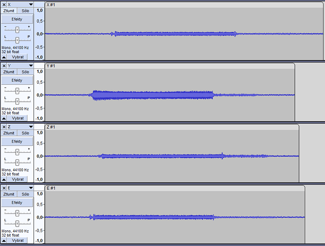

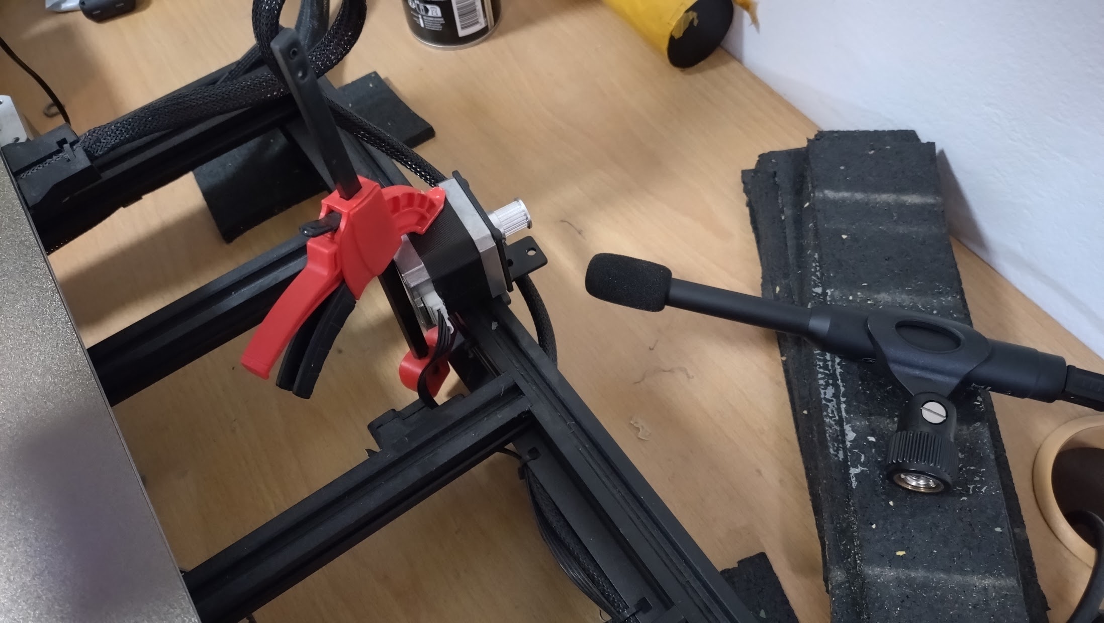

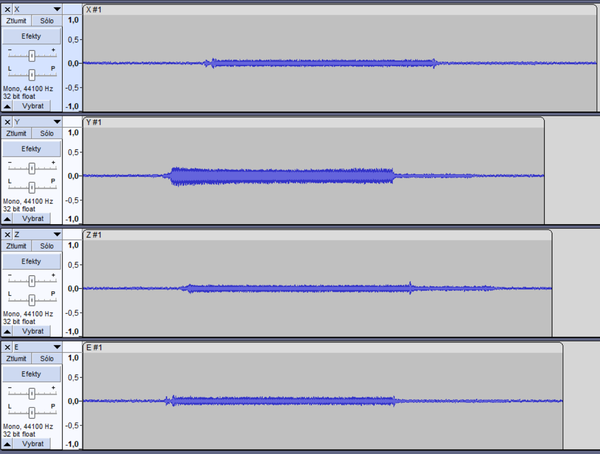

It’s 'Nureek’ing and 'retut’ing, and just when you expect them to ‘nureek’ again, they
‘squrlookal’! 😛
I tried to record the sound of the motor. For some reason my microphone has pretty high noise (event that’s calibration USB mic), but it’s still audible (and visible 🙂 )
X is nice quite and smooth. Y is louder and vibrating (in real use it’s even more audible because it resonate)
 ![20240409_203519](https://global.discourse-cdn.com/free1/uploads/klipper/original/2X/5/5a67006a2524a7be9ac1d6fb12abe352945a716c.jpeg)
 ![obrazek](https://global.discourse-cdn.com/free1/uploads/klipper/original/2X/f/fd93867d226ed3d42084671af9cd09825d9518f9.png)
[sounds.zip](https://klipper.discourse.group/uploads/short-url/ouo03OeepUFOGLtoSbtp1FENGDy.zip) (1.2 MB)
The vibrations are simply vibrations 😃 When I hold the motor in hand, it’s like phone.
I found out, that the different sound of Z and E was probably caused by different settings (rotation\_distance). With the same settings they are like X axis.
I recorder the sound with same settings on all motors and using command _FORCE\_MOVE DISTANCE=200 VELOCITY=50 STEPPER=“xyze”_

**Author:** ![Benik3](https://avatars.discourse-cdn.com/v4/letter/b/3e96dc/32.png) [@Benik3](https://klipper.discourse.group/u/Benik3)\
**Post date:** [April 9, 2024, 7:15pm UTC](https://klipper.discourse.group/t/y-axis-more-noisy-vibrates-then-x-tmc2209/15395/27 "2024-04-09T19:15:33Z")
I didn’t normalized the sound, the records are quieter then real volume.
As I mentioned, the Y axis is in reality also much more loud, when the printer move, because it resonate (thanks to the bed and mount to the frame).
Still the main point is, why Y axis drive is twice as loud/vibrating then X/Z/E…
