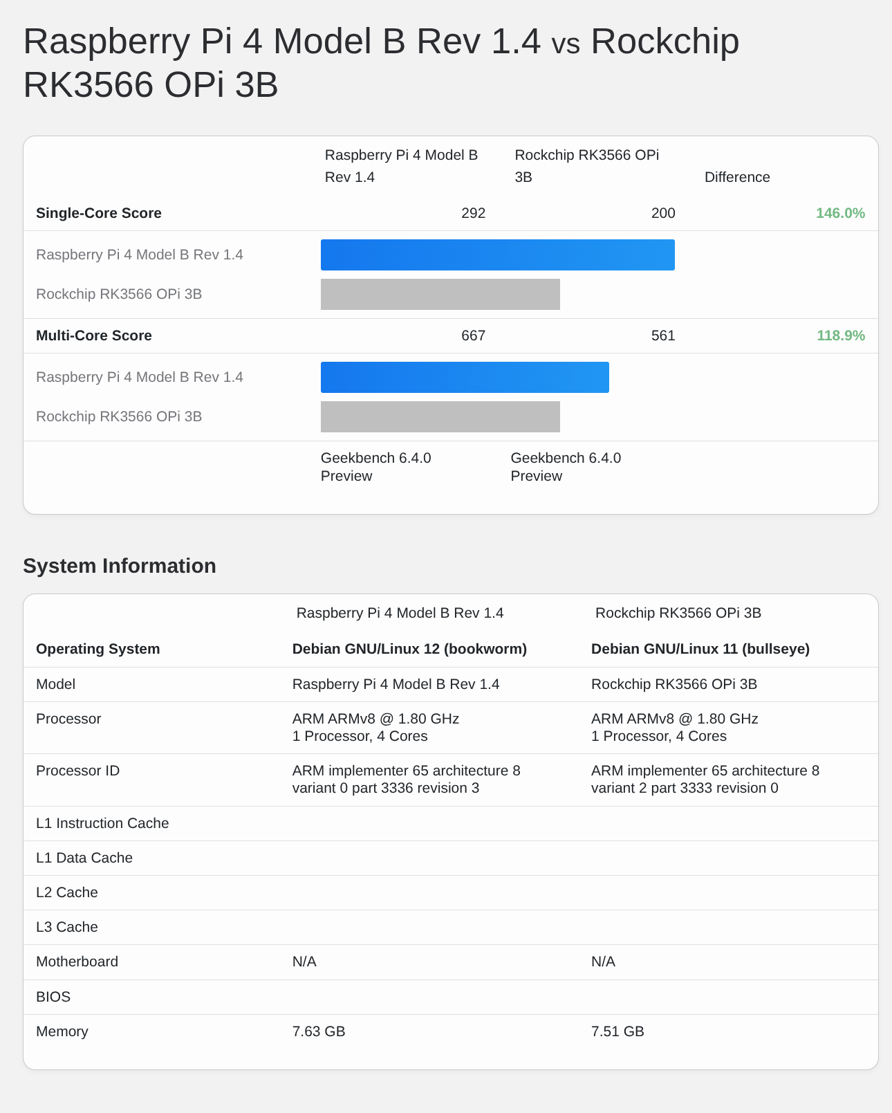

A Single Board Computer (SBC), or a similar device, isn’t inherently related to 3D printing - its relevance comes solely from running Klipper, the firmware that controls the printer. Essentially, it’s just the hardware executing the code.
BTT or not is pretty much irrelevant. On the contrary, well-known and reputable SBC manufacturers like RPi offer better overall packages. The more important point is, however, the Linux integration, and here BTT is far from brilliant.
Thanks, yeah I get that, HW vs software. The logic was that HW from a company which makes a SBC which lets face it, will 99% of the time will be used for 3d printing would also be optimised to run in this case Klipper well.
I have a pi4 which runs well. My bad got the BTT pi2 thinking it would work better, and be more compatible with my other components. Lesson learned. Thanks guys

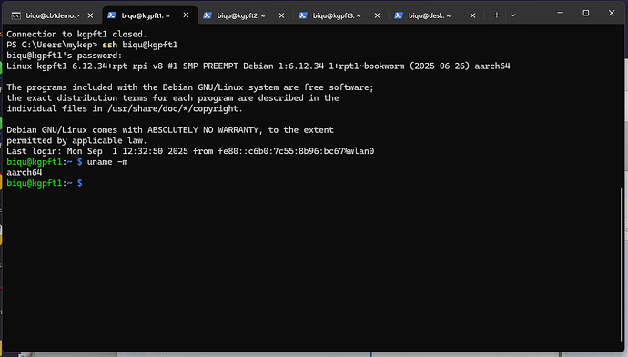

I don't read anywhere which Linux version is used, but if you use Can bus, you should at least use a 32-bit version.
I don’t read anywhere which Linux version is used, but if you use Can bus, you should at least use a 32-bit version.
Not true. CAN Bus works fine with 64 bit operating systems.
The best way to get CAN Bus working is to follow the Esoterical guidelines when setting up your host:
I found this there: Getting Started | Esoterical’s CANBus Guide
I had this problem myself, after switching back to 32-bit the problem went away, I've noticed it again on my other printers as well.
It's a known problem, I think Kevin O'Connor has already advised it somewhere.
Where is that in the Esoterical guide? I just looked through it and couldn’t find it.
Regardless, I’m running 64bit on Raspberry Pi, CB1, CB2 and OrangePi.
It was an issue over a year ago (two years?) but I’m running without any issues at all on multiple architectures.

@hardy8 I see, you are trying to be helpful, and this is really kind of you. But as far as I can tell, there were no indicators of CAN-related issues.
Even more, Eddy connected via the USB Serial emulation.
About 32bits, this is not directly related. General recommendation:
  • kernel 6.6+ if there is a lot of “byte_invalid” for usb2can. 6.1+ if there is CAN HAT.
There are similar reordering bugs in both CAN adapter types, which are probably less reproducible on the 32-bit. Not because 32-bit is superior or something, but simply because it is a coincidence. Both are fixed in the kernels 6.6+.
