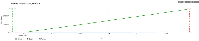

  • CANBUS works perfectly well at idle
  • Homing, print start works without issue
  • Sometime (typically couple hours into print), print fails due to CANBUS issue
  • bytes_invalid always seems to remain at 0
  • However retransmit_seq and TX Retries seems to increment a LOT
  • Bus is set to run at 1Mbps per the setup instructions
Linux ip command doesn’t report any issues/errors. The txqueuelen parameter has been either 128 or 1024 during test prints; either of which is theoretically sufficient according to the wiki.

Most recent print in the log has a huge jump of TX errors/retries, but it was at the start of the print and didn’t actually seem to actually cause a shutdown. On previous test prints, I noticed the logged canstat TX retries would increase almost linearly throughout the print until shutdown. Until the most recent print, I never observed any RX errors.
The MCU frequency on the toolhead seems to become more erratic until shutdown?

This time, bytes_invalid actually DOES increment before the shutdown occurs. So, that’s cool I guess? The bytes_retransmit started incrementing again before the shutdown as well, but still not nearly as bad as it was. TX retries still seems to increment linearly but I still don’t know what that means. Does anyone else’s canstat’TX Retries’ increment throughout the print?
(RX_errors started going up before shutdown as well)
The wiki states bytes_invalid is not a hardware issue, but I’m not sure how the software could be randomly starting to fail after printing for hours? I dunno. Maybe one of the 120R jumpers fell off.
This ↑ contradicts esoterical’s guide on troubleshooting similar errors, where it states that it probably is a bad connection. I dunno. We will continue to investigate. If I have to hook up a logic analyzer and capture gigabytes of data, I guess I will.

I took a brief look at your logs. It’s not clear to me what the root cause of the issue is. If I had to guess, though, I’d guess it is some kind of canbus issue between the rp2040 and the u2c (for example, wiring, resistors, wire crimps, one of the chips overheating, or similar).
The tx_retries isn’t necessarily an error - it can happen during normal activity, but you are showing a very large number which is odd. Also, the incrementing of the rx_error is suspicious (along with it coming in large bursts).
