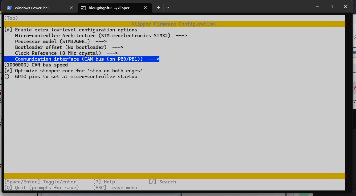

I am running ./kiauh/kiauh.sh over SSH. I usually select kiauh V6 Beta (but have tried V5 and seen no difference). I then go into
4) Advanced options,
3) build, flash.
architecture STM32, processor STM32G0B1, - Bootloader offset = 8KiB bootloader, - Clock Reference = 8 MHz crystal, Communication interface = CAN bus (on PB0/PB1), (1000000) CAN bus speed (or 250k at the moment)
  1. select regular flashing method
    Put the toolboard into dfu mode by holding boot button while pressing and releasing reset button
  2. make flash (not stm32flash)
  3. USB DFU mode
  4. for the only DFU VID/PID present (samd21 and rp2040 are not shown, as expected)
    y confirm the flashing action
But you know what? I think I had some errors in the flash read-back at the end of the flashing. This sounds highly consistent with your theory. I put this down to V6 Beta kiauh and didn’t have any improvement/different behaviour with V5 (but don’t recall seeing the flash readback error there). I did check whether the stm32flash method was needed but the source I referred to did not use it and said to use the normal flash method for stm32 over dfu.

Okay - I see a problem here.
When you put a board into DFU mode, you’re loading the firmware into the boot portion of the Flash - NOT THE BOOTLOADER OFFSET.
When you specify “Bootloader offset = 8KiB bootloader” you’re specifying that the firmware will start executing at the boot offset + 8K, not the boot offset.
Could you try this again with “Bootloader offset = No bootloader” as per:
and I think this problem will go away.

Well I just got a chance to try this and it certainly seems to show promise. I flashed with 0kb bootloader offset and then commented out a motor in printer.cfg while leaving its mcu intact. Then “save and restart” button in mainsail web dashboard. The EBB42 came straight back up. More testing to be done but thank you very much @mykepredko !
