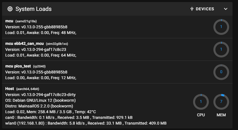

So, as far as I can tell, the key factor here, once you have a valid printer.cfg is that the EBB42 absolutely requires reflashing once the printer.cfg has been saved and klipper restarted. I have no idea why this fixes everything - I tried a great deal of stopping, resetting and restarting services and network interfaces with previous attempts. Thanks @mykepredko for walking through with me.
When I’m troubleshooting changes in the config I like to shut down the klipper host, power off five seconds (until all power LEDs go out plus a second or two) then power it back up. That way I have a known, repeatable starting point. I’m sure this is overkill most of the time, but hardware is like a toddler in that it occasionally gets cranky and needs a nap.

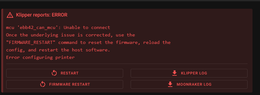

The main thing which happens is I get
followed by
What did I change to bring this about? I commented out all the motor and fan definitions, leaving only the mcu and the can uuid in the can_motors.cfg which I include in printer.cfg (along with the samd21 and rp2040 mcus that have behaved perfectly when changing their configs):

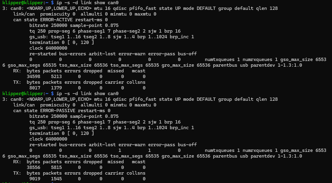

I also verify the bus failure by ip -s -d link show can0and typically get:
If I were to now reflash the EBB42 using kiauh, I would see klipper start correctly and ip -s -d link show can0would show can state ERROR-ACTIVE and the Tx/Rx packets incrementing if I keep issuing the command.
