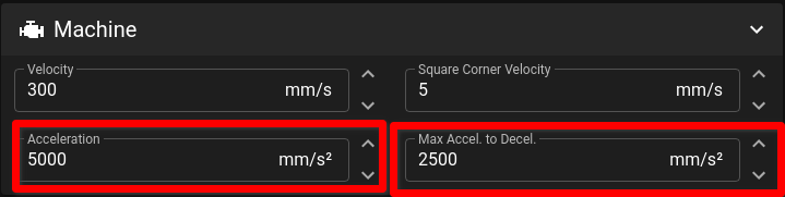

Maybe there is a more easy way to check this out (while printing). Set 3 Settings to a very low value:
The web interface allows to easily adjust the settings of acceleration while printing. I would start with a very low value on the start and increment it later. Possibly also accel to decel values are important.
I did check a lot now, I did not find any potential problem what could cause this issue. That on the software/firmware side many things are checked, makes the lost steps to the most likely explanation. For continuing my research I need your confirmation, that no steps are lost. :slight_smile:
