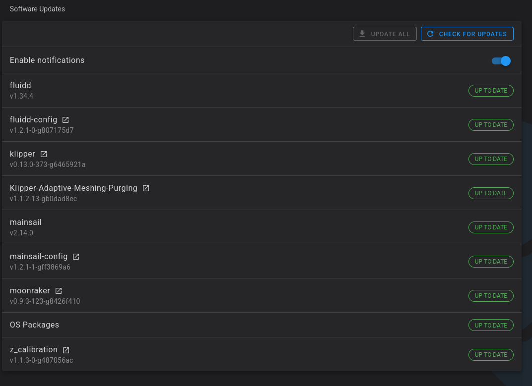

I have updated all my files, and fixed warnings related to the mobileraker and z_calibration.py
This is what fluidd shows now (it had warnings earlier but I didn’t ss it):
I have nearly run out of filament for the day, so I’ll be printing a slightly scaled down (90%) version of the model overnight. Also, I am using bambustudio this time to slice… Just trying everything I can at the moment to not fail again. Will update if it fails again in the morning
Did you update your MCUs as well?
JFYI: slicers has nothing to do with it.
How do I do that? Do I have to rebuild the binary and reflash? I used kiuah last time and that was in 2023 IIRC
