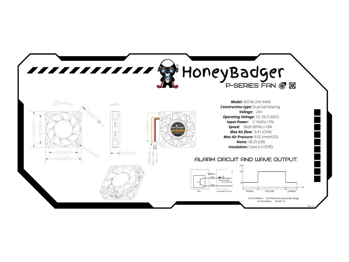

I’m here to ask for your help to understand how to create a macro that checks the rotation of the fan in order to performs specific actions in case of failure.
The fan is a 4010 HoneyBadger 3 wires which is, in theory, designed specifically for this purpose … even if no one has yet specified “how” to implement the function.
From the wiring diagram shown in the link it is assumed that there is a high signal in case of rotor block, so I created a macro that reads the signal (and it works so far)

Now I am stuck in creating the macro that should read the signal, evaluate for a specific time (e.g. 3s) and then if the time threshold is exceeded execute an “emergency” macro.

First problem i found right now with the macro below is that the signal is not triggering as declared in the datasheet.
[gcode_button HE_FAN_ALARM]
pin: ^tool_0:gpio12
press_gcode:
M118 FAN OK
release_gcode:
M118 FAN KO
I have a “FAN OK” when the fan is activated and a “FAN KO” when is deactivated by Klipper but i have nothing when the rotation is stopped manually, maybe the i burned something inside while testing stopping it manually?
