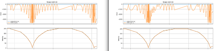

I ran a test on my Voron Zero using the various step compression algorithms. Below are some snippets from the test.
Original Klipper algorithm:
Code from my work-stepcompress-20220831 branch (e31be989):
Code from Dmitry’s stepcompress branch (83f7bd50):
Some high-level thoughts:
  • My work-stepcompress-20220831 branch does have smoother velocity compared to the baseline code. It is not as smooth as Dmitry’s code.
  • None of the branches seem to improve the jitter picked up by the accelerometer and angle sensors on this machine. It seems that my Voron Zero has an increase in mechanical jitter when moving around 60-80mm/s that is not related to step compression.

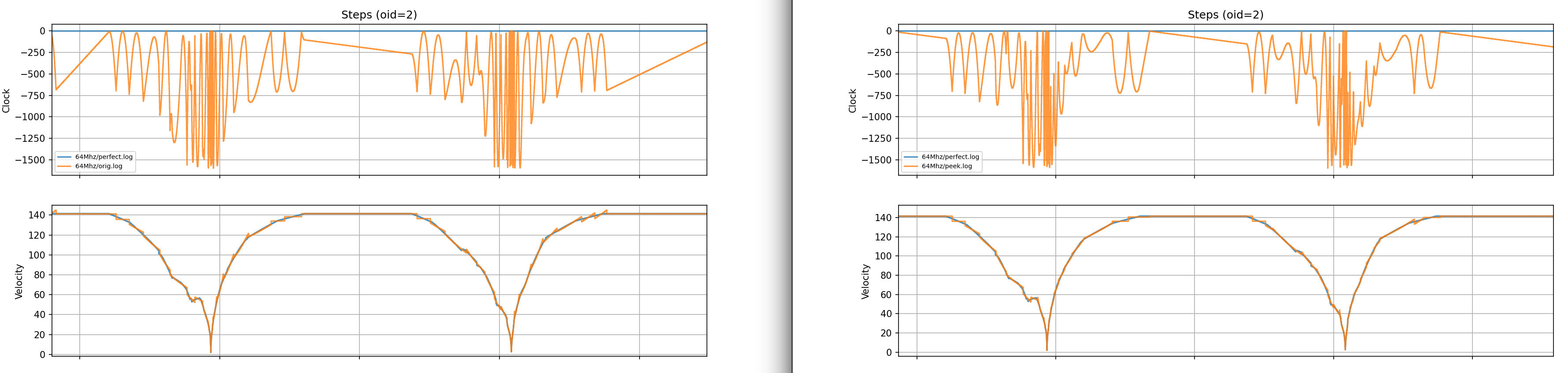

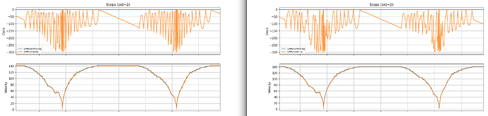

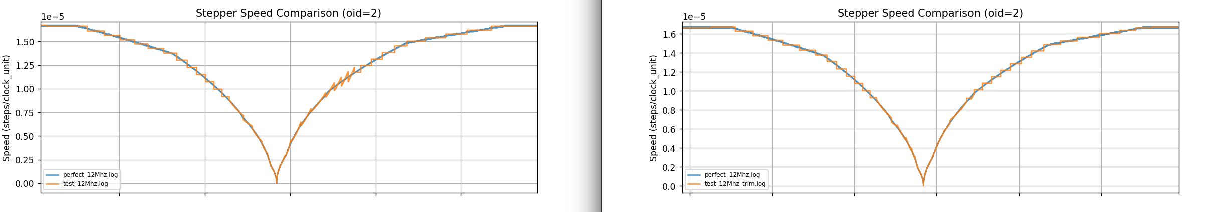

Below are the graphs.
Microstepping is set to 64. RP2040/RP2350 are just examples of different timer resoultions.
Compression ratio, I utilize the size of the serial output:
# Example 20min empty cube print
$ du -hs test_12Mhz*.serial
18M     test_12Mhz.serial
20M     test_12Mhz_trim.serial # +10%
$ du -hs perfect_150Mhz.serial test_150Mhz.serial test_150Mhz_trim.serial
792M    perfect_150Mhz.serial # 1-2 steps per cmd
11M     test_150Mhz.serial
17M     test_150Mhz_trim.serial # +35%
# Sort of curve torture test, torus, gcode_arcs, gyroid infill 40min
$ du -hs Torus_12Mhz*
32M     Torus_12Mhz.serial
36M     Torus_12Mhz_trim.serial # +12%
$ du -hs Torus_150Mhz*
26M     Torus_150Mhz.serial
40M     Torus_150Mhz_trim.serial # +35%

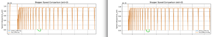

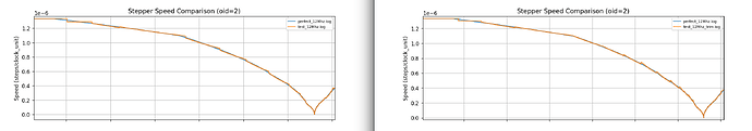

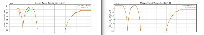

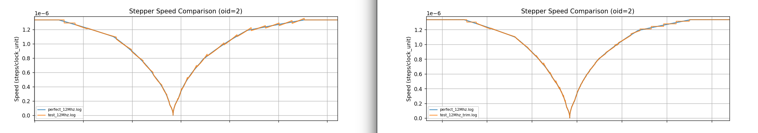

Speed Graphs, speed is constant / interval.
Green is where I zoom. I messed up file names. This is a 150MHz RP2350.
This is a 12MHz RP2040.
Green is where I zoom, because with the trim, there is an overshoot
It seems to improve the fit. It also introduces its own artifacts, where the trimmed tail allows the next function to start overshooting sometimes. But overall, because of just more aggressive segmentation, it is smoother.
(They also could be dumped, but that, unfortunately, would increase the data rate further).

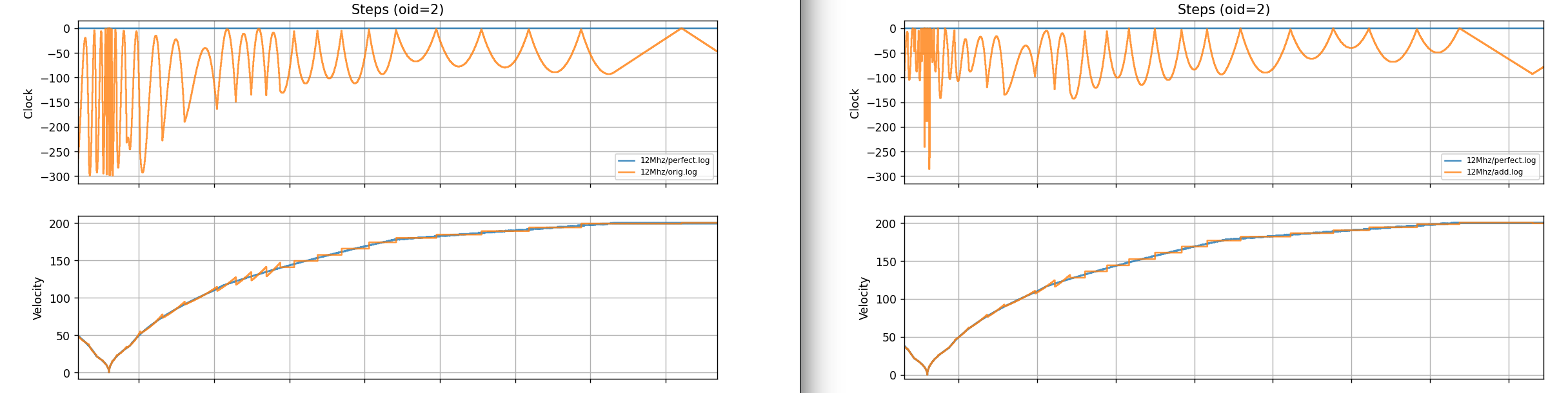

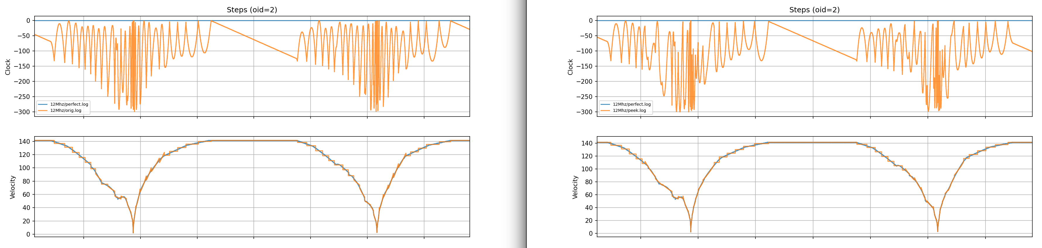

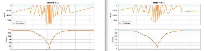

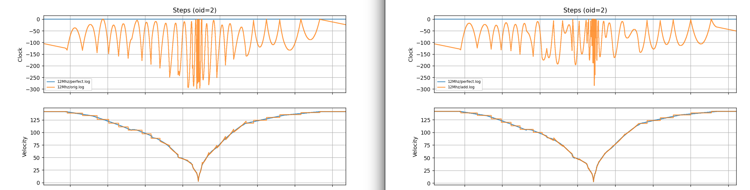

Graphs
./scripts/graph_steps.py -O 2 --diff 2 -f 12000000 -c 1000000 12Mhz/perfect.log 12Mhz/add.log
./scripts/graph_steps.py -O 2 --diff 2 -f 64000000 -c 1000000 64Mhz/perfect.log 64Mhz/add.log
./scripts/graph_steps.py -O 2 --diff 2 -f 150000000 -c 1000000 150Mhz/perfect.log 150Mhz/orig.log
Any MHz could be produced by the jq '.config.CLOCK_FREQ = 12000000' out/klipper.dict
Compressed sizes
13M     12Mhz/orig.serial
15M     12Mhz/add.serial +15%
418M    12Mhz/perfect.serial
8.5M    64Mhz/orig.serial
11M     64Mhz/add.serial +30%
338M    64Mhz/perfect.serial
7.8M    150Mhz/orig.serial
9.6M    150Mhz/add.serial +23%
455M    150Mhz/perfect.serial

Graph

Thanks.
Well, it seems I solved it: GitHub - nefelim4ag/klipper at stepcompress-peeker-27012026
It is a little bit hacky and dirty.
But basically, as I understand.
The problem is discontinuity or velocity jumps, in other words.
It seems there are 2 places where the greedy algorithm creates jumps, at the start and at the end.
It is somewhat easy to fix at the start, we just have to feed the last interval if it is possible/applicable.
That introduces oscillations, and it “breaks” again, more and more violently.
Because now it tries to use as many steps as it can, and it has “success” with it oscillating.
So, there should be a post-processing, which I already have, and it just needs to be adjusted.
In reallity I spend hours optimizing 2 moves fit, and then had a problem with velocity jumps at the start of the sequences. Everyone is smart in hindsight.
FWIW, it costs about 17% CPU in my batch tests, the output data size +17%.

Graphs
Master vs Patched

Motan graphs with encoders
My data, without encoders XY motors.
./scripts/motan/motan_graph.py -g '[["derivative(stepq(stepper_y))"],["derivative(stepq(stepper_x))"]]' ./move_test_patched -s 0 -d 10
Not my, but with encoders:
./scripts/motan/motan_graph.py -g '[["derivative(sos(angle(stepper_x),filt,lowpass,2,100))"],["derivative(stepq(stepper_x))"]]' ./stepcompress/master -s 0 -d 10
Encoder’s data is filtered because they are noisy, and the motor oscillates during the movement.
It seems to me that step-compression artifacts have a little impact on the motors.

Just in case, I will try to explain my intuition behind it with graphs/pictures. I hope they are simpler to comprehend
Handmade explanations
Normal compression has an error window that allows for stepping faster, but never allows for being late for the current step or earlier than the previous step.
Often, it can’t encode the input sequence with the average “speed”/interval because of the resolution/clock quantization limitation.
That leads to velocity jumps higher than the end of the previous move:
If we simply restrict the tail jumps - add a move to move velocity limit, “not start to step faster then previous move”.
It will start to oscillate
Restriction on the tail forces the compressor to maintain the start speed, but it can’t settle.
The compressor has no idea that it is oscillating; it just tries to compress as much as it can every time.
Where it can lead to better compression in the next move if it stops earlier.
If we try to add only a move to the move fit/correction.
It will oscillate less/encode better because we fit it in that way, but it is costly O(n*log(n)) and does not eliminate velocity jumps completely.
*Binary search is fast, but repetitive compression of the next sequence is costly
So, if we use them both, the start velocity limit can still lead to degradation, but because we refit sequences, it is canceled immediately.
