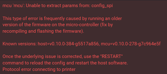

I've never seen this before Error appears after update
No matter how many times I searched, I couldn’t find the same symptoms
The well-moving voron 2.4 went dead

Reflash your MCU board. You are running a Klipper version on your board which is too old compared to the one running on your Raspberry Pi
Thank you. The problem is solved
