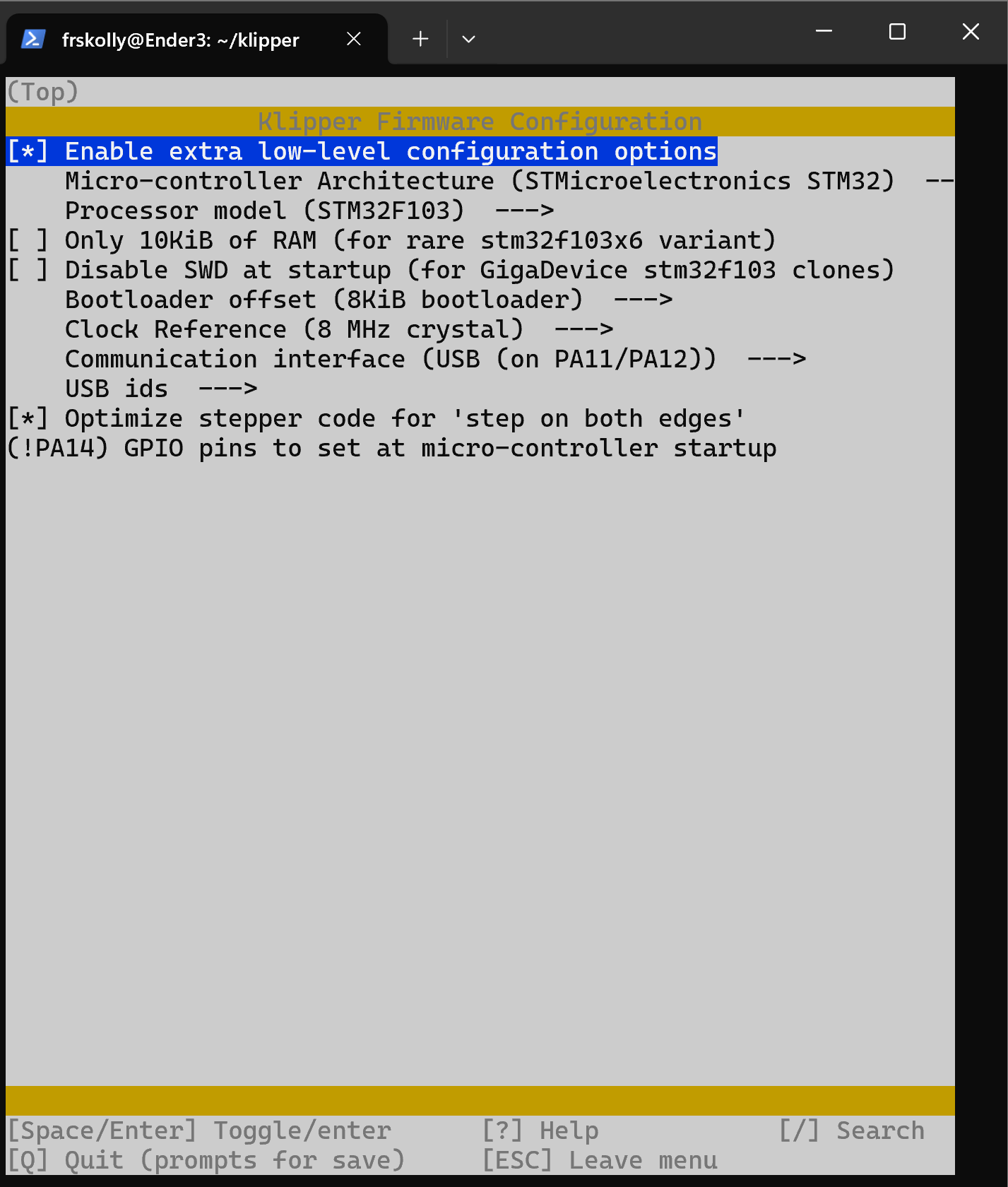

I see this post is old but I’m hoping someone will be able to help me. I have flashed katapult onto my skr e3 v2.0 board and it will not show up when connected to my pi4b unless it’s in bootloader mode. When I try to flash Klipper onto it in bootloader mode it is failing every time, I have ensured that I followed the settings above and have looked in other threads and found nothing that works. If there is more information that I should attach please let me know.

cd klipper
~/klipper $ make flash FLASH_DEVICE=1eaf:0003
Flashing out/klipper.bin to 1eaf:0003
sudo dfu-util -d ,1eaf:0003 -R -a 2 -D out/klipper.bin
[sudo] password for

dfu-util: No DFU capable USB device available
Failed to flash to 1eaf:0003: Error running dfu-util

Looking at your comments above, you should explain how you loaded Katapult onto the SKR Mini E3 V2.
You appear to be using a wrong flash command:
Please pay particular attention to step 8 of my instructions:
Flash Klipper onto the modified SKR board using the standard flash command make flash FLASH_DEVICE=/dev/ttyACM0. Make sure to use the correct device name for your specific installation, for example it could be make flash FLASH_DEVICE=/dev/ttyACM1, etc.
When in doubt, please consult the official Klipper installation instructions.
