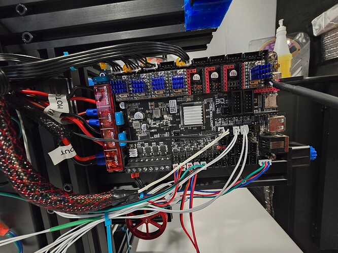

I did however find my y motor fan was shorting. Maybe this was the case?

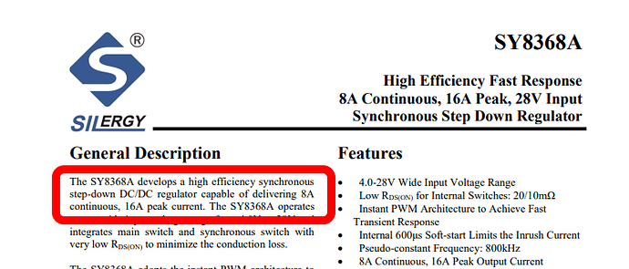

It will work - I use that approach on one of my printers (the others are all running with Manta boards).
The 5V Buck supply on the Octopus can more than handle the 2.5A draw of the Raspberry Pi as well as manage everything else.
What gauge wire did you run from the Octopus to the Raspberry Pi - if youâre too small a gauge then you wonât be able to pass enough current through it. You should be using at least 20 AWG with 18 AWG being optimal.
I see your sending the images - however, I would like to see a schematic showing how the power supplies are wired in.
Can you explain in more detail? If itâs taking out the 24V line, even for an instant, than that could be your problem.
Im using 22awg shielded here.
Thatâs not enough for the current required by the Raspberry Pi.

I will stay external for now then for power, but that fan was literally just hard shorting the solders joints came free from moving it around too much. But i will see if i have any thicker wire.

Just looking at the picture you sent, it ainât that big or heavy.
