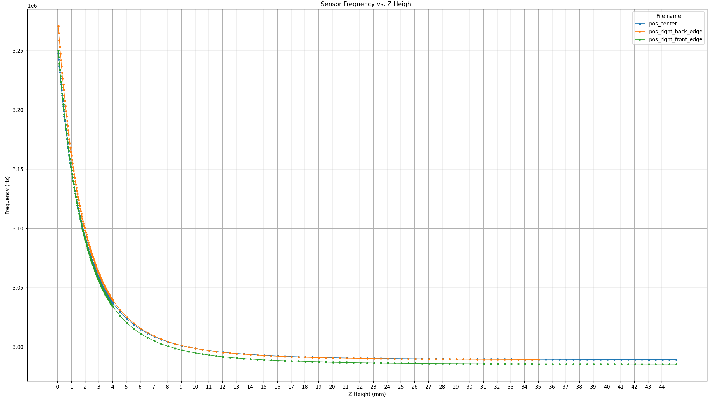

Let’s look at some real data, from real BTT Eddy sensors:
The points are the data from the PROBE_EDDY_CURRENT_CALIBRATE, calibration was patched to get more points past 4 mm.
The more the frequency distance between Z points, the better and more stable the resolution we have. Simply because of finite resolution and frequency, it should give a better signal-to-noise ratio overall.
2 lines are from one user with the Naked Eddy board.
They are important because they are as close as it can get to what it should be.
Our default 4 mm is mapped over the sensitive region of the asymptotic function.
You can see the datapoints with the naked eye and count them, even guess the frequency difference. The sensor does the same. It can easily measure the large difference in frequency even if it is noisy, not stable .
If there is a temperature drift of the coil, the drift is ppm/K, or simply speaking -10 Hz/K (just a random number to show the idea).
For the steep part of the data, it is less a great deal, there are thousands of hertz range between points 0.04mm and 0.08mm.
But if we place the sensor too far away, the data goes to the more flattish region.
(Look at the signal form of the other lines). This exact drift would cause a major shift in the output frequency. Simply because now we have … hundred or two of hertz?
You can try to plot your data with the script from the carto topic.
So, simply speaking from a resolution perspective, purple and red lines are as good as Eddy can get. Orange is better than the green and blue (steeper), and green and blue should perform mostly the same.
(Again, we really care about delta frequency/ delta distance).

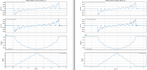

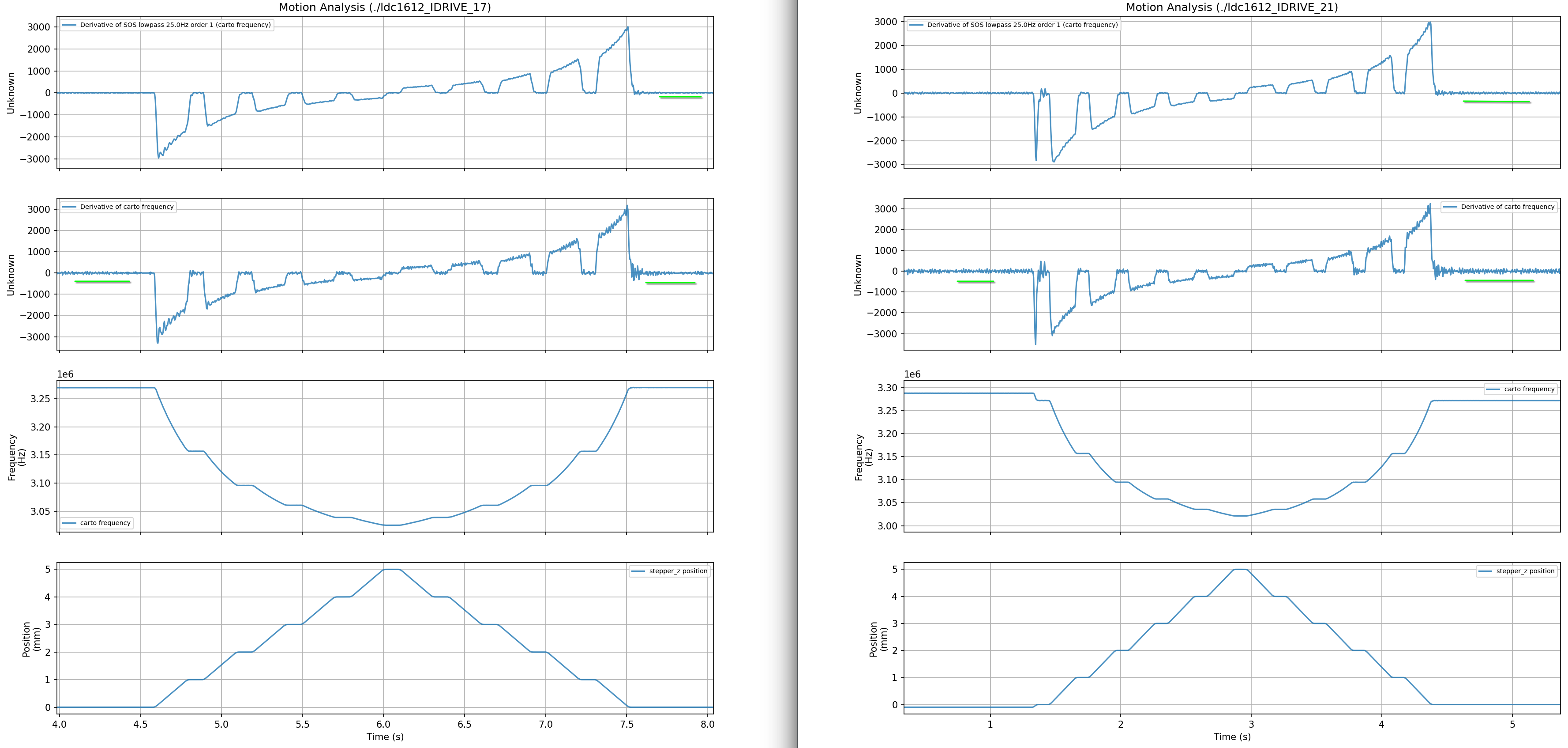

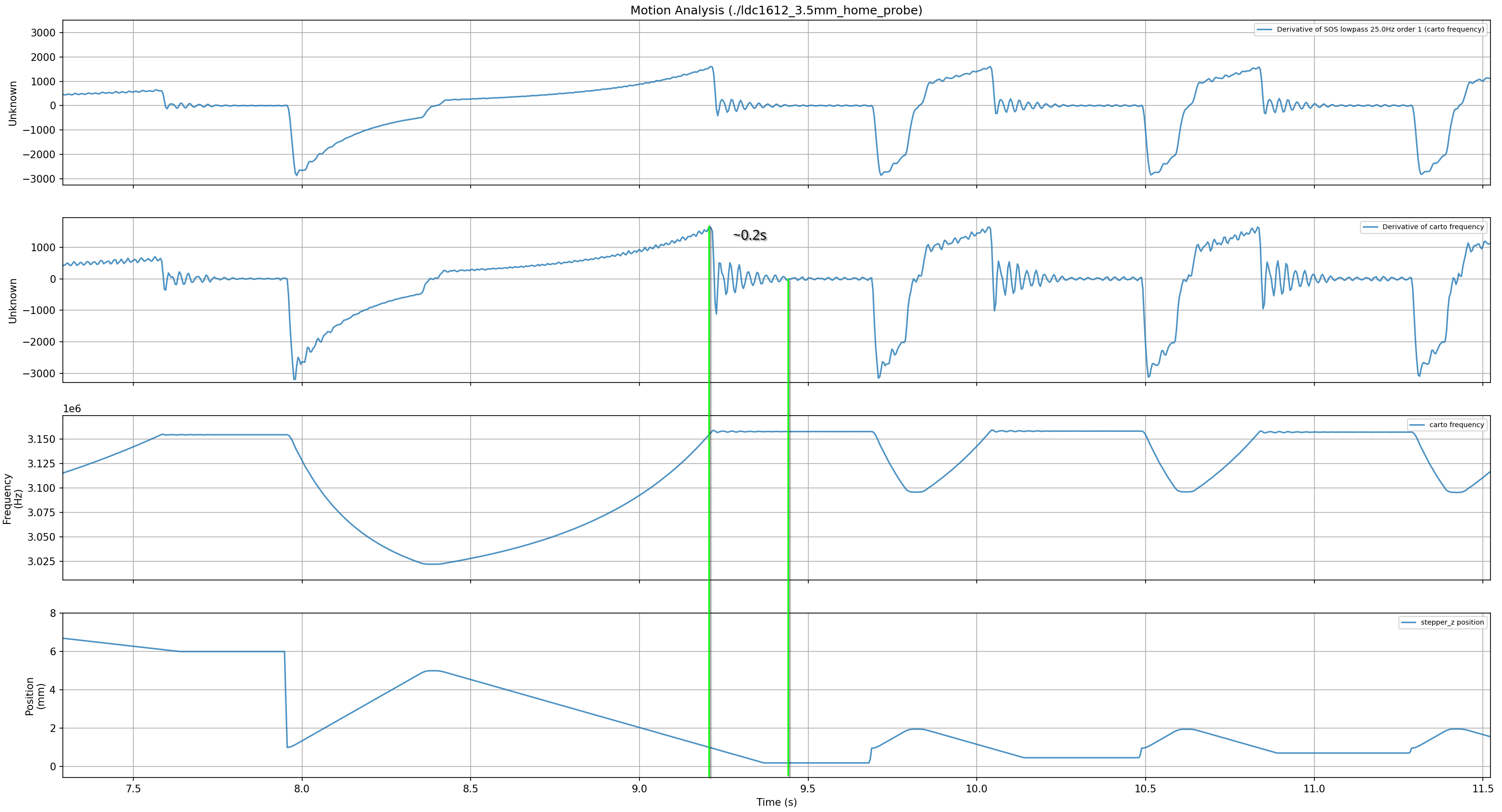

Let’s take a look at the homing data from the people above:
(They are both pretty noisy).
  1. Derivative of frequency (delta frequency over delta time, but time = 1) over filtered data.
  2. Derivative of frequency over raw frequency data.
  3. Raw frequency data.
  4. Z distance
Derivative is used here for demonstration, to make frequency spikes much more obvious.
There are spikes around the start/end of the motion, but generally, there is one from the supergun (~2mm), where the sensor is a little bit closer, a little bit less noisy than the right one, where the sensor has a higher distance (~3mm + 1mm of eddy plastic case, I guess).
Even before and after the filtering.
There is a branch with the MCU side SOS filter for homing: https://github.com/nefelim4ag/klipper/tree/ldc1612-homing-sos-filter
It should just work, and require MCU flashing to get it to work. To revert, you can revert only the host side, it should affect nothing without host initialization.

Then there is the probe offset. We request data from the LDC1612 at 250Hz.
Then there is the I2C speed.
So, I can estimate the lag for I2C: 5 * 2 * 9 / 400_000 = 0.000225 s
And for the homing move: 1 / 250 = 0.004 s
So, total lag would be: 0.004225 s
2 mm/s * 0.004225 = 0.008 mm
5 mm/s * 0.004225 = 0.021 mm
10 mm/s * 0.004225 = 0.042 mm
And for me, this is close to what I experience, not precise, but pretty close.
(I guess there is a moving bed, which distorts signals a little, and also sample time inconsistencies between runs, we can guarantee that sample N always happens at position/time p/t).
If you do have the stable frequency output and more or less stable homing, you can easily verify it by adjusting:
[stepper_z]
homing_speed: 10
second_homing_speed: 2
Second homing speed gives me:
// probe accuracy results: maximum 3.019506, minimum 3.018543, range 0.000963, average 3.018949, median 3.018928, standard deviation 0.000292
So, there is a 0.02mm difference between the homing and the probe.
If I try to decrease the homing speed and secondary speed to 4 and 1, it gives me 0.01mm difference.

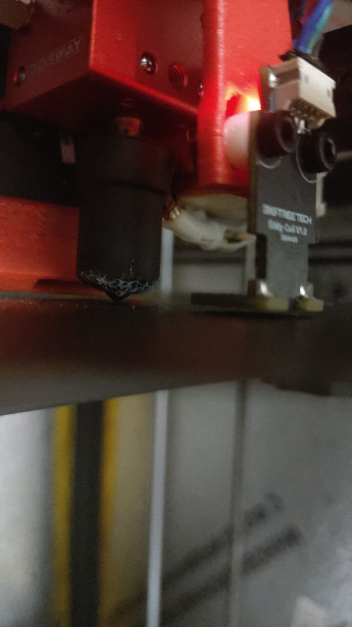

Photo of the eddy rectangle coil 7x14 mm
Ref: https://www.ti.com/lit/an/snoa930c/snoa930c.pdf
Well, it should be close to the nozzle by the Z axis.

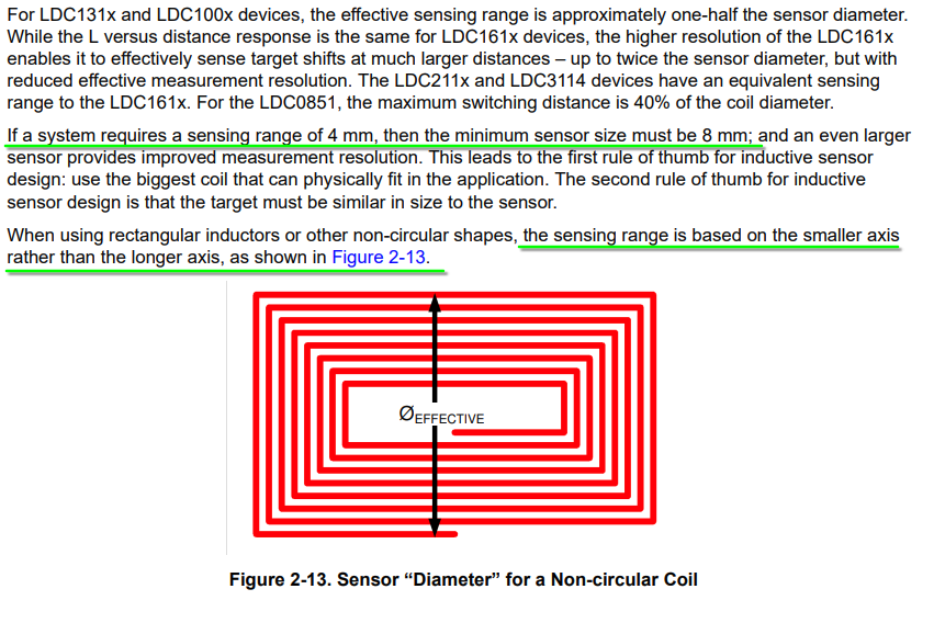

Basic behaviour and form of the signal (Hyperbola/Asymptotic) should be the same regardless of what and where we are talking about. As mentioned, these are not my sensors. So it is done in a way that people configured the toolhead, if that’s a question.
I would assume there should be no difference as long as there is enough metal margin between the edge of the bed and the sensor: https://www.researchgate.net/figure/Magnetic-field-and-eddy-current-distribution-of-planar-coil-based-ECSs-a-Magnetic_fig11_277934353
UPD: https://www.ti.com/lit/ta/ssztbx4/ssztbx4.pdf
Circular coil with a diameter = 29 mm.
And there are little to no differences with target sizes >25mm.
So, technically, we can assume that as long as underneath the whole coil is our metal bed, it should perform in the same way.

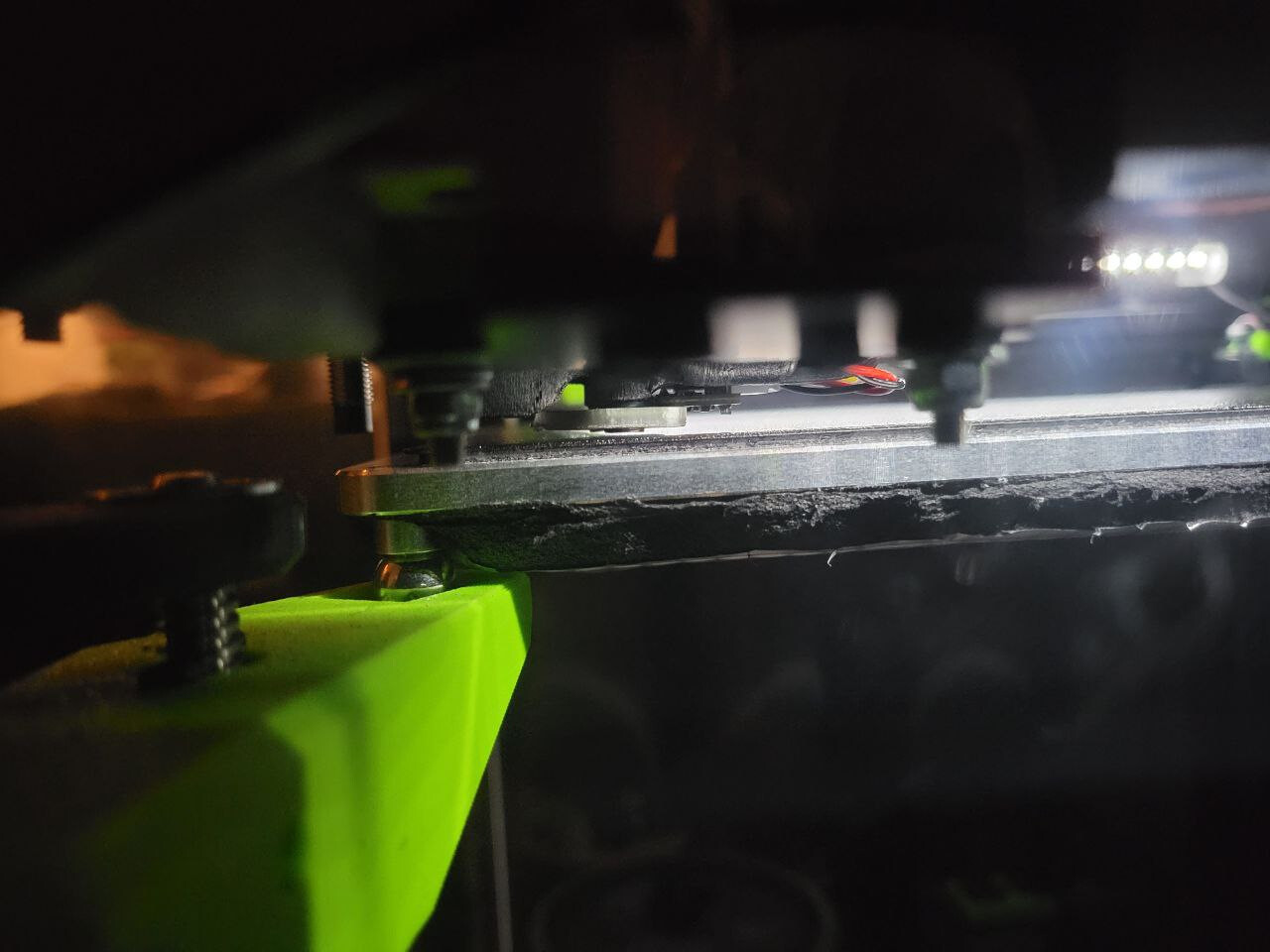

Graph/Photos
Roughly as close as I can get to the edge.
Take into account that the bed is not perfectly flat, and I simply do G0 Z0.
So there would be measurement variations.
From my data above, it seems to me that within an adequate margin (several mm) it should be fine. My back measurements literally touch the back edge of the bed, and I have to repeat it several times with small XY offset adjustments because of collisions with silicon brushes.
If you had one, it would be much simpler to explain.

About height measurements and QGL, yes, it is, as you may have seen in my center/edge graphs, Klipper by default calibrates with steps of 0.04mm, so there is enough resolution to do so.
In my case, there is no difference between my “super pinda” and LDC1612, from Z tilt leveling or bed mesh view.
(but thermal drift is annoying for now).

I invested some time to get an idea about how noise would look with different IDRIVE.
I would say that going lower (-2) than the calibrated value or +1 would not change a lot.
But increasing the current further (that would happen if we disable only the Amplitude high bit).
Seems to increase the noise.
(ODR is 1000Hz, because I forgot to revert it =_=, so it is all slightly noisier than normal)
Graphs
./scripts/motan/motan_graph.py -g '[["derivative(sos(ldc1612(carto),filt,lowpass,1,25),ffreader)"],["derivative(ldc1612(carto),ffreader)"],["ldc1612(carto)"],["stepq(stepper_z)"]]' ./ldc1612_IDRIVE_20 -s 0 -d 6 --segment-time=0.004
I should note that boosting current does increase the overall min/max frequency value a little, but not so much, and by graphs, it seems that noise in the working range 4..0 mm is not so affected by the actual current.
Based on that data, I lean toward simply disabling the amplitude error.
The case where the coil is not oscillating is covered by the watchdog timeout.
Otherwise, I would expect that the calibrated value should perform fine.
I agree, this is just my attempt to get some experience with SOS filters inside the MCU.
I’m not sure right now that I would be able to rework the homing code.
(Small note, because the bed stops abruptly, it seems that the probe averaging code mostly happens within the oscillating region).
Graph
But I somewhat want to try to implement basic tap, and to do so, it seems better to filter the data to stabilize the descending stop of the nozzle.
Hope that information can be useful.

Not remotely on the same level, I came up with a work around to sensor failure messages when eddy gets too hot, as it tends to do running ~2mm from a 100C bed for an extended period, and homing while still hot.
I have the eddy, running naked, sort of embedded into a modified Diii air duct for parts cooling, on the OD, coil flush with bottom of duct in cutout. It gets cooling air whenever the fan is running for better or worse, and is well sheilded from nozzle heat.
I simply set up the printers start gcode to run the cooling fan at ~20% as soon as it starts, and it drags the eddy into a reasonable temp range so I never get the dread sensor failure message. (normally have fan off, printing PPA or PET)
Second minor work around is that when the initial setup is done cold, once warmed up a bit you get an immediate sensor failure… so I do the initial current cal with everything warmed up to ~50C, then at least works for homing hot or cold. Done at LDC_CALIBRATE_DRIVE_CURRENT CHIP=btt_eddy
These are primitive work arounds, but this setup got me a reliable, reasonably consistent probe setup.
Its possible one could achieve come sort of assist in the form of reported temp vs drive current or even use fan speed for primitive temp control from eddy mcu temp feedback using some of your code.
